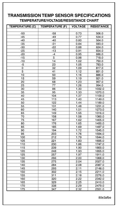

I did find this link to the resistance values of the temp sensor at different temps:
Jaguar Workshop Manuals > XJR (X308) V8-4.0L SC (AJ26) (1998) > Sensors and Switches > Sensors and Switches - Transmission and Drivetrain > Sensors and Switches - A/T > Transmission Temperature Sensor/Switch, A/T > Component Information > Specificati
Looks like a 1k Ohm resistor would fool the computer unless it's looking for something more than just resistance.
