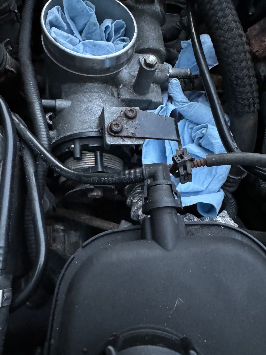

Is this the Fuel Pressure Regulator?(behind the connector)

Yes, the rusty part on your pics is the FPR. A few more pictures (the last one shows the port on the SC cover to which the FPR vacuum hose connects):

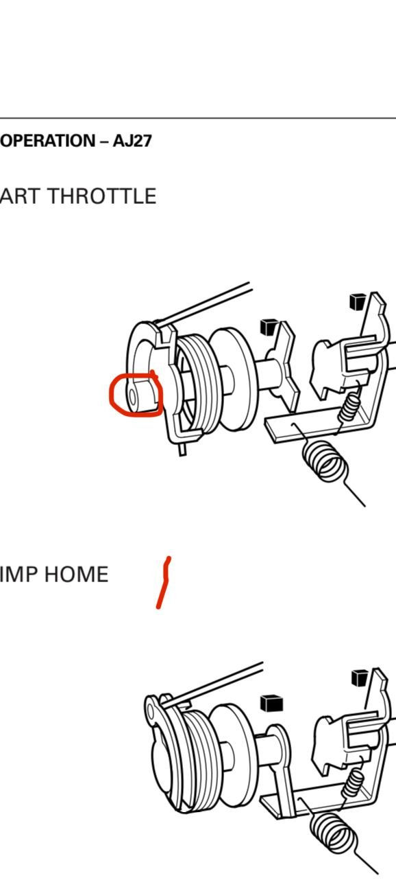

how do i remove the throttle cable? never worked on this style before and ws manual isn’t detailed on that part. do i just remove the screw on the throttle lever? (circled in red)
