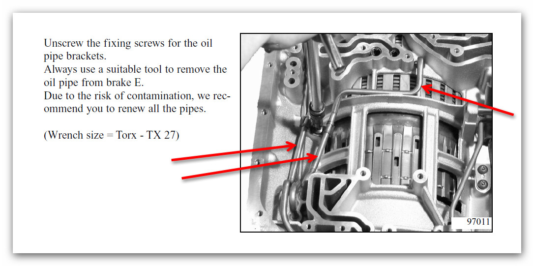

ohh,forgot ,do you know where to get those 3 pipes? and the part number for them?
Have you change them?
Thanks

Try that email. And sorry, what 3 pipes?

see picture.

pipe to the right ,too , my bad pointing the arrow to only the 2 pipes.
thanks

Okay I see now. I did not replace my pipes because there was no contamination. No metal shavings no junk floating in the oil.
What is wrong with your transmission?
