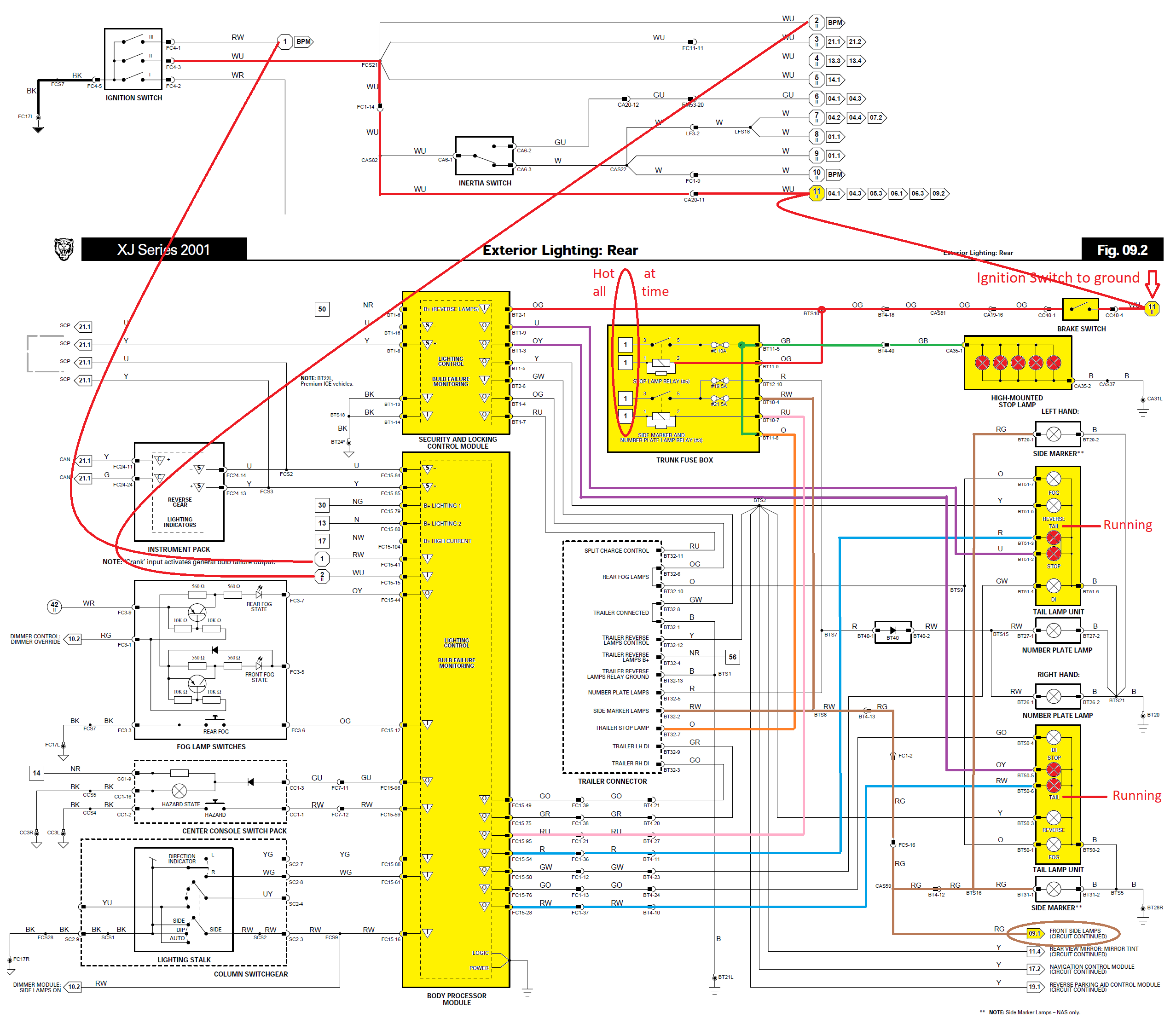

I think there was a superseding part # as to which is correct I don't know . Below is a TSB covering the superseding switch : See page 6 for part #
http://www.jagrepair.com/images/TSB/XJ/206-07%20AM3.pdf
Attached Thumbnails 98 VDP; part confirmation please-x308-brakes-4-untitled.png   98 VDP; part confirmation please-x308-tail-lights-untitled.png

9under1roof - the link you've posted is a microswitch for the trunk lid
Penelope's pic is correct
