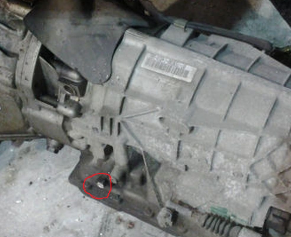

I have the chance of a second hand gearbox ( for my XK8 1999 coupe ) for a reasonable price, but have to travel quite a way to collect it. I have been told it is a low mileage box, under 40k miles but the pic shows where a part has been snapped off, I think it is where the oil cooler pipe fits, can someone confirm that is correct please or advise what part fits here ( red ring )? I am hedging my bets buying this box as I am not sure the oil change on purchase will cure the bumping and fault experienced on my car. This is a XJ8 box and I believe it is O.K to use in a XK8, the oil has been checked and is a red/brown colour.
If the above is correct just for peace of mind I will buy the box and take a chance on it, any comments much appreciated.

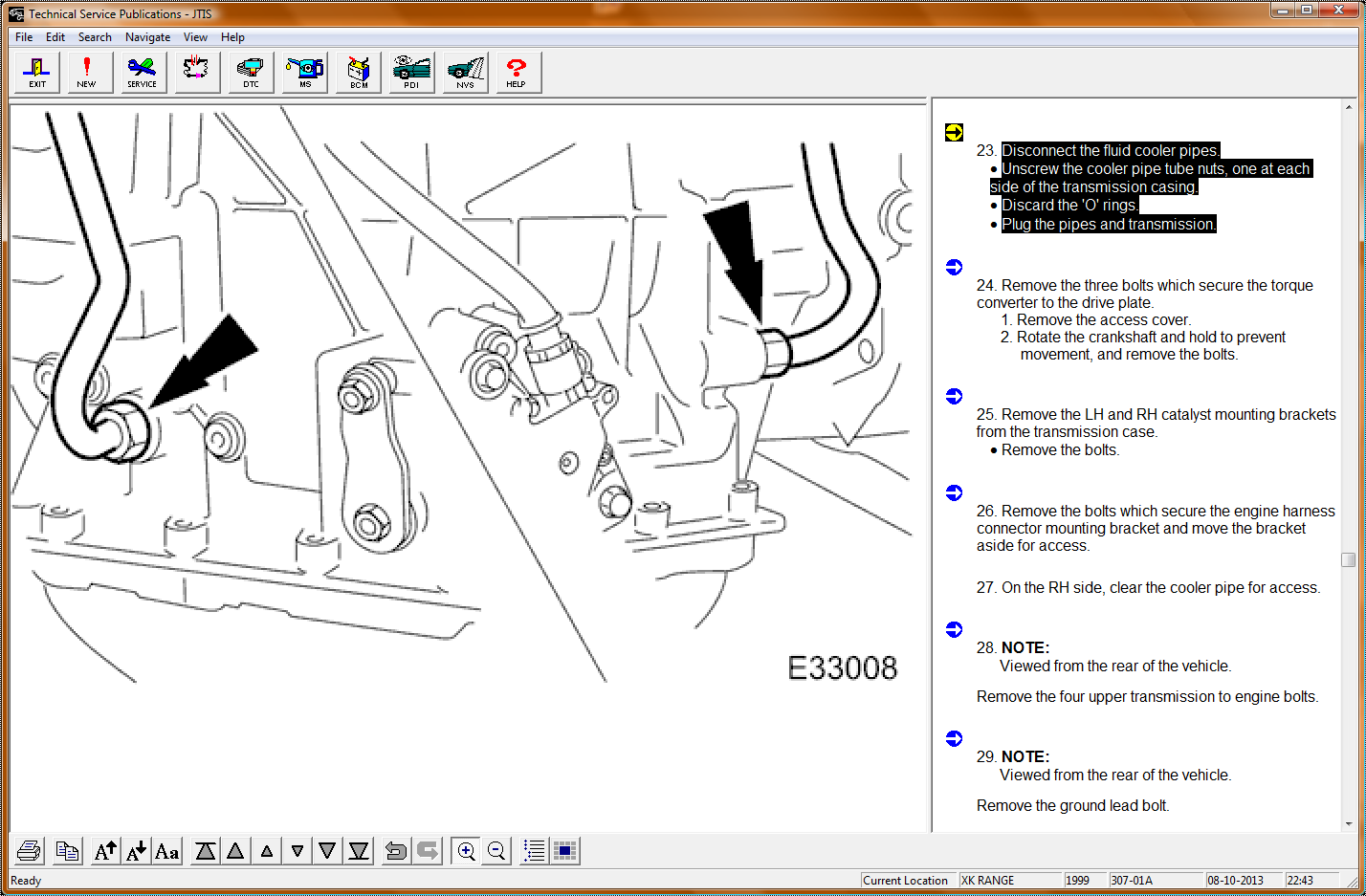

From the drawing in the JTIS you appear to be correct.

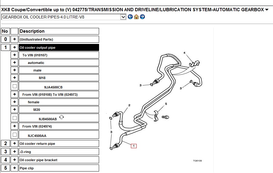

It's the fluid from Transmission to Oil Cooler pipe outlet (item 1):
A carefully removed transmission would have the outlet and return pipes plugged.

At clyons and Graham, thanks for the confirmation,looks good.
Cheers,
ArtyH
