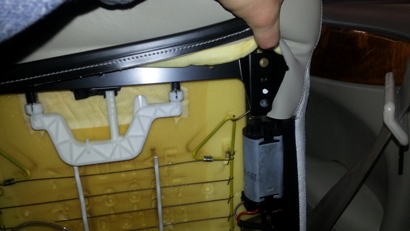

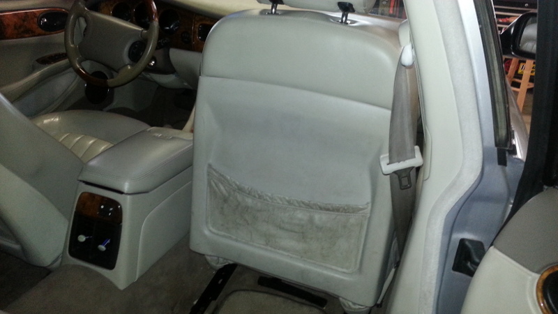

Move the seat all the way forward
Remove two screws at the bottom of the seat back
Pull the bottom outward slightly to release the clips

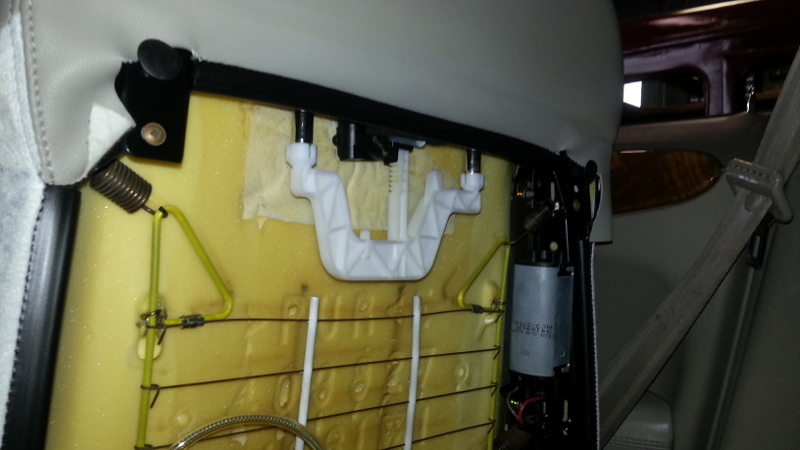

The exposed seat. We need to remove a couple things to make the new ones sit properly as non VDP cars have extra padding and support up top. Also, if your motorized headrests aren't working (as my drivers one wasn't) its probably because the chrome rods have popped out of the white plastic piece in the center of the picture.
Take out 4 screws that the tray tables will screw into, i have a portion lifted up do you can see the upper ones
There are 2 hidden screws way up top that hold a support bar and are just in compressed pulp board, I fought getting these screws out properly on the drivers side but for the passengers i decided I would just tear the board then work the screws out by hand. Much faster, but if you plan on returning to stock at some point then this wouldn't be an option.
You can take out some foam or just leave it, as it will now compress enough for the VDP backs.

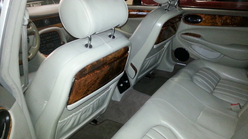

Place the new VDP backs on and locate one of the screw holes with the tray table holes. Once you do, put a screw in the to hold the seat back.

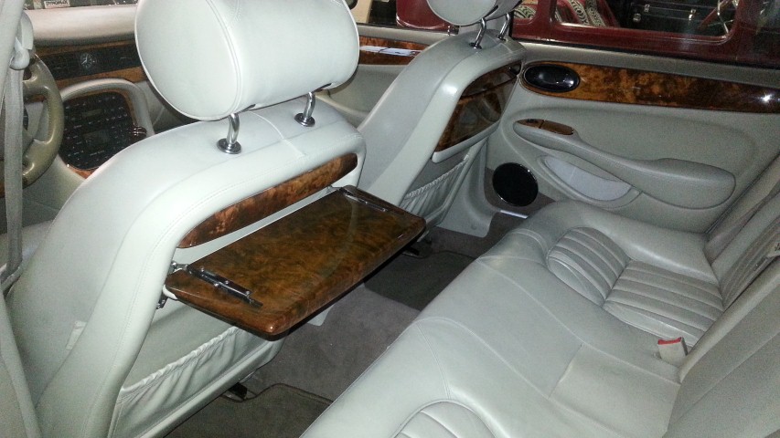

Now put one screw in one side of the tray tables, this will keep the seatback located
Screw in the remaining screws
and enjoy!
I did not get the seat controls for the passenger seat, when I get those I will update this thread.
