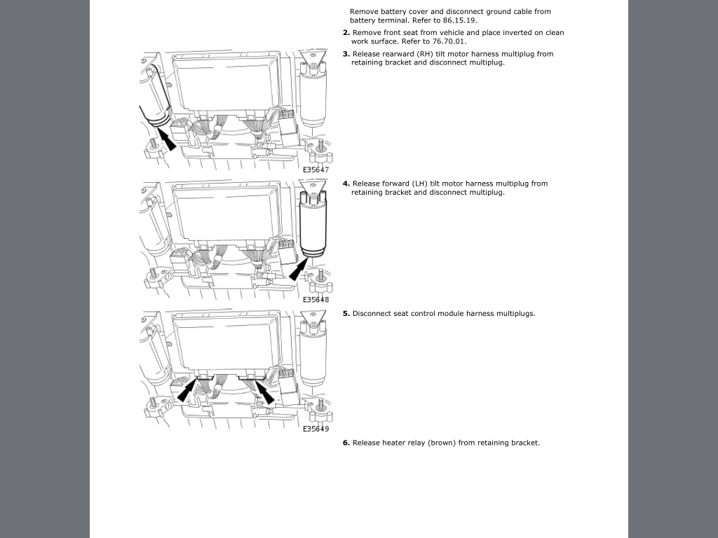

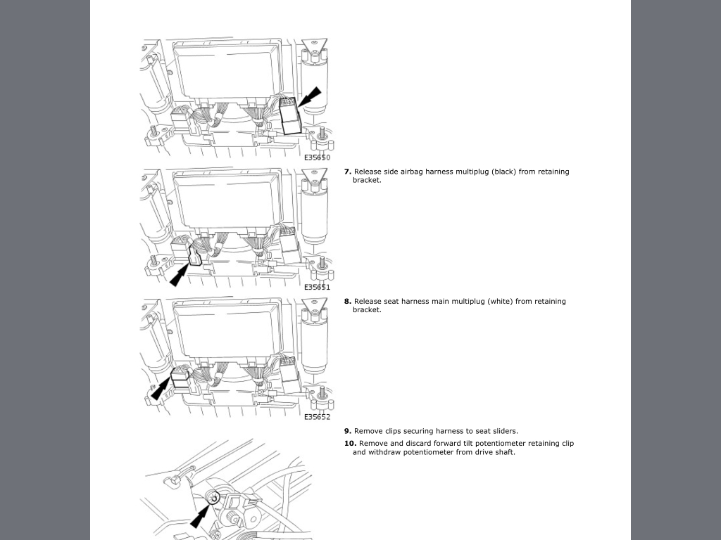

I've been paging through the PDF versions of the workshop manual and the electrical guide just to learn more about the wiring under the seat. The workshop manual has several illustrations showing how to remove the drivers seat, and some of them identify the various connectors. Here's one (in 2 parts!). Just thought this might be of interest to those who are thinking about removing the seat.

LEAR45 -- Since I don't have any problems with my steering wheel controls, would it be safe to bet that it's NOT my clockspring? And, yes I believe you are right about the SRS connectors being yellow, but in my case I think I have an "extra" yellow connector on the side of the control unit under the driver's seat -- can't find any explanation for it in the electrical guide or the workshop manual.
