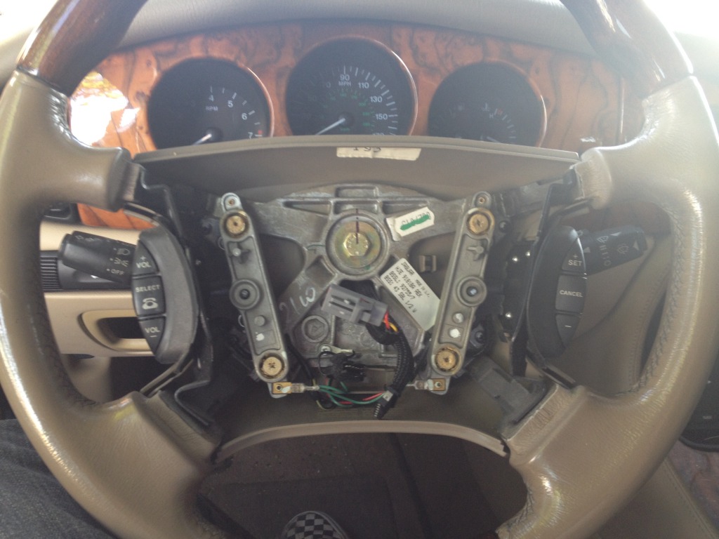

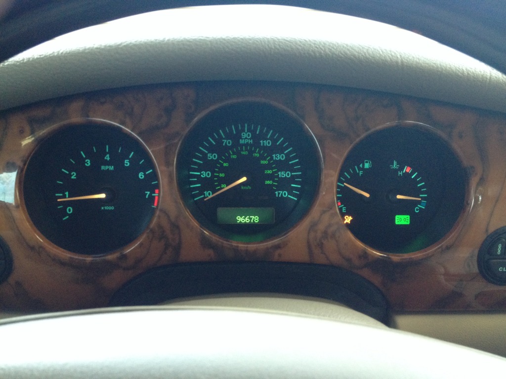

Hi there,
I am trying to fix an airbag light, that's been on for couple if months. I don't have any codes:
I went for a new clock spring, since most times that seems to be the problem. I got a used one from EBay, just because I wasn't sure, than that's the problem ( since no code on - I think it was code 19?).
The instalation went really smooth, but the light didn't go off - it's just the same as before!
I wondered what else could it be - maybe new airbag?
Any ideas will be greatly appreciated!

So I decided to go for the least expensive fix - I bought a used clock spring from EBay for $23!
I followed the instructions from the forum, and everything went well - actually easier than I thought. It took me several attempts to center the steering wheel. The airbag light is gone now!
