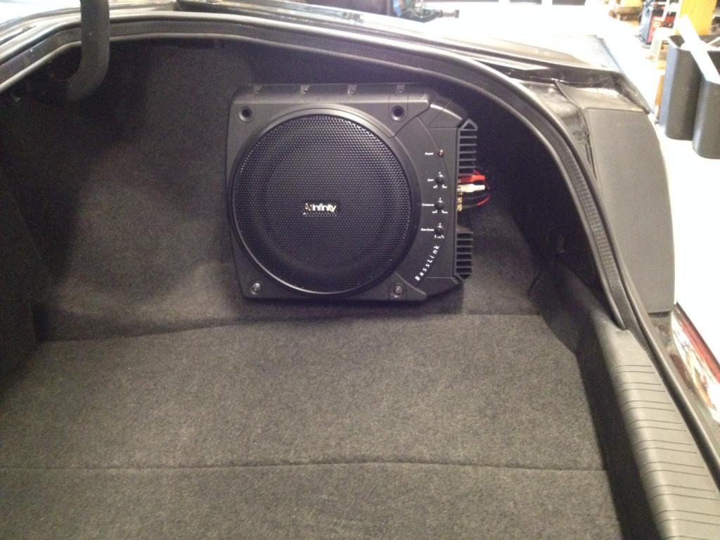

Thought I would share what I did with my XJ8 I just got a couple months ago:
I soon realized that the original subwoofer on the rear deck was out of commission. (perished foam surround upon further inspection.) So I decided to install a powered Infinity Basslink sub I'd taken out of another car a few years ago.
With the use of a Line-Out Converter (with remote amp turn-on signal), all the wiring takes place in the trunk. My car has the trunk mounted factory amp, so it was just a matter of splicing the line-in signal for the LOC from one of the speaker wires coming out of the factory amp.
I am far from any sort of serious audiophile, but the sub works great as far as I'm concerned. Eventhough there is no direct porting from the trunk into the cabin, there is more than enough bass that can be heard and felt. I think I read somewhere once that, in this type of installation, the entire trunk cavity becomes a sealed enclosure, and somehow resonates the sound waves through the car structure?
LOC that I used:
Amazon.com: PAC SOEM-T 2-Channel Premium Line-Out Converter with Remote Turn-On Trigger: Automotive Amazon.com: PAC SOEM-T 2-Channel Premium Line-Out Converter with Remote Turn-On Trigger: Automotive

Attached Thumbnails Amp/sub install wfactory stereo (XJ8)-amp.jpg   Amp/sub install wfactory stereo (XJ8)-0030a702-44f3-4358-84ba-6c70fd3d304d.jpg
