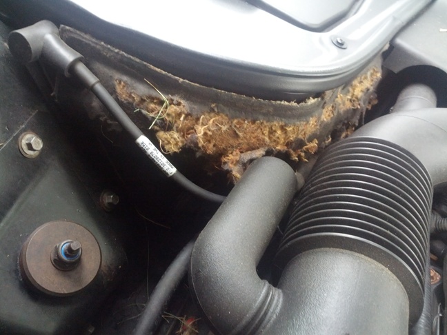

What do you guys/girls do to prevent animals from getting into your car?
This past Canada day long weekend I took my 8 up north and left my Jag sitting on the driveway for 4 days untouched. In that time an animal seemed to crawl under my hood to build a nest. The animal chewed through my hood insulation and all of the sound insulation along the firewall. I changed the supercharger oil on the Jag on last Thursday so I know there was nothing under the hood then, drove it last Friday and parked it for the weekend. Tuesday, I drove the car and noticed that I had a bit of a whistle and more engine noise from under the hood and this is what I found. Fortunately this is only 4 days of damage and it does not look like the critter had chewed through any wires or hoses.
Attached Thumbnails Animal trouble-img_20130703_102447.jpg   Animal trouble-img_20130703_102459.jpg   Animal trouble-img_20130703_102513.jpg   Animal trouble-img_20130703_102522.jpg   Animal trouble-img_20130703_102528.jpg

I had a similar incident with squirrels on my XKR while it was sitting outside for a few days. They damaged the same firewall insulation (but not my hood insulation).
I was able to quickly repair it in-situ so it is almost undetectable. Remove all the loose stuffing. Cut some fiberglass house insulation to fit the the remaining gap. Then use a scrap of thin black fabric to recover the entire insulation panel (at least all you can reach without disassembly) by adhering it with spray headliner adhesive, Trim with a sharp knife as needed.
