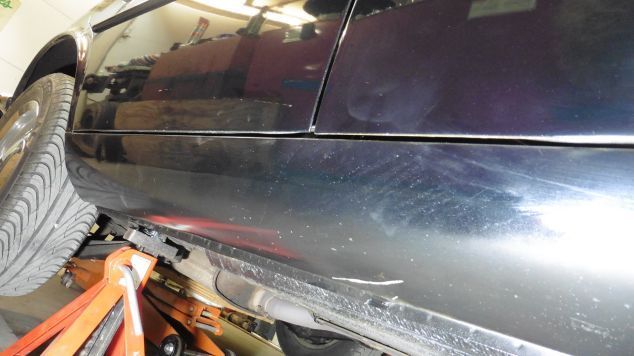

When I got back here I just Had to know the damage. Certainly there Was damage, but what. So, after only a couple days with her feet on the ground, we jacked her up Again, and I crawled under for a thorough inspection.

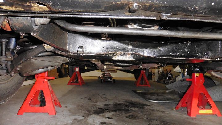

The first thing I noticed was the right front jacking point has been hit HARD, knocking it a bit out of line and knocking all the undercoat and paint off. But it was still there and solid! Looking under the front however, was a different story.
Whatever it was not only flattened the cross member but wrinkled it!
It's straight across the back so all the suspension parts will be unaffected but it's a good thing the motor mounts are new or the engine might have broken loose at least sending the fan through the radiator.

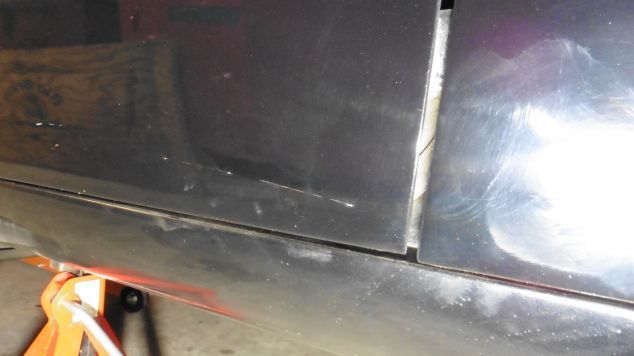

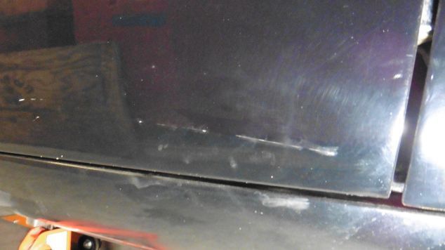

After hitting the cross member whatever it was, slid along the right side of the car, digging a gouge and various scratches in the right rocker panel at about the B-pillar, then jumped up and scuffed the right front door and scratched the rear door chipping off the clear coat.
It missed Everything vital! >WHEW!!<
I can put some black nail polish on that gouge, it's under where no one will see it anyway except under exact circumstances. I can also dab some polish on the scratches on the door. *Hopefully* Meguiar's will eventually fill that scuff and it will be a lot less noticeable.

That's really, really bad luck Elinor. As you say though, could have been worse.
I've been very wary of laden trucks and trailers ever since getting a shredded (Michelin 4X4) tyre when some fool lost his overloaded junk - no where to go except run over it. No, I didn't get his plate either!
Anyway, no doubt you will overcome. On your third pic the door appears slightly dented, but obviously it's a trick of the light. Hope you get a good finish back with Mr. Meguiar's help.

That could have ugly in lots of ways. That cross member took quite hit , great luck that the debris didnt go on to get tangled up with anything else. Hopefully its just cosmetic and can wait for the next big round of work for attention.
Old Sep 28, 2015 | 04:05 AM
Posts: 28,832
Likes: 11,289
BUGGA.
That cross member is one tough hunk of steel.
I would get a BIG shifter, and clamp the jaws onto the raised up bit, and bend it back where it belongs, then a quick squirt of paint, all done.

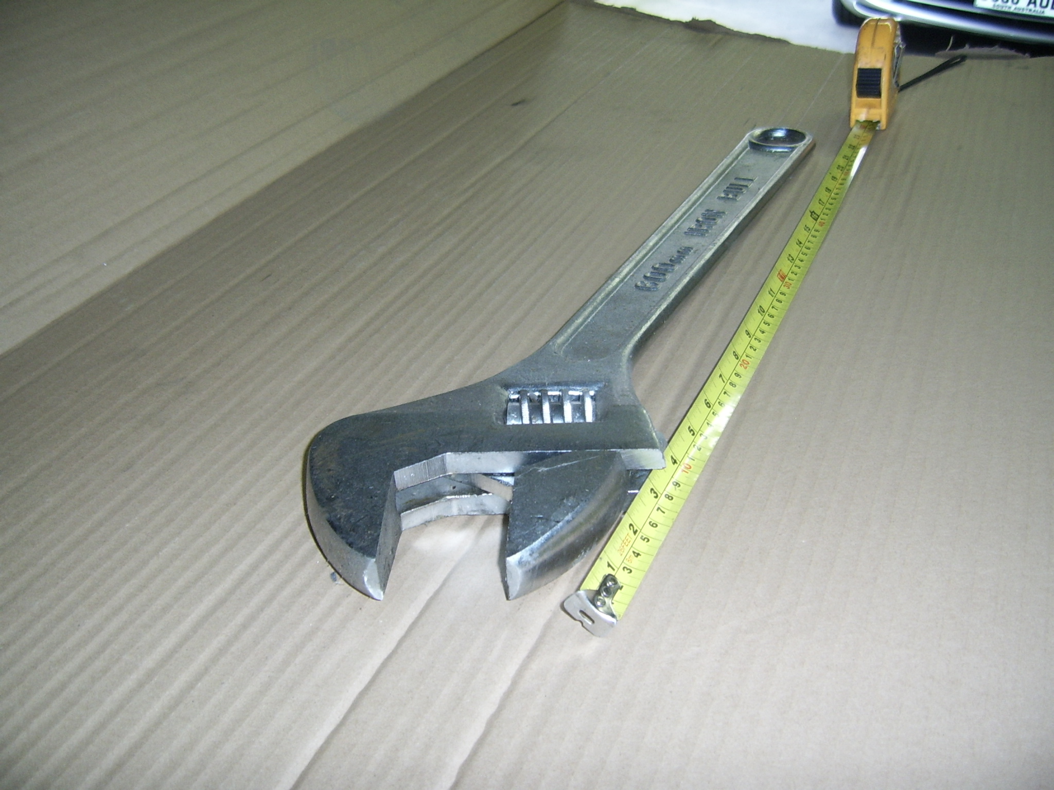

This is a shifter.
This is the one I use when replacing the output shaft seals/bearings on the inboard brake cars.
It is HEAVY.
Rotate the knurled thingy and the jaws open and close to your hearts desire.
This one is 23" long.
I have a 36" one also, but for some reason I cant find it in the shed, kids??.
