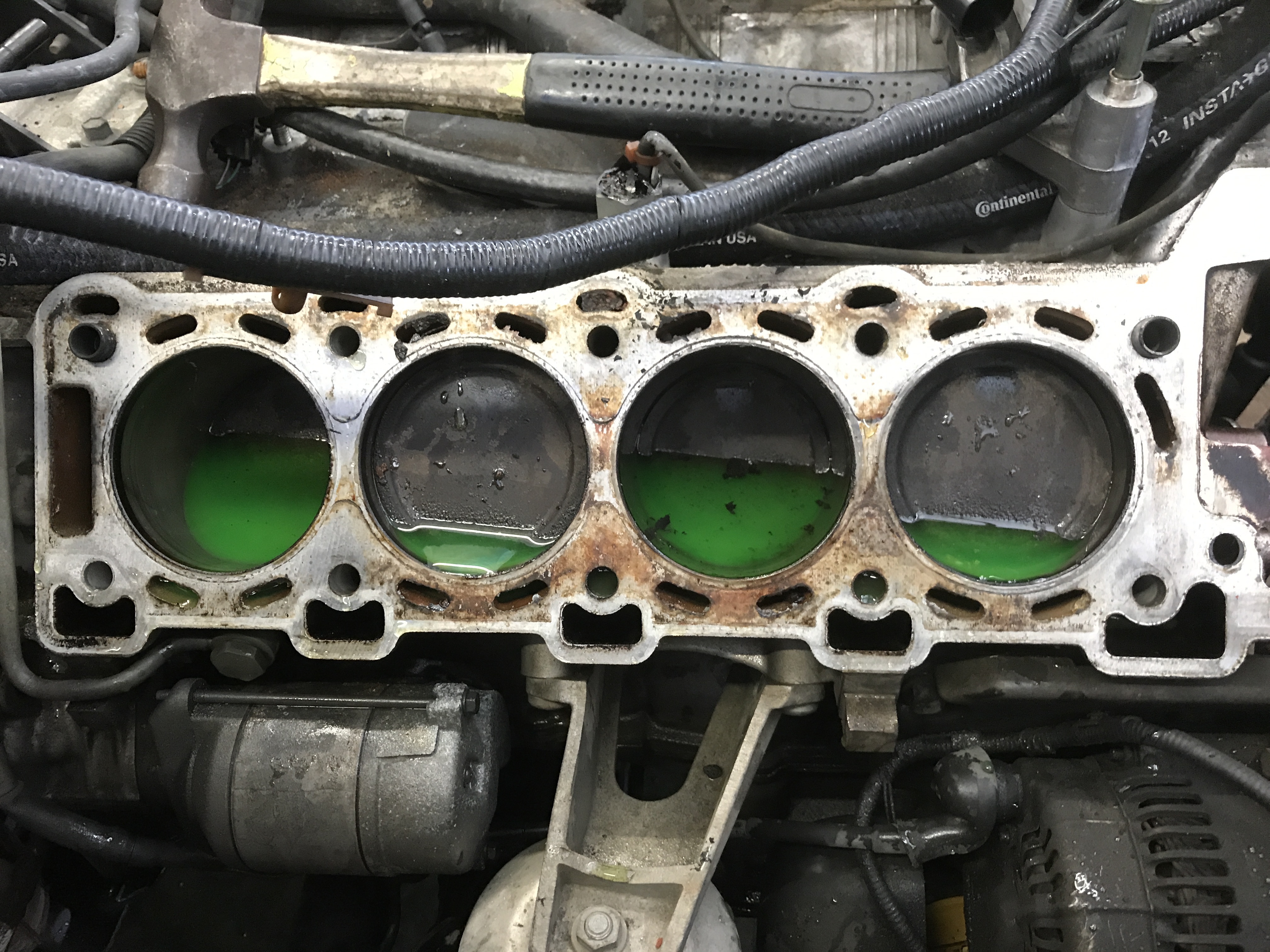

I am removing the heads next week, but so far we have done the following test:
Compression test cold engine: Result a healthy 150psi per cylinder
Chemical test on the cooling system: The fluid stays blue (no gases)
Pressure tested the cooling system: holds 15 psi steady.
Connected the cooling system gage and started the engine: pressure stayed around 9-10 psi. Took the car for a short drive with the gauge on, pressure quickly increase to 15-16psi and has to stop the car.
I tried a head gasket sealer to see if there was some improvement, and it made no difference.
The car does not smoke thru the tail pipe
The coolant has no sign of oil
The oil has no sign of coolant
There are no codes on the ECM
Both fans are working (high and low speed).
I ordered the head gaskets, but it does not make any sense.

As of now, I am waiting on the parts to start disassembly. Unless someone has another test (that I can pass!) and still have a head gasket problem.
Looks like the heads are probably warped which is to be expected after overheating. More than likely it's an internal crack in the heads since they usually warp after overheating, then blow the head gasket between cylinders or wherever the weak point of the gasket is.
