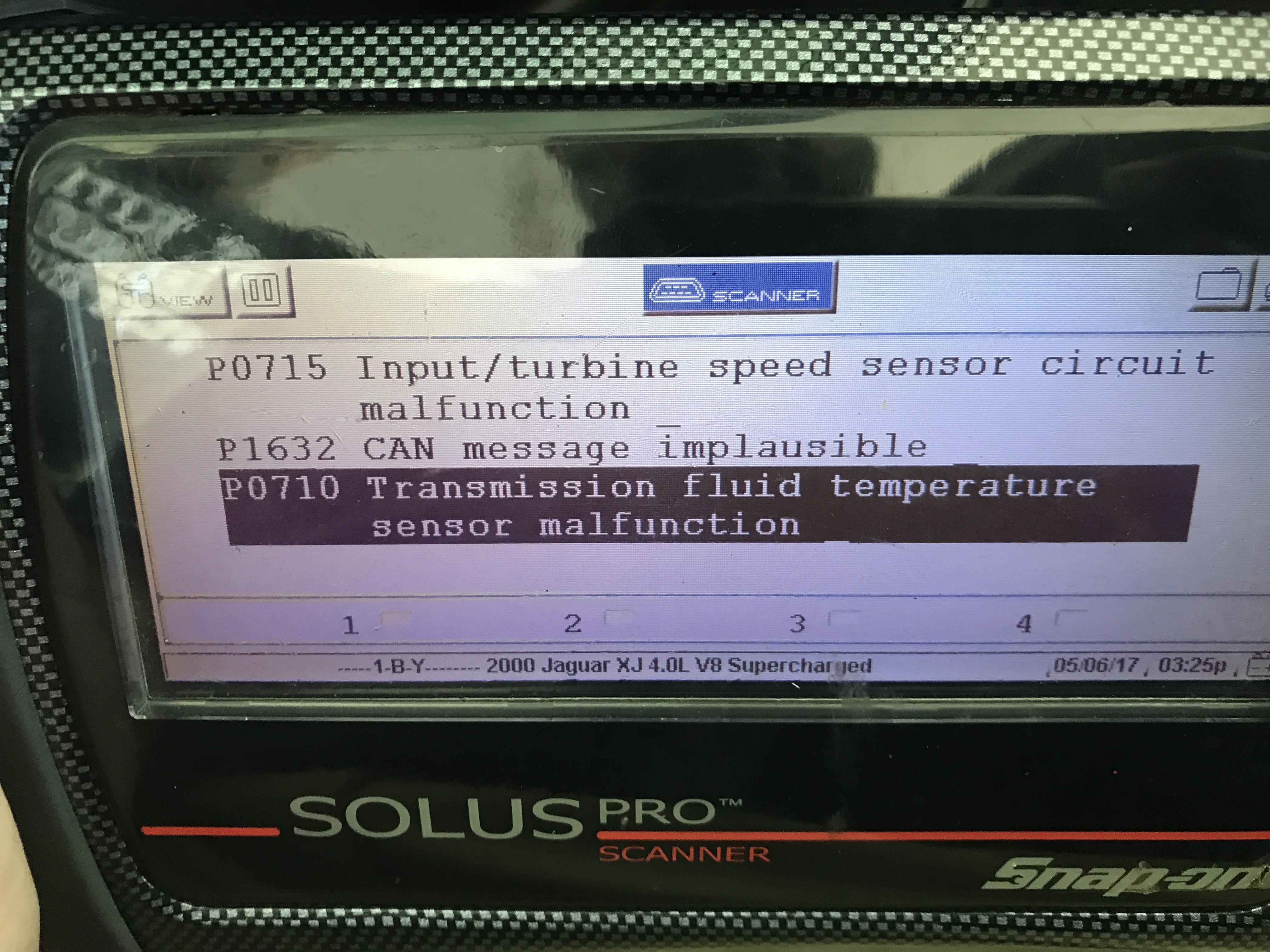

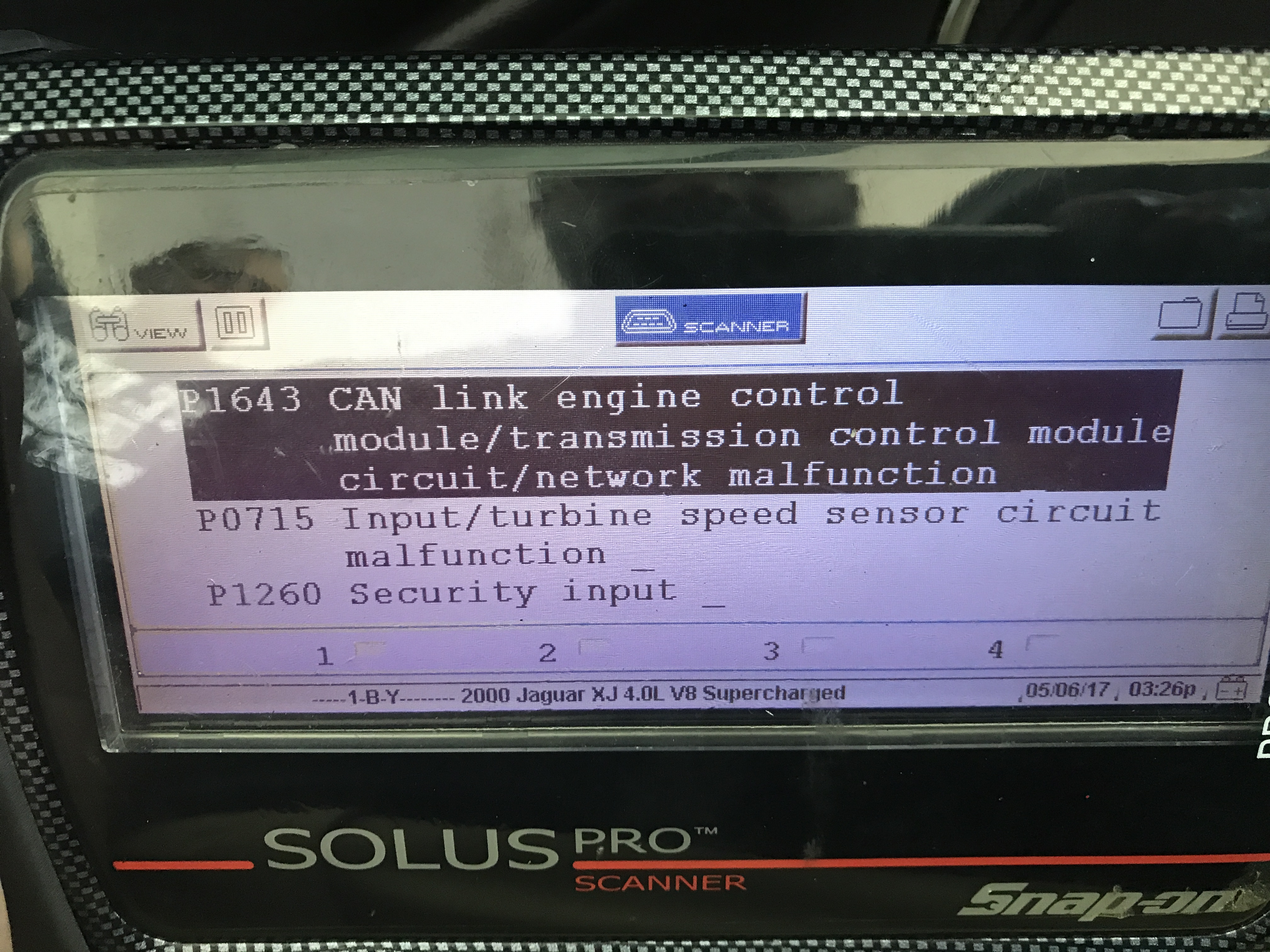

Old May 14, 2017 | 10:49 AM
Ivanuf's Avatar
Joined: May 2017
Posts: 30
From: Puerto Rico
These were the only codes.
The transmision related codes are no more since I replaced
The conector plate on top of the valve body of the transmision.
Attached Thumbnails Another Overheated XJR-img_4335.jpg   Another Overheated XJR-img_4336.jpg

Broken water pump blades?
Those codes look serious BTW.
