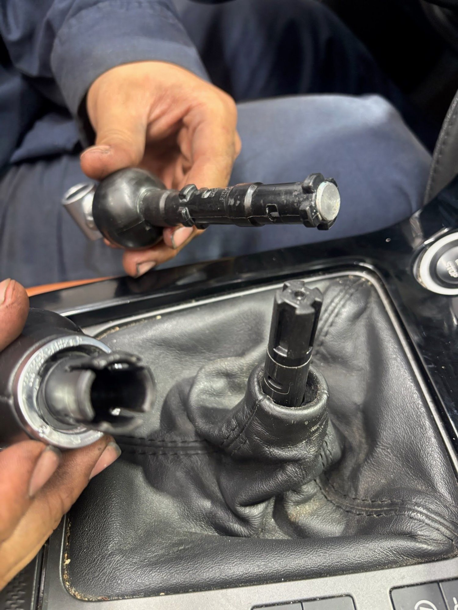

I found my old short shifter that I'd not realized I uninstalled from my 2016 when Jag got me my 2019, and was going to install it.
I think everything is the same? BUT... the threaded shifter from 2016 seems to have gone to a press and fit style of attachment mechanism, and lo and behold...
I won't be able to get the knob back on.
I'm only asking because I want to make sure that nothing else changed, and installing it means I simply need a new "old" knob for the shifter? But of course everything else will be fine.

I think that's all correct. The 2016 did not have a threaded knob. As I recall, the piece in the shift boot goes onto the piece in your left hand, than the knob goes on top of it all.
EDIT: Do you have the instruction sheet that came with the U-shifter?

One of us is confused and I'm pretty sure it's you.
The shift knob you're showing is just like that from my 2016, and matches the 2017 version that Valerie has. I know of none that have a threaded knob and if memory serves, I checked that before sending my spare to Valerie that there is only one type.

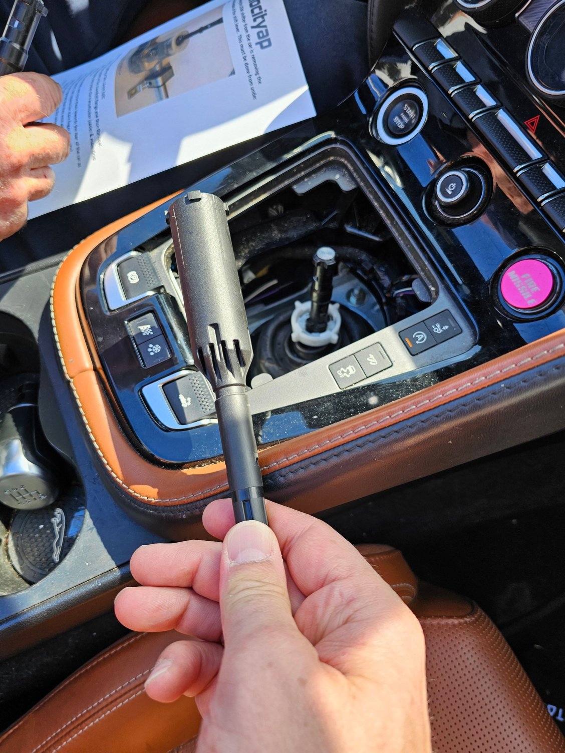

Which instructions do you have? In your picture, the piece in your left hand is only visible once you remove the shift boot and the upper part of the shaft (the piece sticking up through the shifter boot).
It's the lower shaft that is a bit of a pain to install. I changed it by myself in the driveway, with the car on stands. A lift would help (more height). An extra set of hands would help for the one tricky bolt, which is reportedly not tricky if you drop the exhaust. Am I cheap to have insisted on doing it myself? Maybe stubborn? Honestly, mostly the latter. I can still say that all modifications were done by me (excluding the torsen; tip o' the hat to @Onca Engineering for that), although I still use the dealer for maintenance. That's probably due to also being lazy.

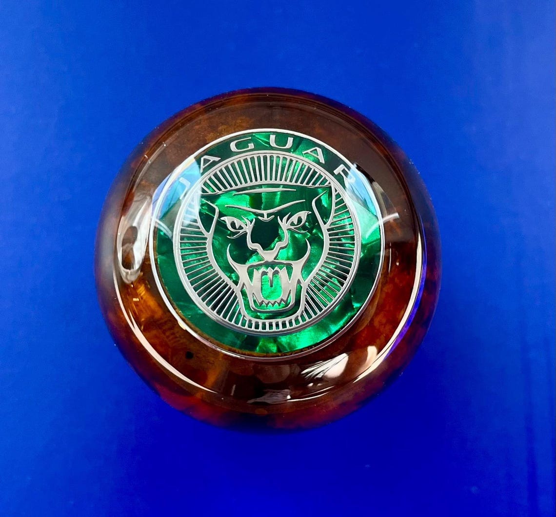

To round this out, I'd love to get this guy to craft me something:
https://www.etsy.com/listing/7262765...ear-shift-knob
Jaguar wood gear shift knob with die cut inlay and pearl background emblem
In the meantime, this replaces part T2R20055, and should look fine in black with grey lettering

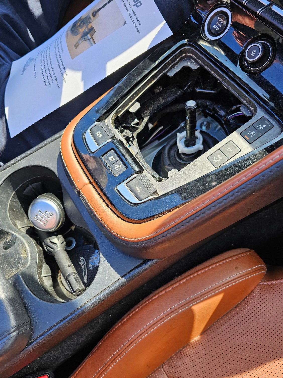

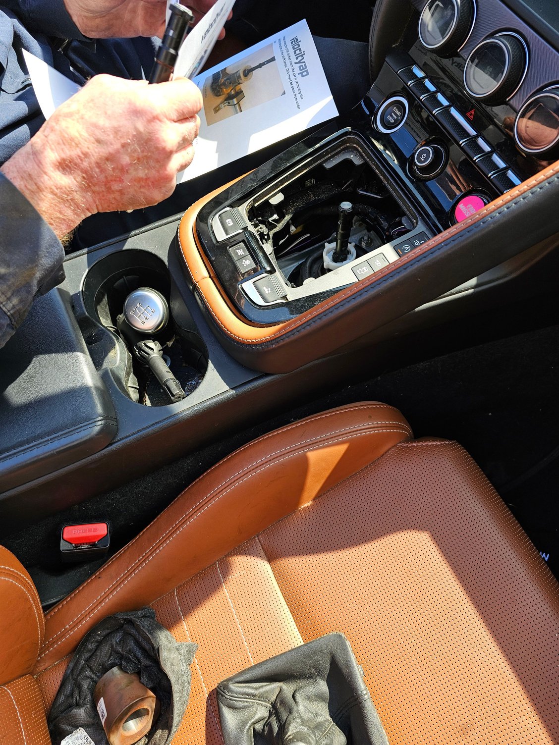

I am no mechanic. But I am also not wise in the way of much of any of this, so I own the confusion, but WAIT A MINUTE... wtah...
So I'm not doing this, a patient and fun mechanic is doing this. old british sports car repair, his hold music is Speed Racer. 3 Generations of fam.
So, he pulls everything. Then, he pulls a cover off the shifter. I am SO CONFUSED. REMEMBER I AM CONFUSED AND OKAY WITH THAT... but what?
Did I buy a second short shifter? My confused brain is that I am looking at a dealer installed short shifter on my 2019 prior to taking receipt, and they put on an extender to put on the modern knob?
I know I *DID NOT* buy a second short shifter. But that's what it looks like... looks like I am looking at the IDENTICAL short shifter?
So, like the end of Clue:
Max (and other strangeness): Very Well....I know who did it. (Clue, 1985)
So, post 2016 model Volvo flywheel and clutch, and Jaguar machining a proper spec OEM Jaguar F-Type flywheel and clutch, they altered the shifter shaft to be a shorter throw...
And then put an extender over it, resulting in it being the same throw as 2016???
So, in the end, I didn't need to pull the extender off at all, but just put this new ball that will sit lower on the stalk... so my short shifter is in there from Jaguar, having made OEM changes to the stalk...
and now I've an aftermarket short shifter I can sell?
Again, hand hold my confusion?
I was in disbelief OR CONFUSED... so you can see the UNHINGD short shifter in his hand, the installed shifter without the extender, and the extender in the cup holder or in my hand. LOL What?

To the best of my knowledge, no. All 6MT models had the same shifter components. There are three main pieces:
  • The knob. No mystery here. It's a knob.
  • What you are calling the "extender." As I recall, this holds the weight (to give a solid feel). There is a rubber sleeve between this and the lever to damp vibrations.
  • The lever itself. This is where the "short" happens. The length of the bit below the ball that bolts to the linkage is different than stock. This means that the linkage moves a different amount for a given movement of the knob.
Your confusion should keep its hands to itself. My own confusion has been know to get jealous and feel threatened.
The part below the extender is what you need to swap out. If the top looks exactly like the original it may be that your short shifter was made from an original. Lemme 'splain ...
The original UNHINGED Short Shifter was a group buy, with Lance doing all the considerable legwork and having a batch made. These were machined from billet, but when they were gone, they were gone. My recollection is that the manufacturer was not interested in making more because they would rather make money, and that wasn't happening with such low demand. Lance then did even more legwork and found a local welder who devised a way to modify the original to alter the throw. I'd go get my original from where it might be stored to give measurements, but I donated it so that he'd have stock to ship out, pending return of the original to keep the Circle of (Three Pedal) Life going.
Somewhere in there VAP picked it up. If you have a modified original, the part you can see from above will look exactly like the short-shifter you have.
Does this help?

@DJS, thanks for getting me involved in this discussion. First of all, the geometry and design of the group buy shifters is dead identical to that of the modified OEM shifters. The only difference is that the group buy shifters were machined from billet aluminum and the others were made with steel and molded plastic. The lower rod below the pivot ball on the OEM was extended to increase the linkage travel for the same input at the shift knob.
The total lengths of shifter plus the top extender would have to be cut down to below the top of the shift boot to provide that same 3 inch throw, so not really feasible.
This is the first example I have seen where the short shifter wasn’t a plug and play. Is it possible that an aftermarket extender was installed on the 2019 to accept a threaded knob? Closeup pics of the top of the shifter and the entire extender would be very helpful in resolving this issue.

@Uncle Fishbits , Are you missing the small round rubber isolator that snaps over the 4 lugs at the top of the shifter?
