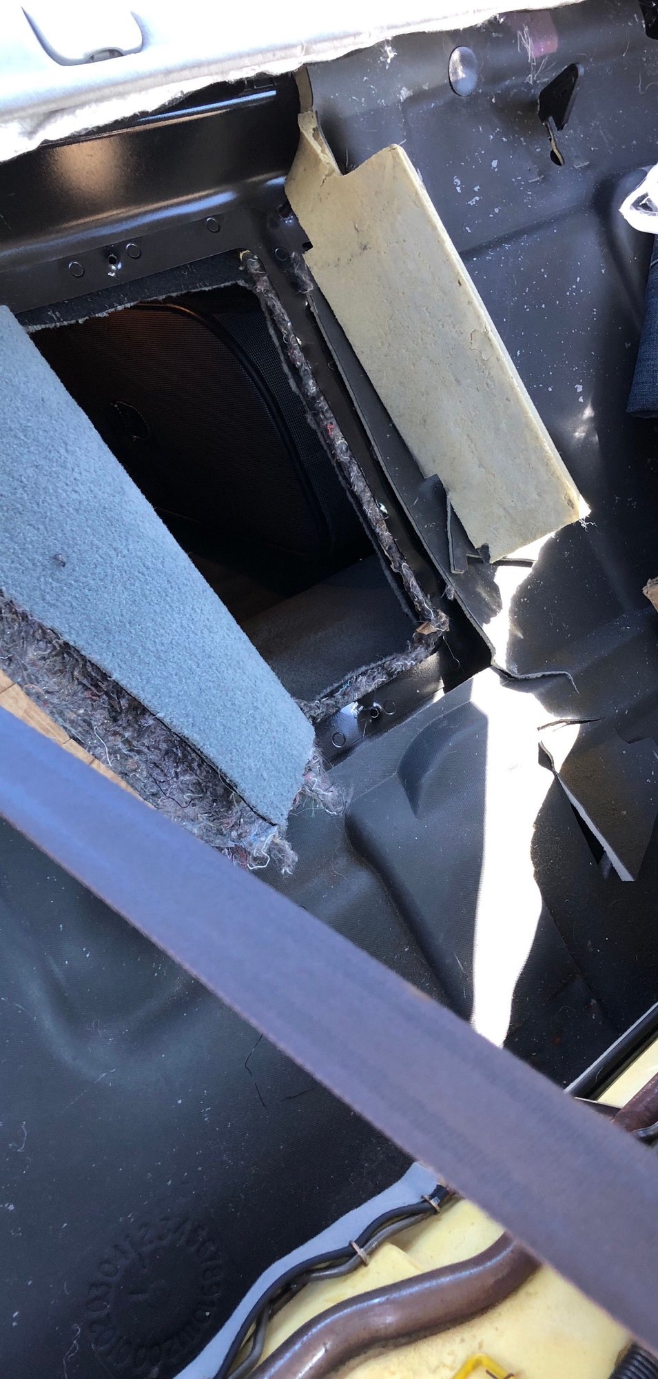

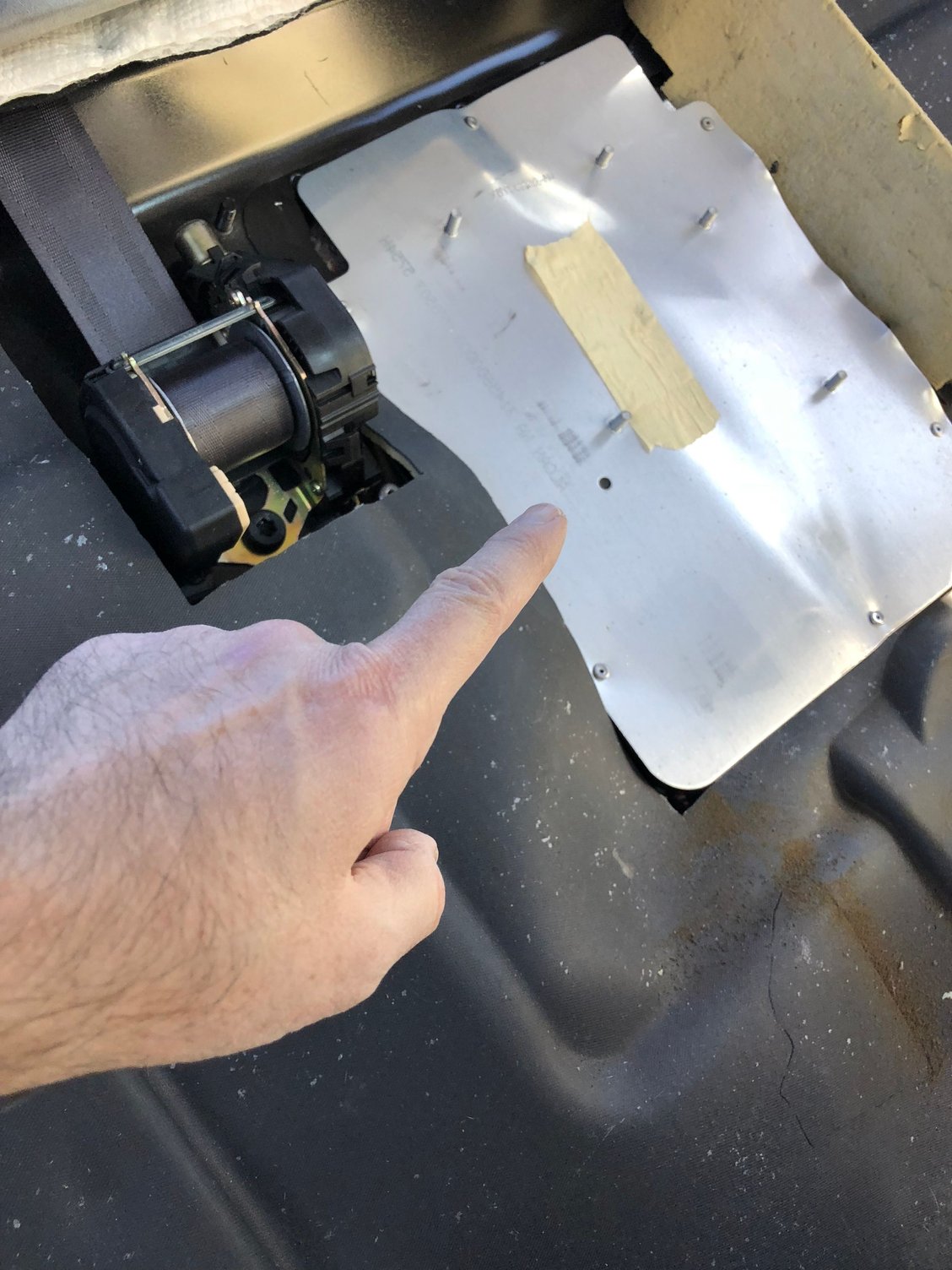

I got the trunk opened through the rear seats. No one talk about it . I had the valet mode on so that was the only option
I accessed
Originally Posted by newuser
I bought the car a week ago but the dealer only gave me the valet key. They said they would try to get it from where they got the car but I still haven't heard from them. Is there any way to maybe reset the valet feature with a scanner? Who knows what I have in the trunk for a week now, well at least there's no bad smells
i was was able to access the trunk through the rear seat, see pictures
Old Nov 7, 2018 | 08:51 AM
  #40
rf69's Avatar
Posts: 349
Likes: 13
From: FL
Default Trunk access through the rear seat
you can get to the trunk through the rear
Pull the strings that are tucked at the bottom of the rear seat meeting the seating part and pull also the rear seat towards you.
You will see an aluminum plate that needs to be removed, I just pulled it with the help of a flat screwdriver .
You will see an opening .
You will have to cut the material to get to the trunk.
seat
see pictures
