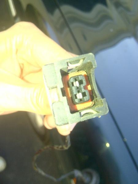

I am your answer, buddy. I did it with OEM Euro-Spec side marker from UK. the Driver side(US/LDH) needs to be wire and you need the side market with the harness and passenger side, is just plug in situation.
Well, where did you plug in the far end of the left hand side marker? One end goes to the side marker bulb holder, and the other end plugs in at ...?

I will try to upload the picture tomorrow

here is what I did
Attached Thumbnails Anyone upgrade fender emblems to repeaters?-img-20111108-00026.jpg   Anyone upgrade fender emblems to repeaters?-img-20111108-00027.jpg   Anyone upgrade fender emblems to repeaters?-img-20111108-00025.jpg   Anyone upgrade fender emblems to repeaters?-img-20111108-00028.jpg

The question was where does the left hand side harness extension physically plug into the main harness.

you need to bring some extra wire from the end of the left harness to connect with the signal module. I did not do it my own but that is like a 5-minute work by my tech.
I also use the 2825 LED light, but keep it in mind that you have the get the flat-head type because I got taller 2825 LED initially and I could not insert it long way in.
