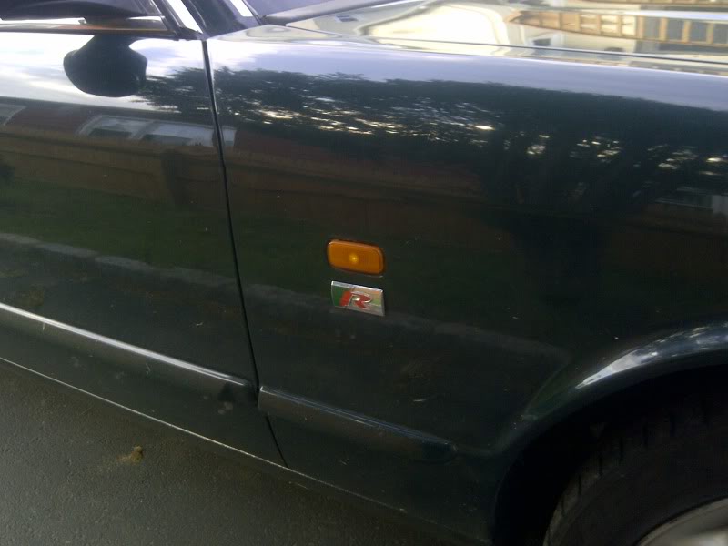

Hi, everyone. Here was what I did and my story
I just purchased a pair of side-markers(amber) from a UK seller on ebay and he threw me with the wire/plug/harness free.what a nice man.
as the forum mentioned, one side was pre-wired so all you need is to take off your side emblem and plug it in the side-marker. yes. that is it
on another side, you need to run the wire to power the bulb plug. Any one with basic auto-mechanic knowledge can do it in less than 5 minutes. well, I did not so my buddy it for me.
(I changed the bulbs to LEDs)
I think the side markers are very functional for safety matter and looks great and clean.
comparing to all other Jaguar issue, even I would say that was a piece of cake
I have one side of wire/plug left, whoever wants it just let me know, you just need to get your own side-markers.
thank you
Vincent

Courtesy of some creative wiring, mine function as running lights *and* turn signal repeaters.
They come on with the side markers but flash if the turn signal is activated. *All* the markers on one side will flash for turns.
