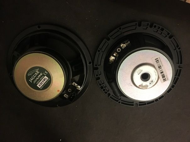

To give you an idea of what you have vs. what is currently out there take a look at these.
20 year old OEM Jaguar Alpine speakers vs. New Alpine SPS component speakers.
I did upgrade the A-pillars with some Aline R- tweeters and that was noticable, though a bit bright.
