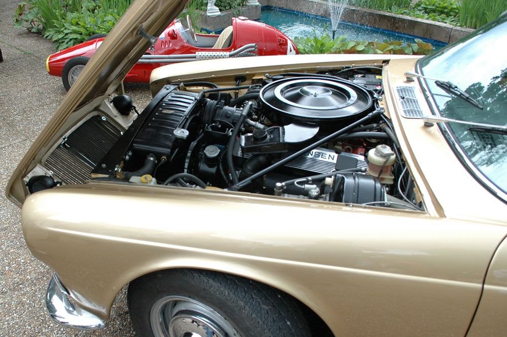

Here we have a car from a local collection. Maybe the only factory(?) made Series 1 AWD . The engine is big block Mopar from Jensen .
