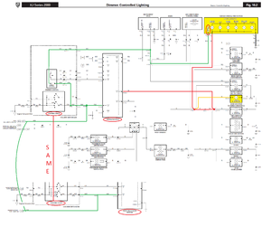

Does the dimmer override work to laminate the Center Control Switch Park ?
Additional TSB to consider :
http://www.jagrepair.com/images/TSB/...%20failure.pdf
Editing , wiring schematic
