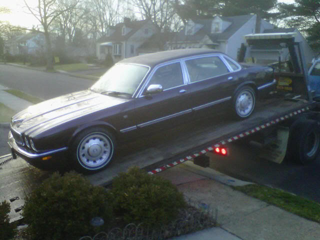

i bought my 98 vanden plas with 130k. water pump . timing chains, numerous upgrades documented. i took her to a jag specialist to have some preventative maint performed that i couldnt do in my driveway. he drained and filled the trans with mobil1 atf , drained and filled rear diff with mobil1 fluid and Gm additive, did a rear left wheel bearing , and put on 4 new ties (white stripe which i think made it look really classic). so i got the car back and drove it for a day, only to have the trans start acting up. when maneuvering , it would not engage drive or reverse without giving some gas resulting in a clunk. then finally that night i moved the car in the driveway and the trans felt like it was bunding up. anyhow, i flatbedded the car back to the shop , he dropped the trans pan and found a bunch of debris. so now i have found a new trans for $400 with 76k miles on it, a new torque converter with 10 miles on it , and it is all due to be done next week. i had preyed i wouldnt fall under the "trans woes" section , but apparently i have. this time i went with the esso 71141 fluid from bavariaautosports for $15 / liter. as much as i cant believe it was the fluid that brough on my problem , im not takng a chance with this one. here are some pics of the sad morning

Even though it's on the back of a recovery truck, it looks 'head of state' transportation...
The early morning moisture makes it appear to have a vinyl roof. I like that.

Sorry to hear this mishappen . Hopefully it will be running same as just came out of factory . Besides that you should replace white walls they look weird

although i can always take critisism, i must add that it was I who put the whitewalls on. i always liked the look of them on the e-types and xj6 series 2/3. that was the image i was invoking... i happened to think it tied in quite well with the overall look of the vehicle,
