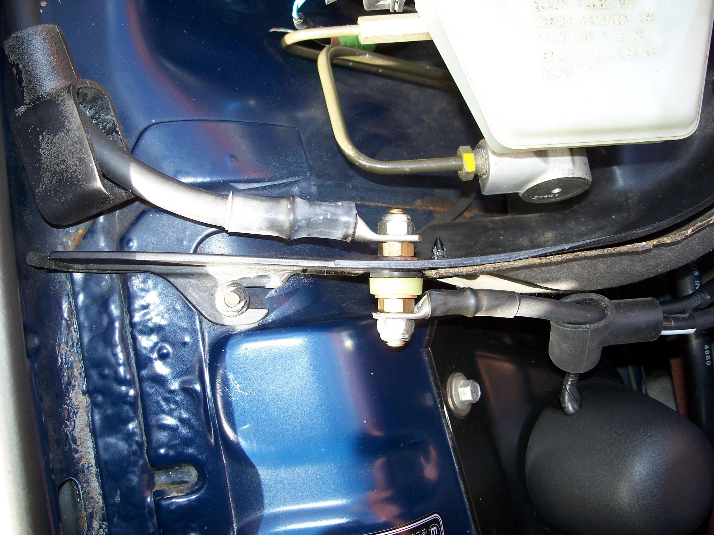

Check the false bulkhead stud electrical connector under the bonnet-it carries the main high current for the starter motor & also the charging current from the alternator.
To find it, open the bonnet & look at the back of the engine bay by the windscreen-you'll see a central long plastic trim piece & also 2 large plastic corner-shaped trim piece covers on each side of the engine bay by the rear of the front wings
If you look at the RH corner top plastic trim cover (passenger side on US cars), you'll see a large rubber cover & a thick lead coming out of the front of the casing piece below the plastic cover. This is the rubber cover for the false bulkhead connector-pull this cover back & check the condition of the electrical connector behind it, as well as the tightness of the connection.
It's very common for this connector to corrode or work loose-it carries the main starting current & alternator charging current for the car, so is very important for correct vehicle electrical system operation. See this thread for more info & pictures:
https://www.jaguarforums.com/forum/x...nnector-92454/
Also check the ground strap from the engine to the chassis as this will cause similar problems.

This is what the false bulkhead connector looks like:
Make sure the nuts are all tight & that there is no corrosion on the connector, as it supplies the high current to the starter motor & the charging current from the alternator to the battery.

I agree with the previous post. This is almost certain to be a bad ground problem, and as the XJ's use multiple grounds do yourself a favor and check ALL OF THEM while you're at it. Also get your mechanic to put a load tester on the main feed to the starter and see how high the current draw is. It's possible that with the poor electrical connections you've been experiencing for awhile that the starter is going (not too likely) or that the main running to the starter has gotten too high a resistance through age and internal corrosion.
Check those grounds and bet sure they put a real load test on your battery. Heavy amps and then check the batteries recovery time.

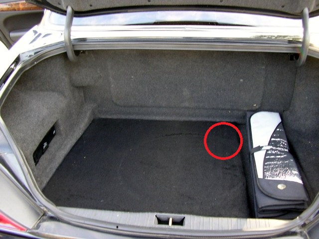

Also, in the trunk are a couple of VERY LARGE fuses. They bolt up against the front side of the Spare Tire well inside a black box about 5 inches square. Those connections can also become loose.
I don't have my XJR anymore, but they are located beneath this cover about where I've circled.

The original fault was intermittent starting that then became a permanent non-starter. The O/P noticed that moving cables would sometimes cure the fault, so I think the first thing to do is check over the main electrical connections across the vehicle.
Jump starting the vehicle from the point between the 2 engine bay fuse boxes is not advisable, because this supply route has a smaller fuse rating from the battery & when the starter current passes along this new route, it may well blow the smaller fuse in the boot.
I would suggest checking over the mail electrical connectors-I wrote a thread on this recently:
https://www.jaguarforums.com/forum/x...ections-94978/
I would also have the main engine ground strap checked from under the vehicle-any high electrical resistance here will cause starting & charging problems...
