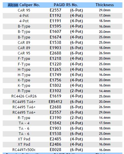

Am thinking of getting the Pagid R15 next, they sure look good on paper, just look at the friction range from cold to hot:
‘PAGID RS’ Material Specifications.
http://www.pagid-brake-pads.co.uk/pr...amic-based.php
Can't find any for my Alcon's.....but they must make them, they must!
