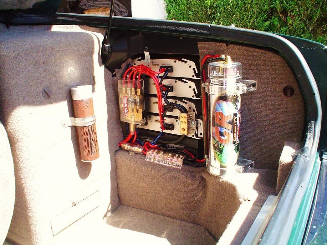

You may want to consider a good quality capacitor to help the alternator on sudden high peak current draws.
On my XJS I have a 977 wrms system and I help it with a 2 farad cap, although with classical you don't necessarily encounter so many highly demanding notes.
On my XJR I have a similar system but I have not added a cap and, apparently, don't miss it.

I'm going to politely disagree here. A Capacitor is almost always completely useless. If you are having voltage drop issues then the cause is your battery, and you should remedy this.
Using a capacitor is the equivalent of cutting your leg off and trying to stop the bleeding with a band-aid.
The batteries in our cars are quite large to start with, and I would be very surprised if anyone here is running anything big enough to stress it. Myself included, and I'm pushing 3000wrms.
disclaimer: my system is the definition of overkill, and even with the music turned up I'd be lucky to be using a third of it's capacity

Plus tweeter amp under the battery
You may be right, although the principle here is quite basic: You have instantaneous high peaks where the system may not necessarily have the full amount of instantaneous amps to cover the full demand. I have heard many times from people whose dash lights flicker with amp-demanding musical notes. I'm sure that a cap would resolve that problem, although I do believe, as well, that a review and optimization of those cars electrical systems will achieve similar effect. With the type of music that I listen to I may not have more than 10 cases (out of some 300 or more hours of music) where music notes may demand my system's top supply capacity. Like I said before, on my XJR I have a similar sound system with no big cap added and I just don,t perceive any difference. The caps don't look bad, though....
