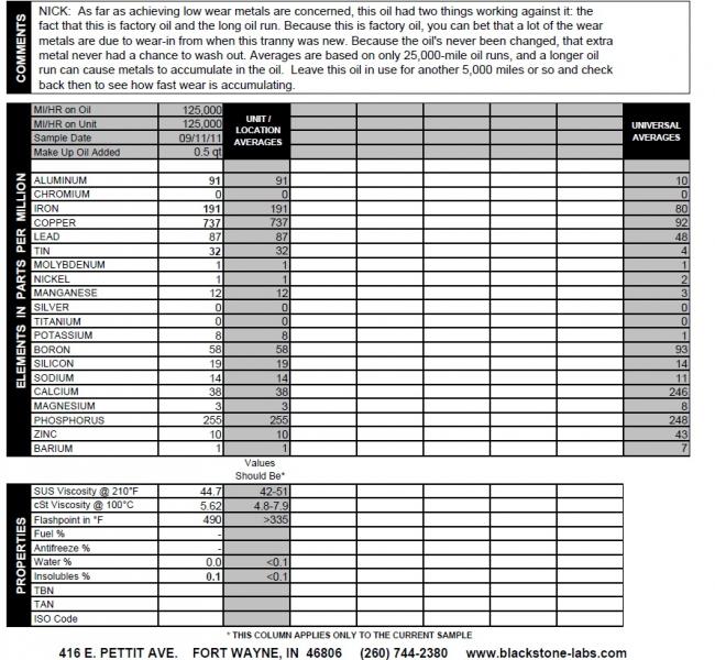

i know you some of you guys use blackstone labs...they are awesome...any comments on the results...i love how you can benchmark your fluids...even though it does seem weird giving my car a pee test...
Attached Thumbnails black stone labs - got my transmission fluid results-blackstone-lab-result.jpg

That's a lot of foreign matter in the oil. The followup would be interesting to read.

Iron/Aluminium and especialy copper look pretty high to me.
Here was a test result of my box at 125.000 km:
Kopper was 176, aluminium 43 and Iron 93, and got the advice to take action (so change the oil).
