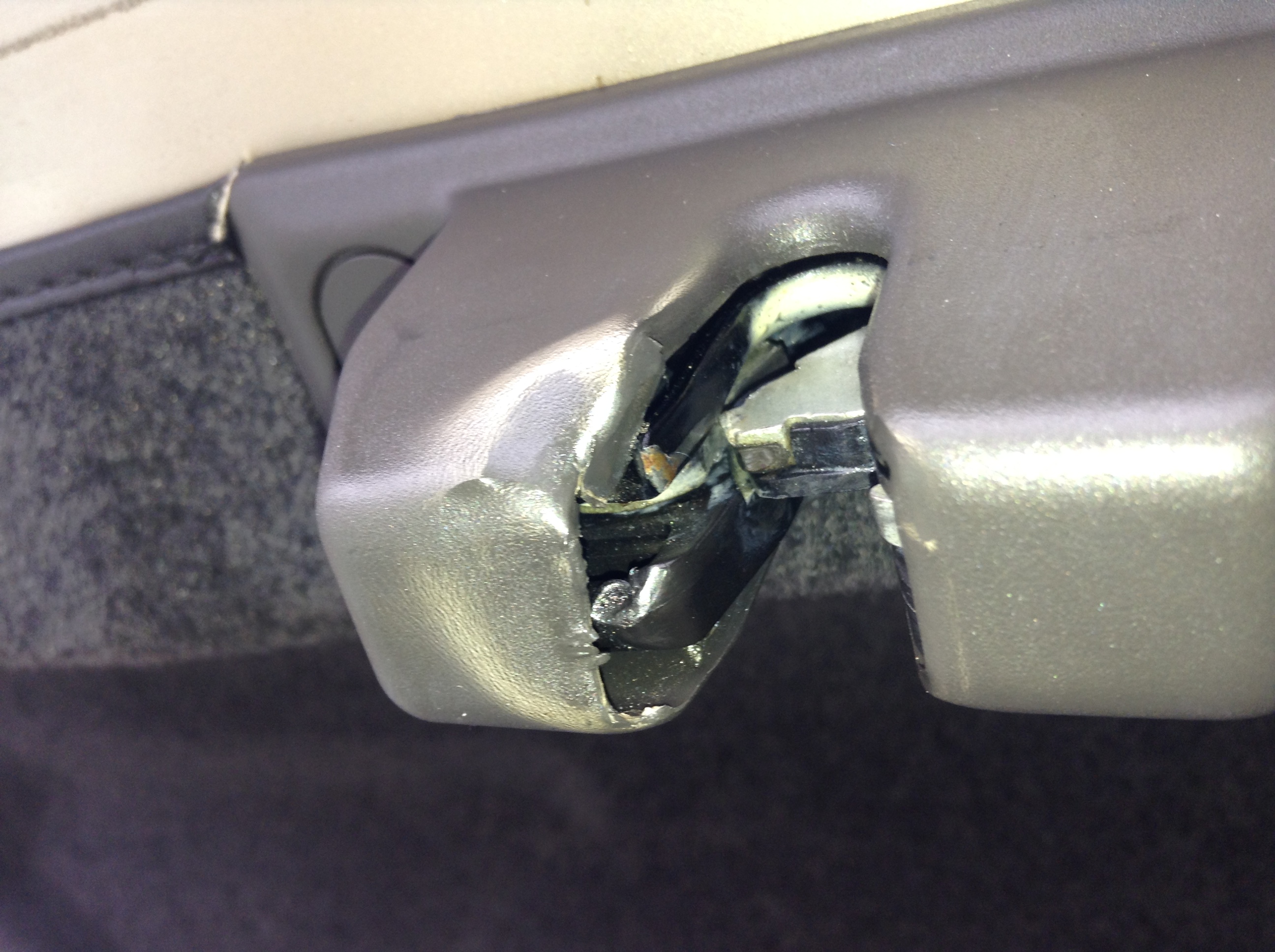

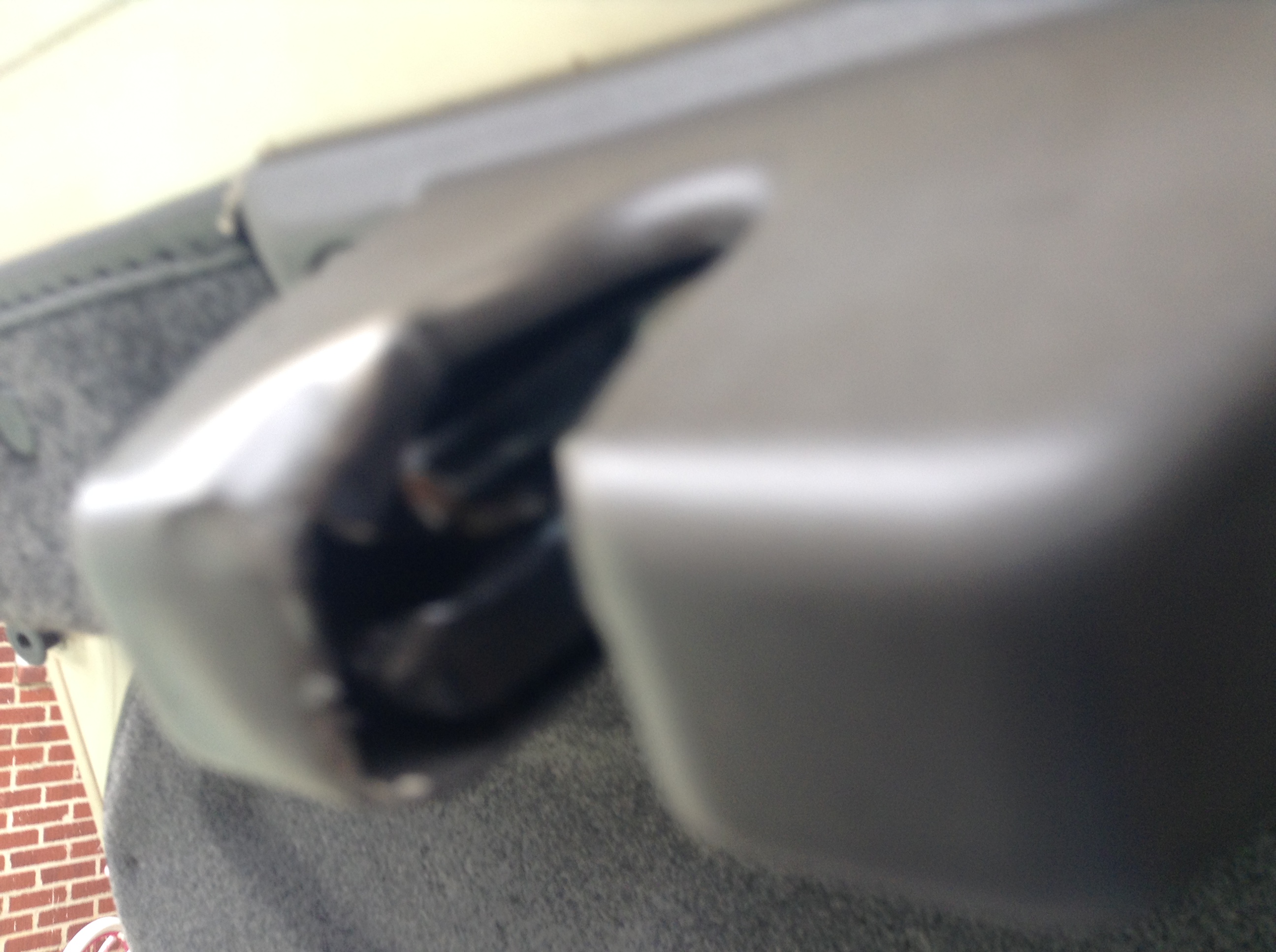

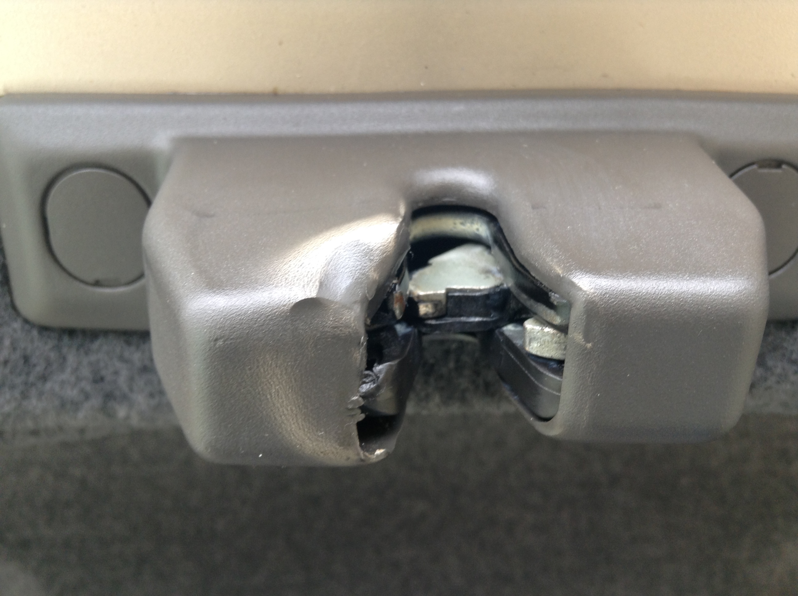

would this be causing my boot open warning message? A broken plastic boot latch and boot latch itself?

Yes, did something fall into the recess obstructing the lock to close?

+1 Is the fixed latch component on the body misaligned (loose bolts?). Clearly your boot latch is slamming onto something hard and not triggering the sensor.
Otherwise, I would tear into the wiring running along the right hinge for a frayed wire (my problem on my first 01X308; took the tech three tries in 02 to fix). But that beat up latch cover says that's not the problem, most likelihood an alignment problem -- may even have broken the latch, hard to tell from your photo. So, minimally, quit trying to close it until you fix the alignment, you are making it worse.

I dont know as my uncle who was very old (passed away) had this car before i did. But he might have hit something that caused this warning message? The boot closes nicely and only on one try, should I replace the Boot latch and plastic cover?
