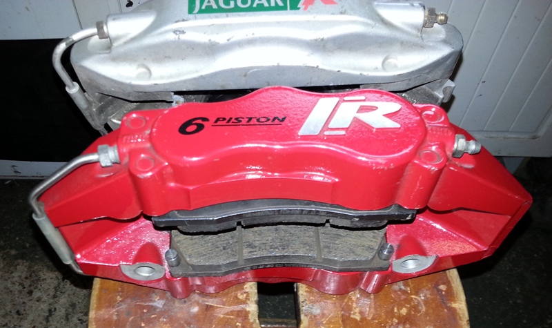

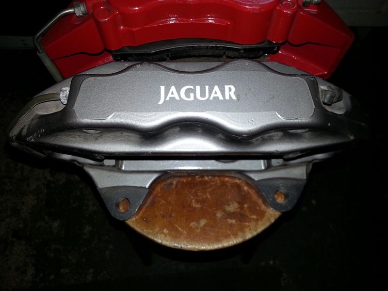

The pic below shows the main 3 types of brakes used (I would of posted up the APs but they have been sold)
From top to bottom, your standard Brembo, Alcon 6 pot as fitted to X150, Portfolios etc, last X350 Brembo
The standard Brembo caliper is a simple upgrade, all you have to do is either bolt them straight on, this you can do with the early type that had a bolted on bracket otherwise you have to tap out the upright mounting holes to 14mm X 1.5mm pitch. In both cases you will have to either change the back plate, flatten it (my personal preference) or cut it. A good mod in my opinion, looks great, improved braking, less fade on heavy use (you won't really notice this unless you go on a track).

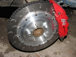

Brembo conversion done on a XK8
Alcon these look fantastic, can be used with standard Brembo discs but the pads would need to be shimmed as they are meant to take 36mm thick discs, it is possible to use the Alcon discs/rotors, these are 400mm and quite cheap to buy, however they would have to have the PCDs redrilled and a spacer fitted between the disc and hub. Alcons are simple to mount due to there design, you bolt them on via a bracket straight through the body. The first set I fitted to an X100 did give a bit of a spongy feel to the pedal, we got over this by fitting a servo and master from an X150, without doing this the brakes still worked well but the feel was a bit disconcerting, unsure how this would be on a X308 (I beleive Sean will be better to answer that question).

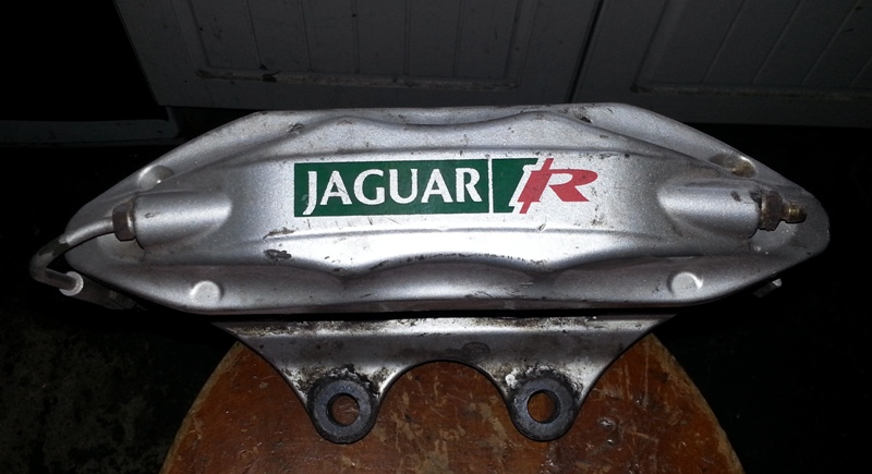

X350 Brembo is a monoblock style caliper, basically they are one lump and do not separate like the earlier brembos. The hole spacing is 158mm (?), this causes a bit of a prob! To get a good position on the disc the caliper sits too low, the lower bolt hole half covers the lower bolt hole of the upright, this then causes a problem fitting a bracket, if you lower the caliper to give enough room this then fouls the steering track rod end, if you go above you foul the top ball joint!
So I did this and machined off the lugs, there is plenty of material to get a 12mm tapped hole in there.
This gives you a lot more options, would be great if you could drill right through like the Alcons, but you can't....... This is as far as I have got, the setup maybe a little different on the XJ as apposed to the XK but my surmise was if the early Brembos fit both cars and I know the X350 type dont fit the XKs then what are the chances they will fit the X308??..... I don't see this as a commercially viable option but I will have a go and doing the conversion if it works I will put all the info up with drawings and dimensions.....
