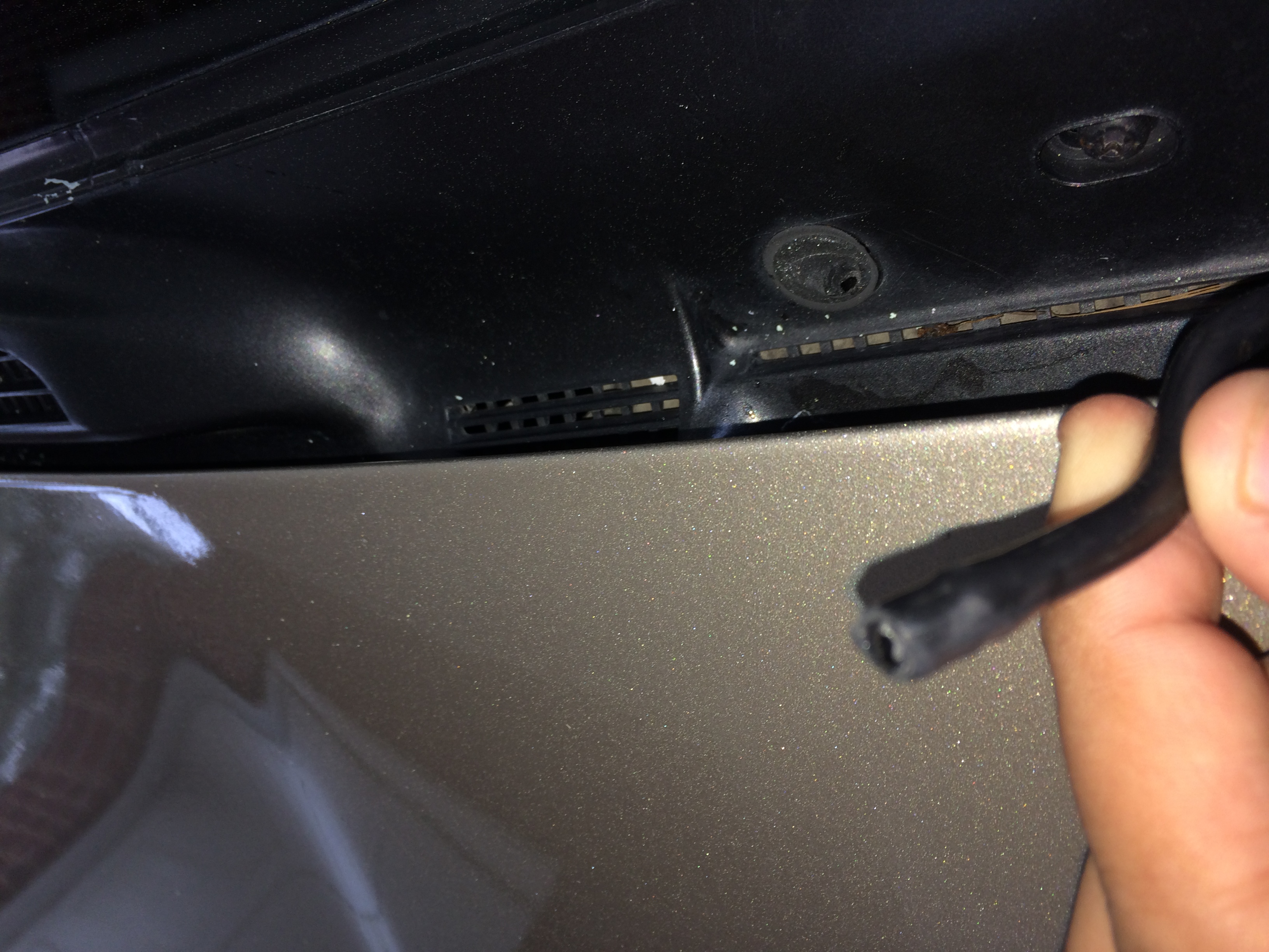

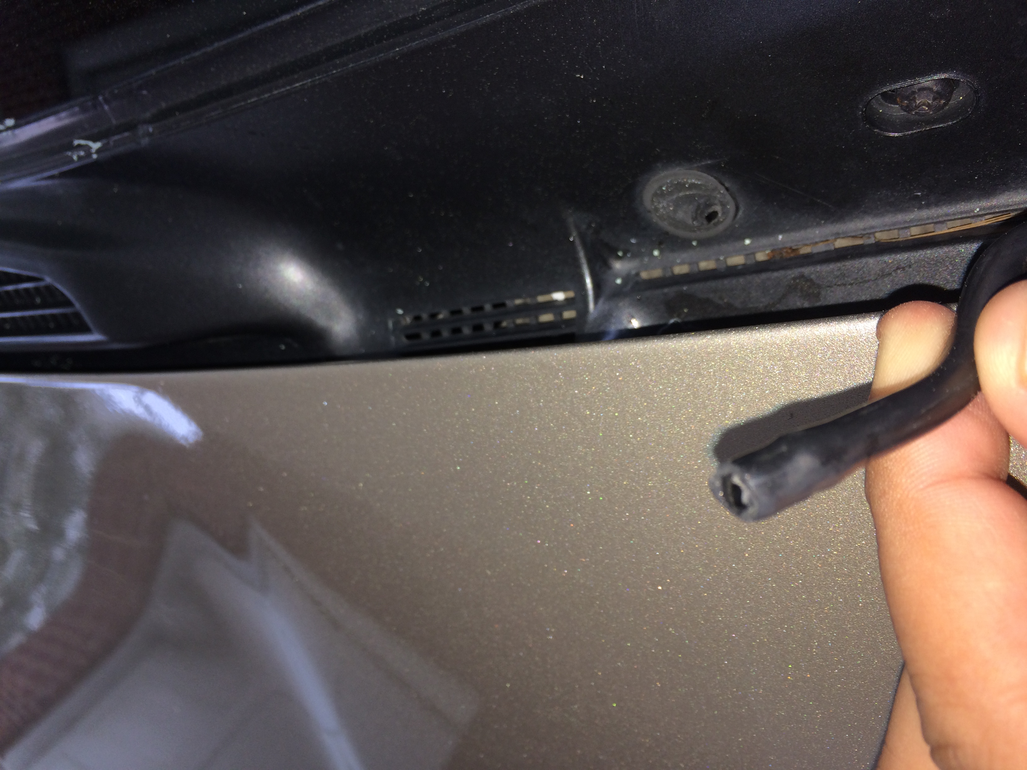

Today I seen the windscreen washer fluid hose damaged. How would I fix this.

Part #GJA8969AB (JAGUAR OEM 98-03 XJ8 Wiper Washer-Windshield-Connector GJA8969AB | eBay)
Remove the cowl (4 or 5 screws) to remove/install the replacement elbow.

Does that also come with that hose that broke off? and where does that connect to? the Wiper arm?

You shouldn't have to replace the hose. Just remove the broken part of the elbow from inside the hose and then put that hose onto the new elbow.

The thing is that the hose has the old broken piece in it...

Mine was the same way. I can't remember now how I got that piece out of the hose, either used some needle nose pliers or simply squeezed it out with my fingers.

putting the end with the part inside it in hot water will help to make things flexible, and reduce sticking.

FYI -- The hose often fails at the connector ... there is enough hose to cut off the end and reattach. Make sure that's not the case with yours -- with the shorter hose the wiper pulls on the connector with each wipe until the connector snaps.
Jaguar sells the hose -- my dealer had a few of them ... I think they charged me $10. The list is more and really .. it's just a length of hose. I think the OE may be HD hose .. but I'm sure you can find some for less.

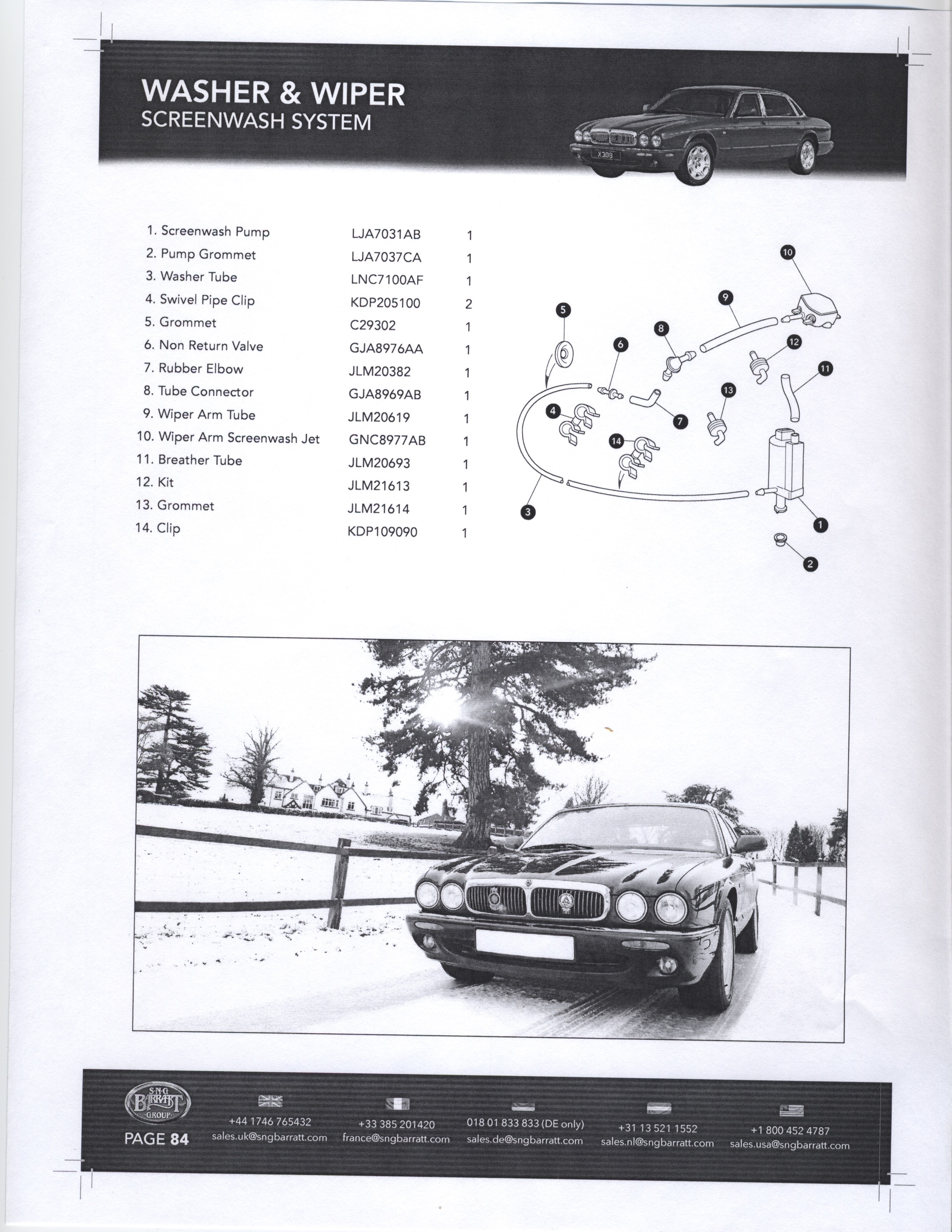

Do you know the part # of the hose?
This is what I have
