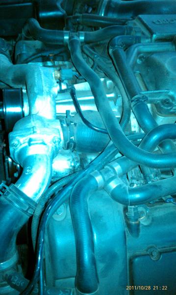

Is this hose about to explode or do they all look this way? This is a vdp s/c.

that looks like a problem to me
I was just interacting with those hoses when I took out my supercharger, I had no such bulge
Old Oct 29, 2011 | 12:36 PM
Ye gods, it look like a boil ready to burst.
I'd certainly look into it pronto.

Looks bad to me! Until you can replace it, you could put some hose clamps around the hose to squeeze it back down to something like its normal size.

And I thought mine was bad. It looks bad and you should replace it.

Sounds like a consensus thanks!

Similar to an aneurysm in a blood vessel, the wall tension in that hose is now so high that it will rupture. I vote for not driving it until replaced (or at least until a slightly smaller diameter section is placed in the inside for reinforcement). Good job you are vigilant.

Just a quick question, Have you checked your water pump, because I had a very similar hose on my old XK8 and it turned out to be caused by the pump. As the coolant was overheating it was building pressure in the hose.
It might not be the pump but I would definatly get it checked and keep an eye on your temp gauge.

I also wonder about the water pump not pump heated coolant thru the hose, and leaving enough hot coolant to stay at the mouth of the hose to cause it to bulge like that.

I had the same hose buldge up like that !
Could be a picture of my car a month ago ...
My other cooling hoses where on high pressure two.
After replacing the hose and refilling (also through the supercharger fillplug)
the high pressure seems less

It looks bad but I drove mine for about a year before I replaced it with a Uro brand hose.
At first I thought it was shaped that way on purpose. The actual hose material was in reasonable shape.
The new hose also bulges, if to a lesser degree.
Jag hoses are pretty tough, it seems to be that connectors and the plastic thermostat tower go first.

Well I got my replacemnt form JPAM... In order to get clearance I removed the header tank to thermostat bleed line.. in the process I broke the bleed line, It seems like the blastic and o rings had done a decent job bonding to themselves to the alumnium. Do they make a special tool for squezzing the disconnects on these hoses? If I would have been able to pull straight back maybee it woudln't have broken... My track record is pretty poor getting these little hoses off with out breaking them. As for the rubber hose that was bulging it definatley needed to be replaced.
Any special tools or advice on how to get these little quick disconnect bleeder hosese off with out breaking them? I can never seem to get them squeezed down enough so that the catch is released on both sides.

I just did mine on my '00 XJR. It was bulging like the one in the photo and I found the hose to be very squishy and when I got it off (I cut the old one) there were flecks of rubber in the coolant from that bugger. New one is only a minor bi*ch to replace as I had to disconnect the water pipe on each cylinder head and move it forward enough to get some clearance to slip the new hose on. Oh, and those clamps....yeah, you can use long needle nose pliers, but you'll wish you had the right tool for those....clearance on the bottom clamp sucks!
