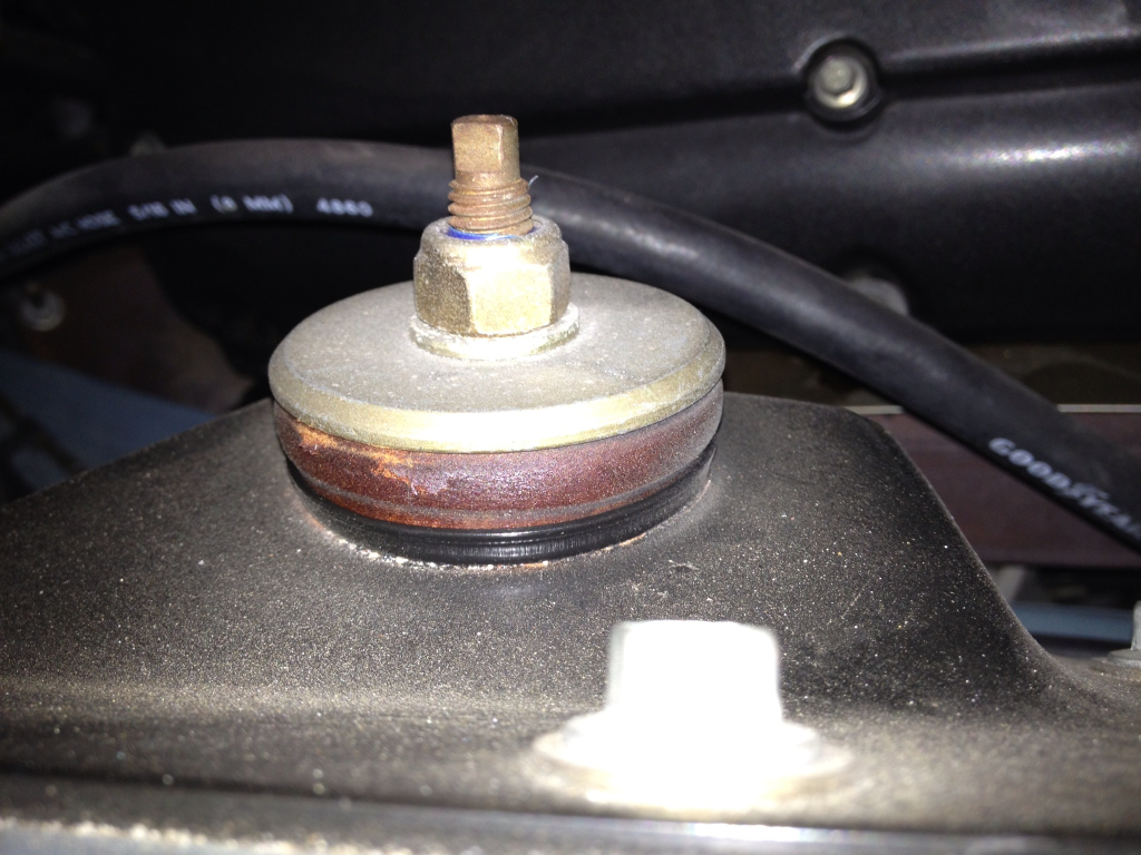

How do the front upper shock bushes look? I suspect it will have cats suspension - unless the dampers are leaking they don't need changing.

Thanks for the info -- but I don't know what load force balancing is, should my mechanic or tire shop know what it means?
The front upper shock bushes look original. I'll run out and take a photo and post it in a few minutes. Thanks again.
1st photo is passenger's side, 2nd photo is driver's side.

Oh yeah, does anyone think I should replace the upper front shock bushes that are pictured above? I'm not planning to replace the shocks since they don't seem to be bad (bounce test), but I could replace the bushes. Should I do so, or leave well enough alone?
