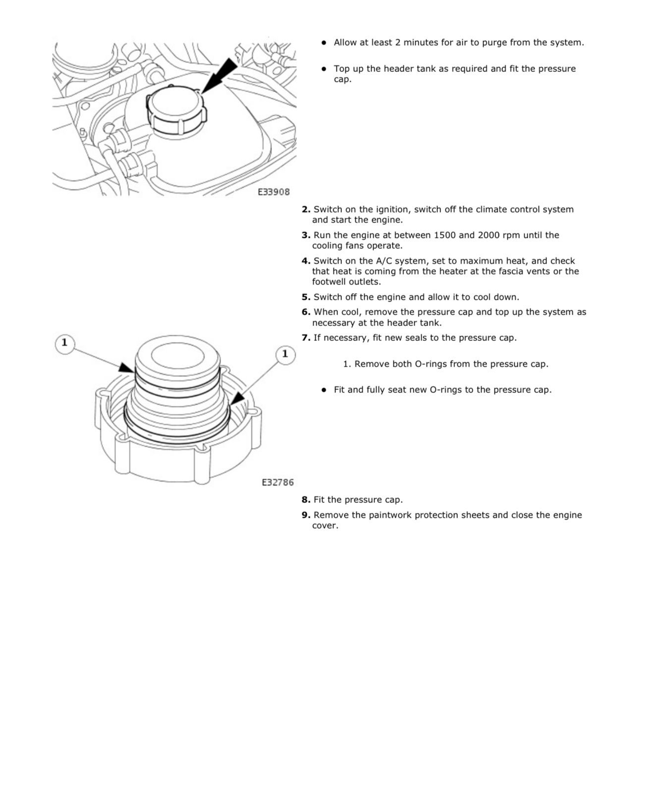

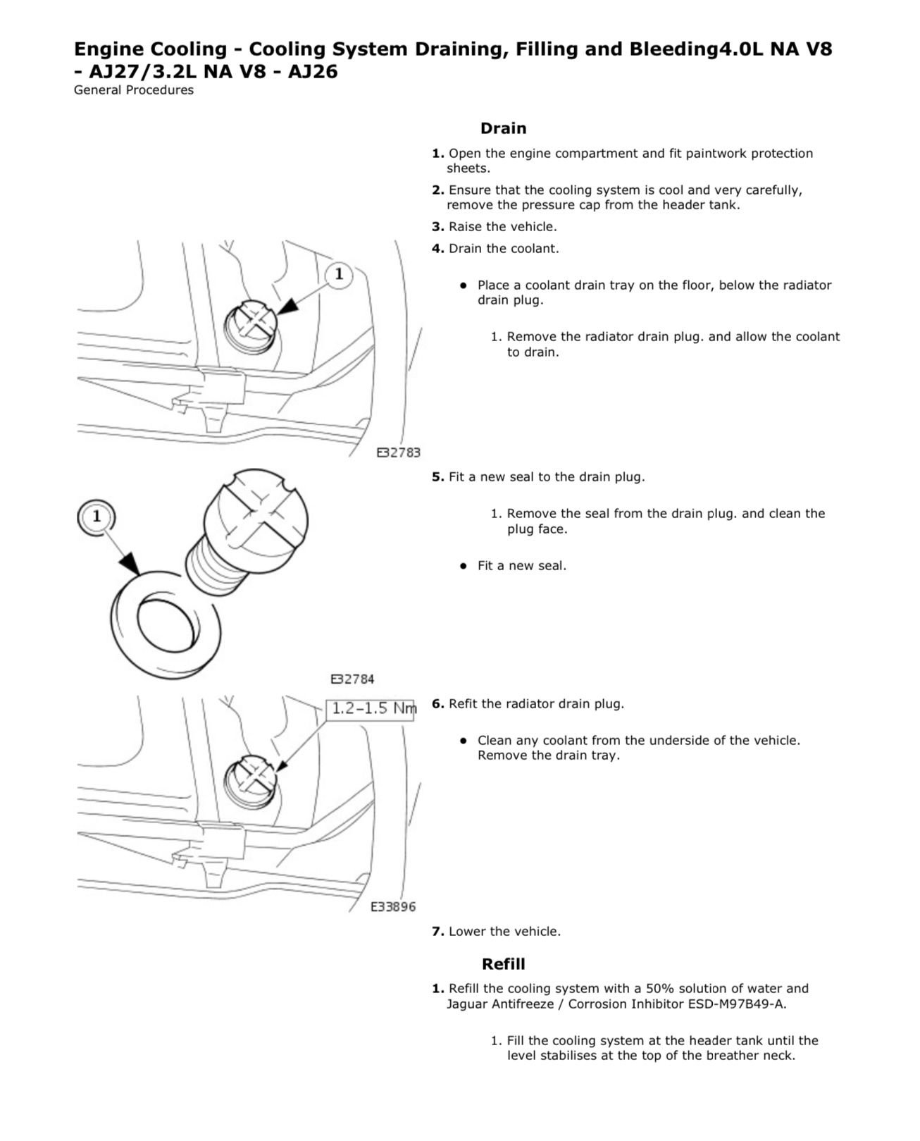

Here is the SC bleed procedure .

Non supercharged bleed procedure

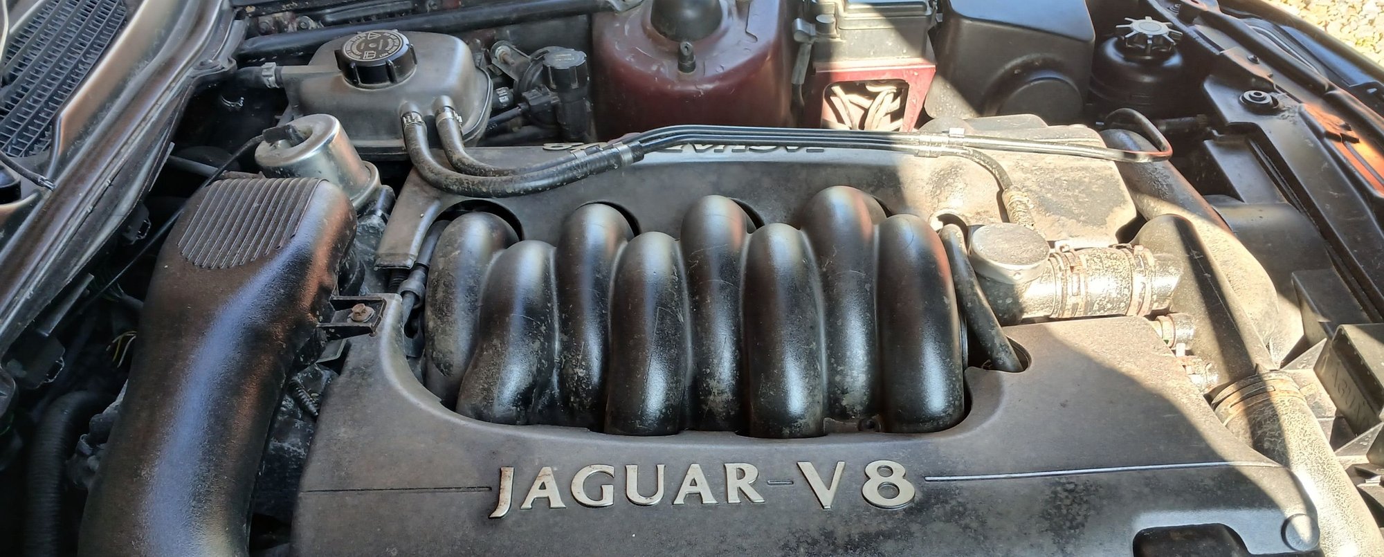

Here is a photo of my engine and you an see the silver cap on top of the thermostat housing
Old Apr 3, 2025 | 06:27 PM
motorcarman's Avatar
Posts: 13,775
Likes: 9,742
From: Wise County,TX
Also looks like EARLY XK with the chrome throttle vacuum actuator. (I wish I had saved a few 'back-in-the-day')

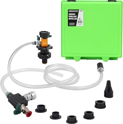

I have now changed to using only a vacuum filler. Once you try one you won't use any other method.
Works surprisingly well and I wish I had purchased one years ago.
Old Apr 4, 2025 | 09:59 AM
Riber3's Avatar
Joined: Sep 2024
Posts: 22
Thanks for that It sounds like a good idea do you have a link or a photo of one as I have a filler like the one in the above youtube link
Old Apr 4, 2025 | 10:58 AM
clubairth1's Avatar
Community Influencer
Posts: 12,233
Likes: 3,423
From: home
I have the OEM brand but I don't recommend it just because there are too many other good unit's out there. Not much to the tool so it's a commodity type purchase.
Mine has more than paid for itself.
I have the black plastic case which I much prefer and it looks like it's now neon green.
About $100 and they are all over too.
Vacuum Filler Vacuum Filler
Yea I just laugh when I see the massive funnel and all the adapter's and conniptions people go thru squeezing air out and bleeding it out. Parking the car up hill. All that goes away with vacuum filler. I might need to top up the coolant a bit after several weeks but it's very minor. I just could not believe it worked that well and the first time I used it I bet I checked the coolant level a dozen times!

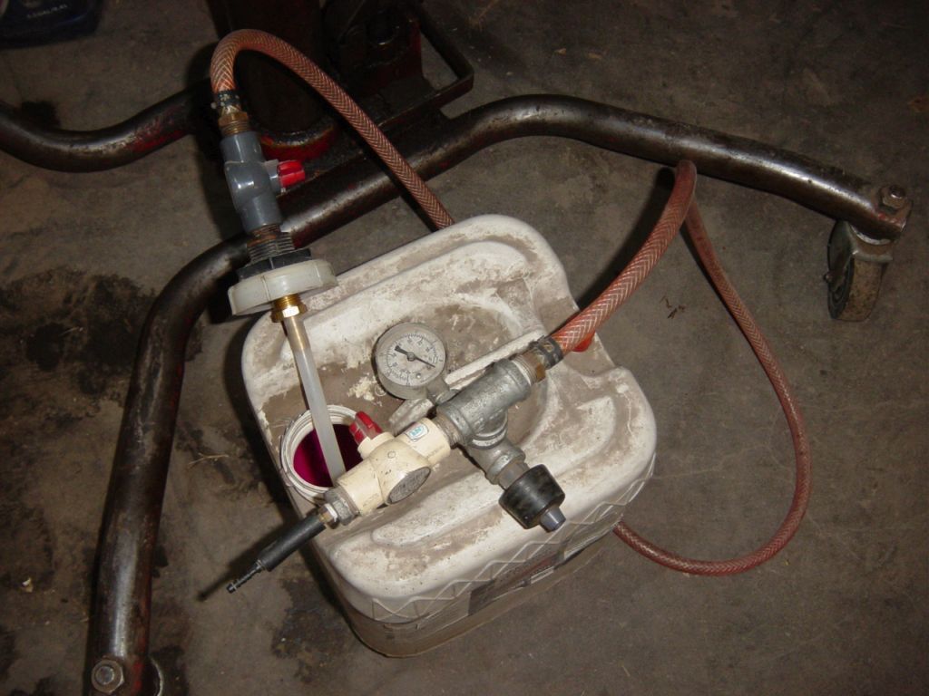

I made my own vacuum filler with two 5 gallon containers, one for VW G12 and the other for the Jaguar ORANGE. (dexcool)
A rubber stopper with a hole in it for a barbed fitting, TEE connector, shutoffs and vacuum gauge.
I use a cheap venturi air powered vacuum for A/C to 'suck-down' the cooling system to about 15 inches of Mercury.
All this can be bought for cheap at the hardware store or eBay/Amazon.
