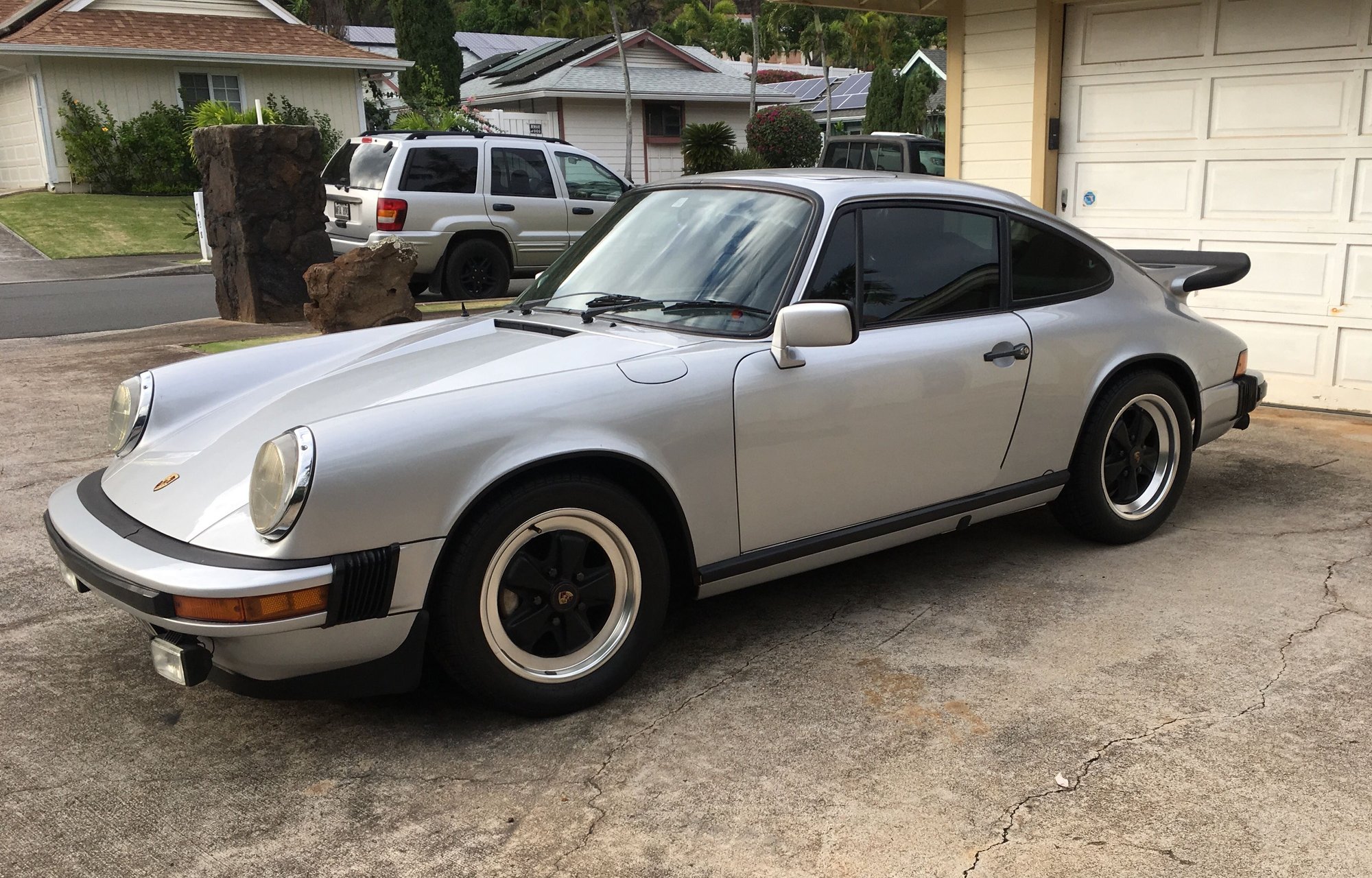

I have rebuilt 3-4 car engines in the last 40 years (my pride is the "problem" 2.7 911 engine. 15 years, 10k miles no problems, no leaks)

Pics:
the 1999 XJ8
My 1974 911 2.7 (magnesium case) that I have had since 1986 (I know EVERY screw and nut on that car) Oh, and my 2004 WJ in the background (almost brand new...
