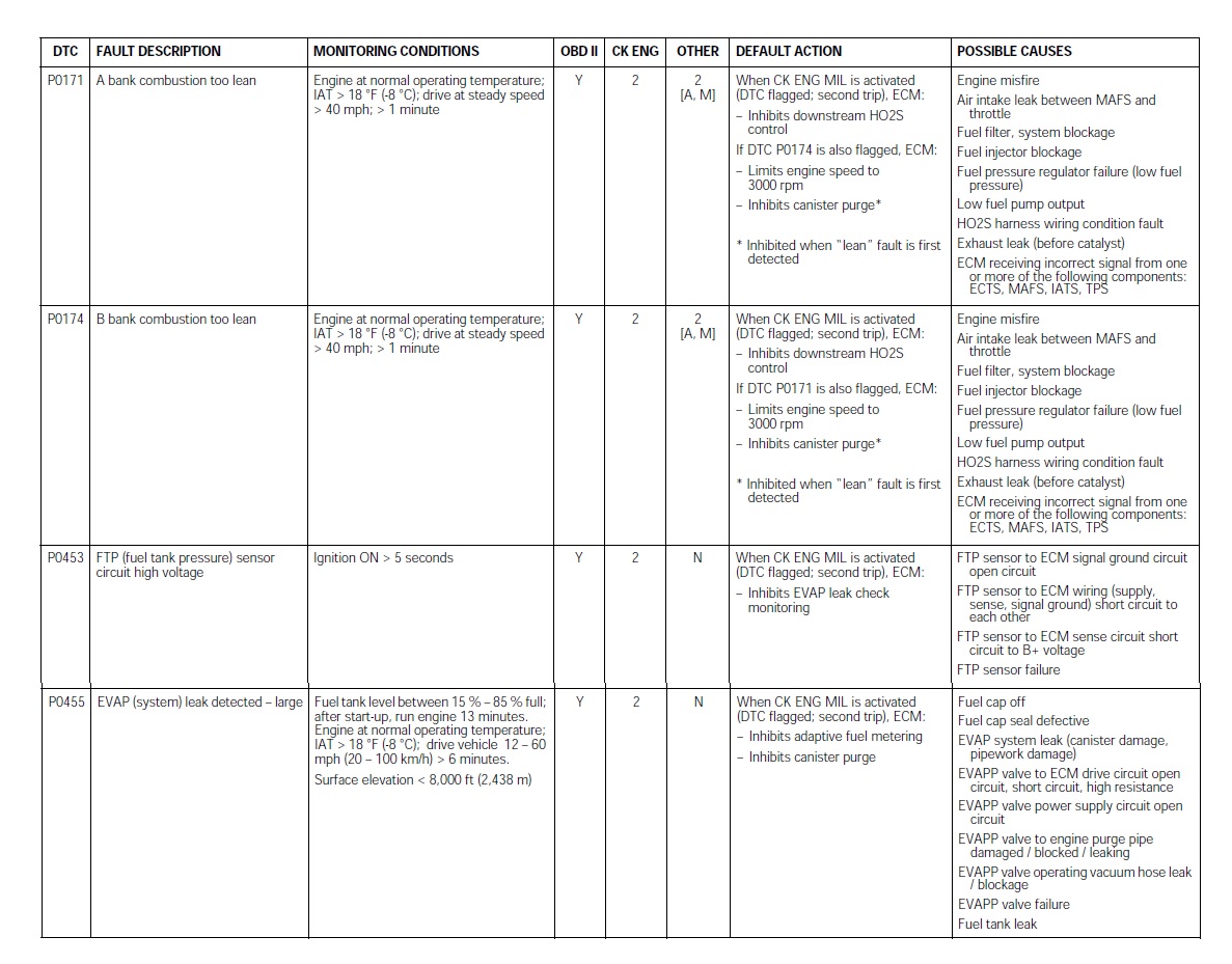

Systematic troubleshooting is the way to go. Read the codes, identify contributing factors such as wet plugs / missing fuel tank cap / coil condition. Note the 'Default Actions' and work through the 'Possible Causes'.
You can ignore P1000. This means OnBoard Tests have not been completed since the last memory clear. You will always see this or P1111 (OnBoard Tests completed).
The full DTC listing for the other codes is:
Faulty coils set an individual code for each cylinder so it looks like these are still OK.
Air leaks should be first on the list to check. Repeated failed attempts at starting will have resulted in neat fuel in the cylinder bores (and wet plugs). The plugs should be thoroughly dried and a few mls of oil put into the bores to counter the wash and restore compression..
Attachment 49449
I honestly think that the P0455 code is coming from the fact that the fuel tank cap is missing. I remember when I was siphoning the gas out of my tank in order to replace my fuel pump, the small round metal spring loaded seal at the top of the filler neck was not closing flush and there was a small visible space in between the two.
