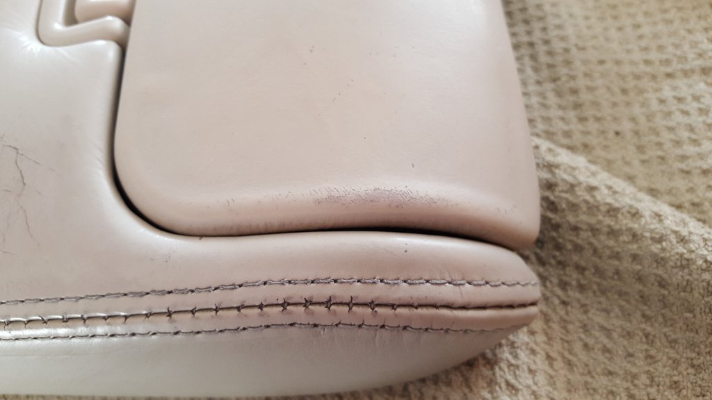

The top of the armrest is worn, but I think its good enough to re-colour and save. Fingers crossed!

Both front door armrests are worn, not sure what I am going to be able to do about this; might need to come off a be re-finished/coloured.

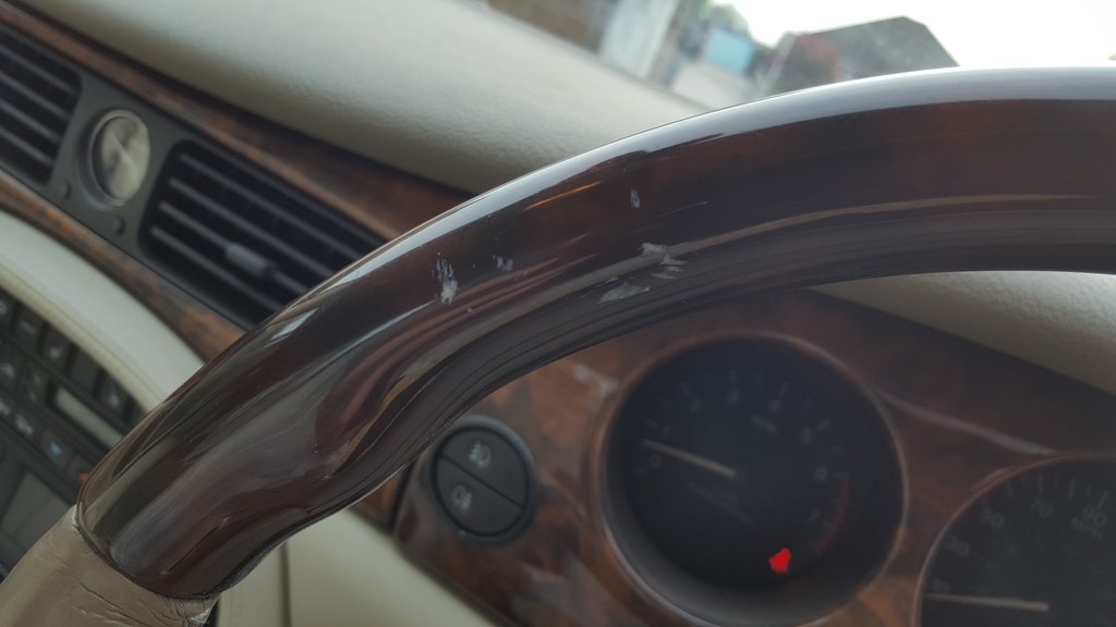

Lots of ingrained dirt on the steering wheel. Should come out nice and easy, and it looks in pretty good nick actually.

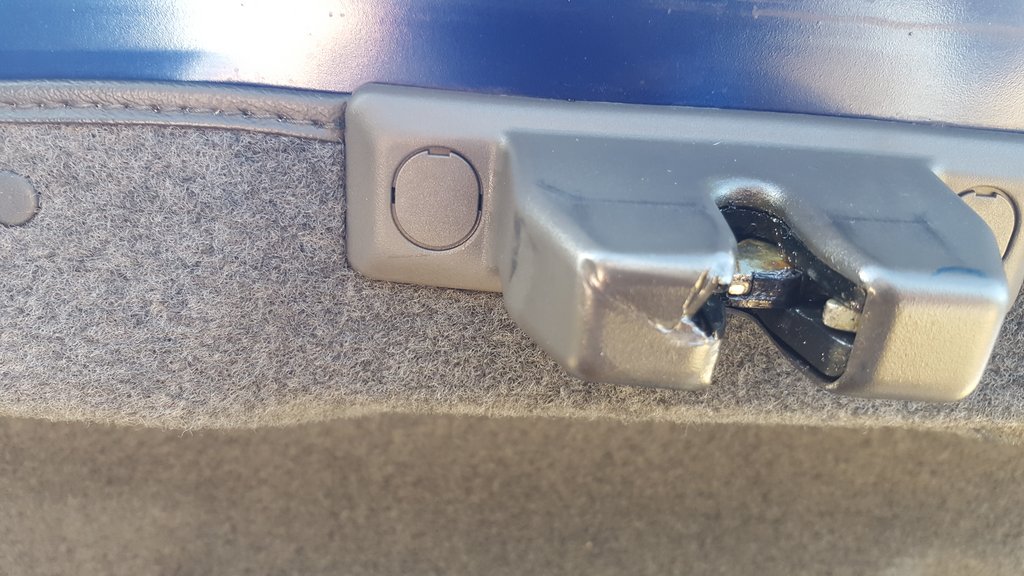

Some minor damage to the latching mechanism, although its just cosmetic.

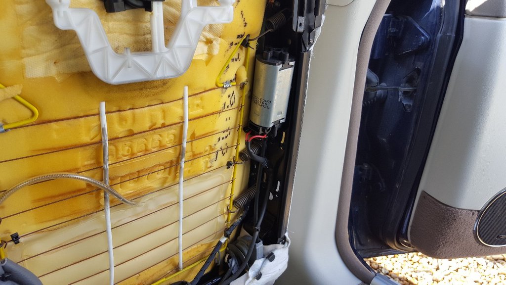

This little area appears to have a slight bit of damage. I am going to have to remove and inspect.

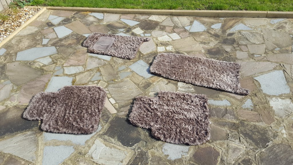

Lambswool matts are missing, and the carpets look awful.

A lot of the leather in the Daimler was looking tired. So in November 2018 I decided to try out my repair skills on the front armrest; particularly as I could easily remove it and work on it in the house.
After cleaning, this is what I was starting with:
I used one of the Gliptone Scuffmaster kits, made for the magnolia shade of leather in the Daimler. I used the sponge to apply the colour, dabbing it repeatedly until it evened out, and using very light, thin coats. I did not paint the whole armrest, just the worn areas, but I blended it with the existing colour by tapering off.
After what was probably 6 or 6 coats I was left with this (you will have to forgive the difference in shade, I took these under the houselights; the previous were natural sunlight):
For a first attempt, this tidied it up nicely, which indicated it was worth trying to re-colour the seats and armrests.

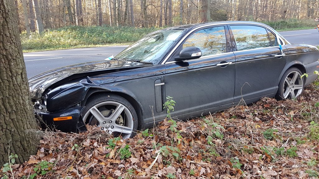

I was driving through Thetford forest to work one morning in November, and all of the traffic came to a halt in front of me. I have to confess I was part day dreaming, worrying about some stuff we are doing at work as it happens. I was actually some way behind the car in front, but by the time I realised the cars were all stopping my brain did some calcs, and decided the best thing was for me to steer around the traffic, off the road into the grass verge.... big mistake.
It occured to me that if I had just kept straight and applied the brakes I would have probably been OK, after all as a queue of traffic we were probably only going 45mph. But sadly that's not what I did. I steered into the long wet grass of the verge and then all steering seemed to vanish, the brakes were doing nothing, and I skidded right though the growth and into a massive tree!
It turns out there was a military vehicle broken down at the side of the road, and the traffic was having the stop/start to get around the narrow road.
My car was recovered after I phoned my insurance company. To my surprise the car still ran and drove!
Boy did I feel like a complete prat...
The garage quoted £9,500 to repair the damage, which meant the car was written off. To my surprise I was not covered for a courtesy car if my car was not being repaired.

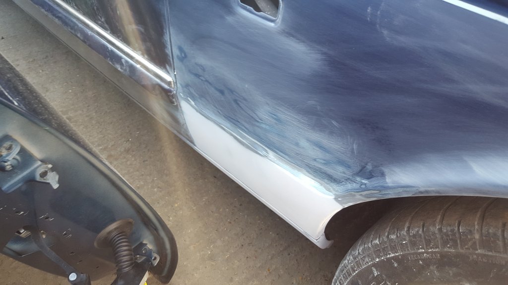

In December 2018 the bodyshop had the car for a week to do some quick preparation work, as the panel beater was due to be on holiday for the first few months of 2019. The rest of the work was planned for after Christmas by the remaining guys at the bodyshop, in January.
So this:
Became this:
I then dropped the car back off to them on Monday 14th January 2019. They said it would take 3 weeks to complete.

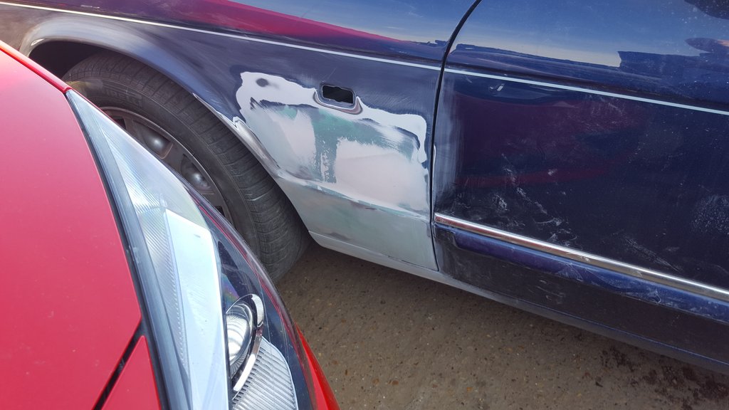

Sadly this did not go to plan. The bodyshop in question did a lot of "urgent" work for the local car sales dealers, and because it was regular work it always went to the top of the Queue. A total of 6 weeks later they had at least made a start, but the car was some way off. All of the arches were stripped, and they reported they found loads of fibre glass - and even an Aluminium Pepsi can in one of the front sills!
They found more rust on the floor. I gave them the go-ahead to repair this too.
I also asked them to respray the complete front bumper for me, at an extra cost, as I noticed a nasty scuff, and there were already lots of stone chips.
Kept chasing, but at the end of March things had still not changed.
So this:
#Became this:

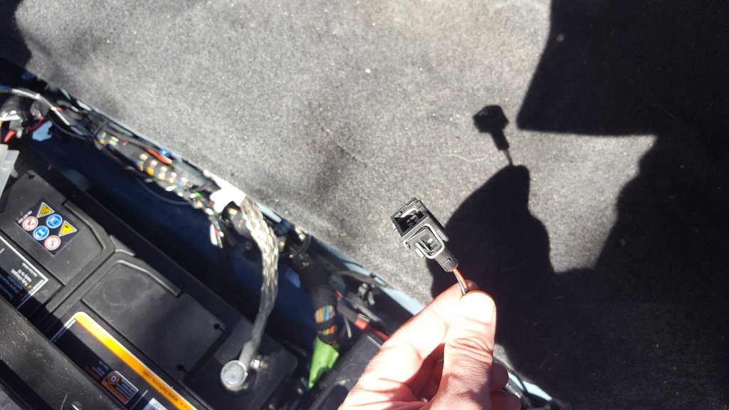

The day after I took it home, I came out to find it had a flat battery. I bought a brand new battery, but the same happened again a few days later. The car clearly had a battery drain somewhere.
I did not want to mess around having this repaired, as I know sales dealerships can sometimes mess you around with this sort of thing. So I returned the car straight away.

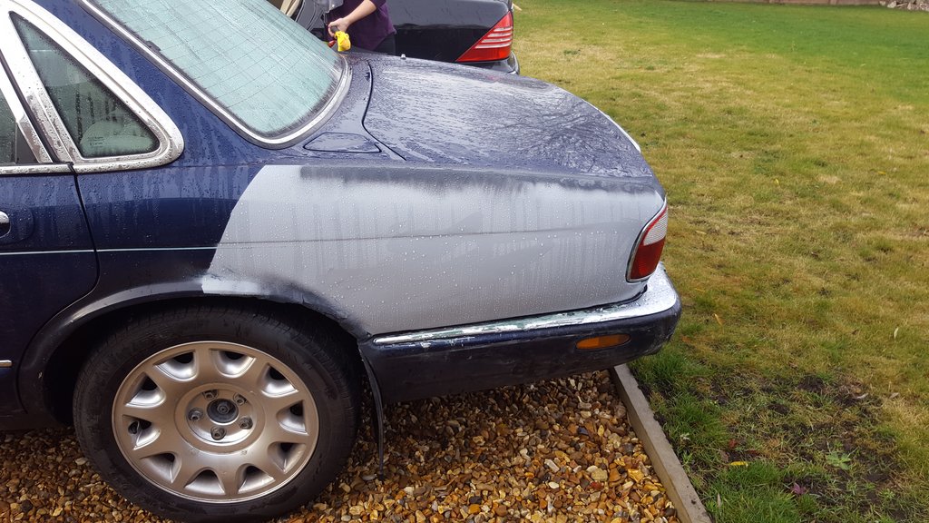

This was the state of the Daimler on the 5th April.
Then finally seeing some paint, this was the state of it on the 19th April. I was overjoyed to see some real progress, and what had been painted appeared to be a good standard.

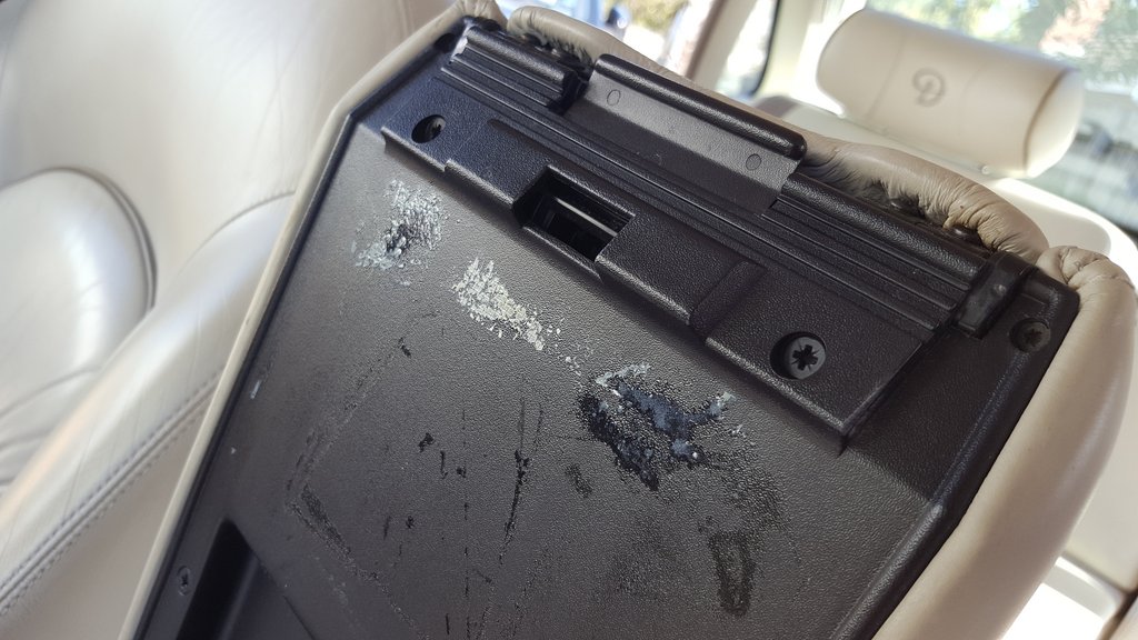

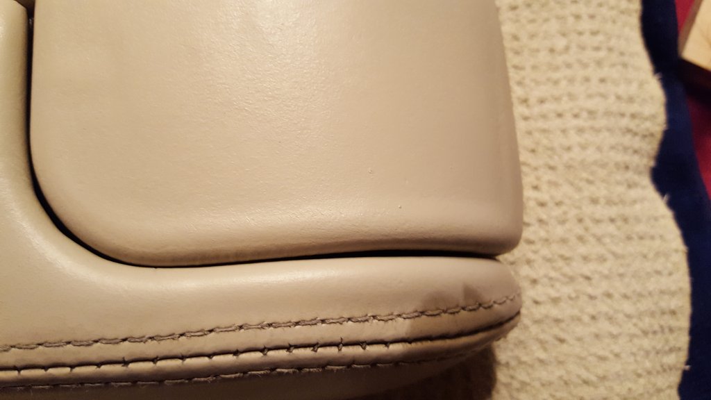

The front center armrest i restored needed doing again, as they had scuffed it up.

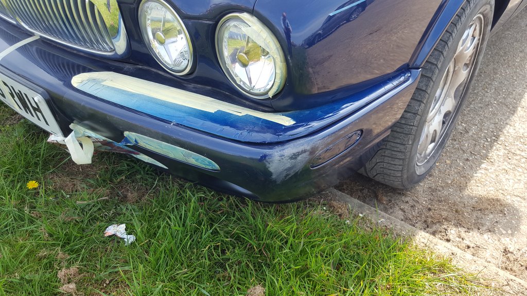

Front bumper clearly did not have the re-spray it was supposed to have.

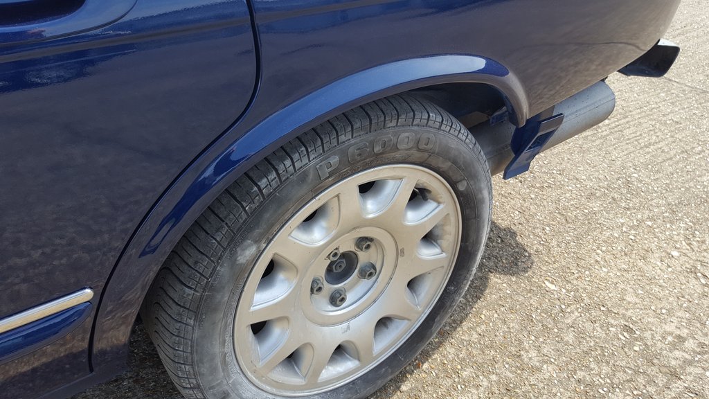

On the 28th April 2018 I was eager to get on cleaning and sorting out the Daimler. But sadly there were 60kph winds, and I did not date leave the doors open.
So I started on the wheels and ended up with this.
The following day I removed the other three wheels and did the same thing, one at a time.

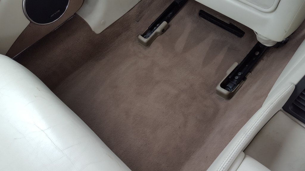

Then I gave the whole interior a scrub, and a thorough clean! (sadly I did not take many photos...)

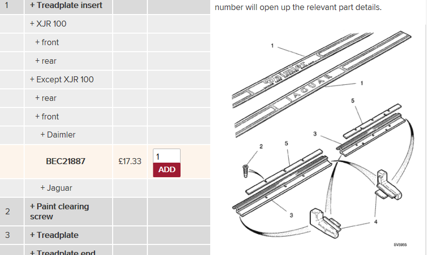

I also found that the front treadplates are pretty reasonably priced, so ordered some new ones.

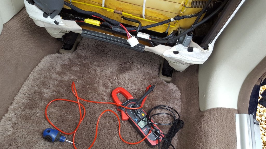

I also investigated the drivers seat, because the seat back was not going backwards/forwards, and the headrest did not go up/down.
The head rest had just come unpopped. I clicked it back in and that was it sorted.
Found the motor that moved the backrest forward/backward.
Traced the wiring back under the seat, to see what powered it.

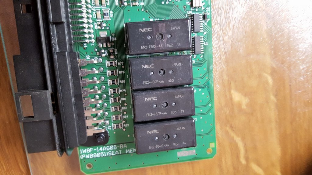

It was this box of relays.
Remind me who owned Jaguar in the 1990's?
One of these relays was not operating.
Rather than sod around de-soldering it and replacing it, I ordered a used module on Ebay for £25.

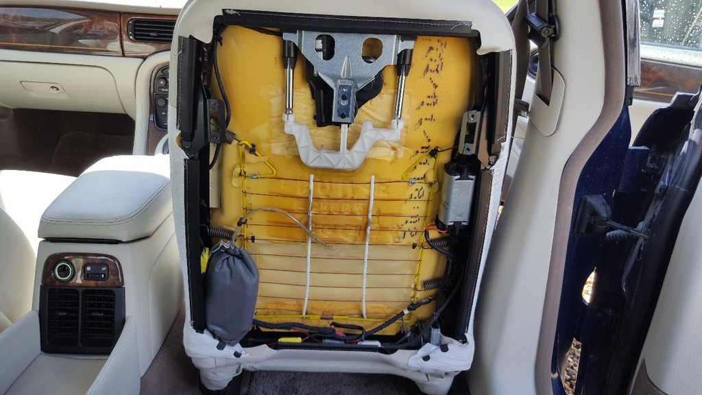

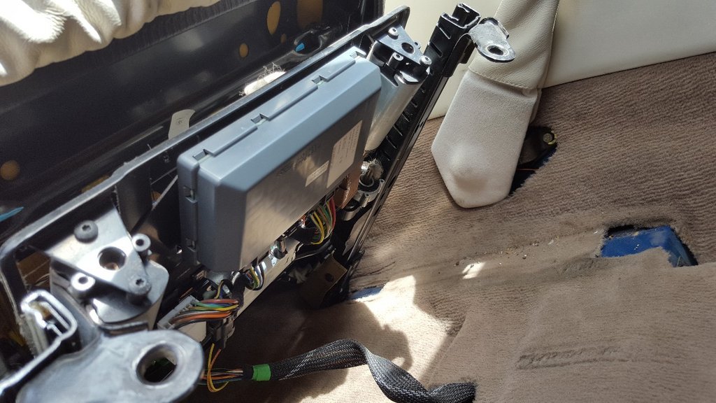

A big clean
On the 12th May I did a big clean on the Daimler, as we were due to take it to Cumbria (West of England for) and put it in a car show.
I fitted the control module under the drivers seat, and was pleased to discover that fixed the issue perfectly!

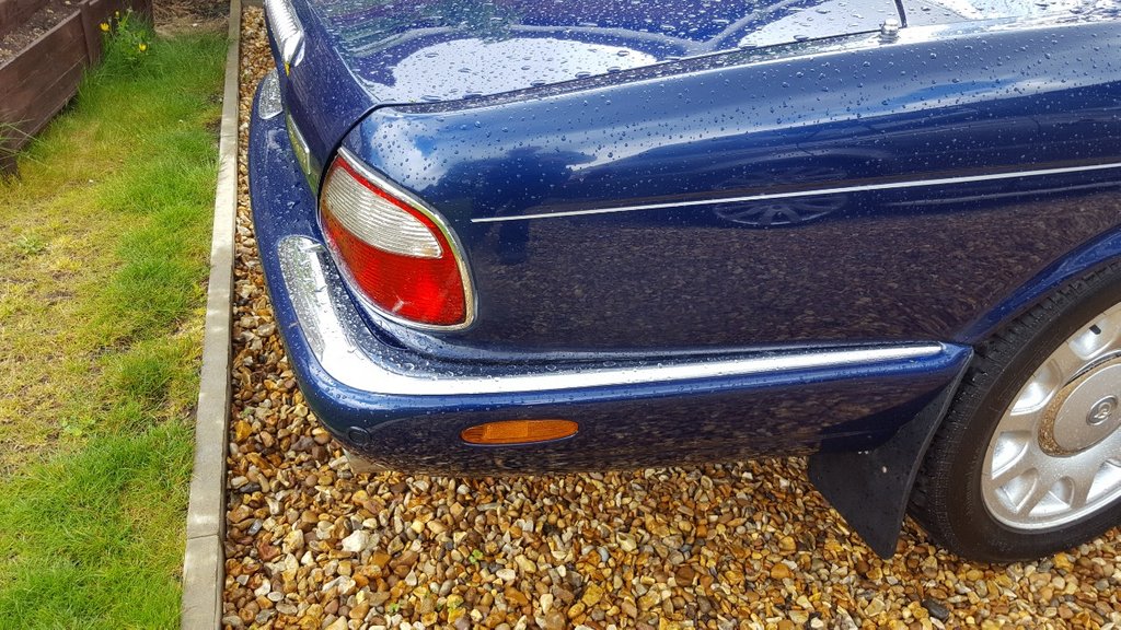

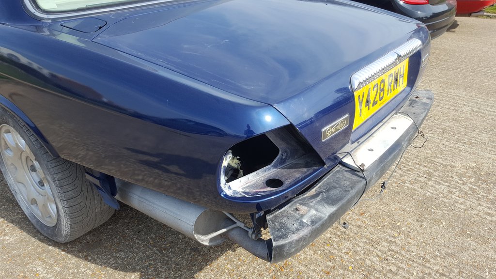

I was peed off to realise the bodyshop had damaged the read passenger light trim when they did the body work. But I remembered seeing this light caked in body filler, so I was partially expecting this.
This rough surface is on the newly painted rear bumper. Shoddy work at its worst.
Dull spot where body had been wet-sanded and not compounded. There were lots of these that I had to sort out.

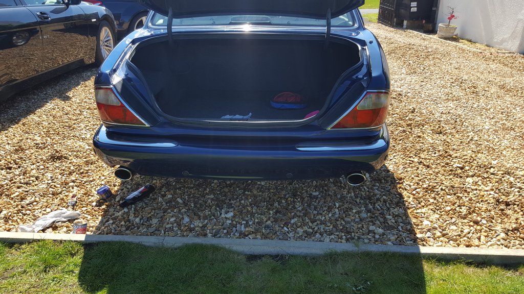

I managed to straighten the bumper brackets out, so that the rear bumper was sitting straighter.
I fitted the new parking sensor bracket (but it needs painting). At least I have working rear parking sensors again.
Highly polished the chrome.
Cleaned up the tailpipes, these were actually this bad when it went into the bodyshop.

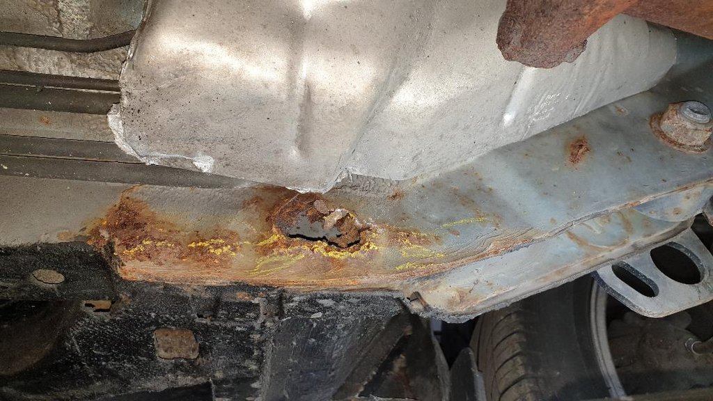

I was also going to sell the Daimler, but it needed an MOT, which had ran out the tail end of 2019. So I booked it in.
Sadly... it failed... this is what the MOT tester found:
The front spring pans were badly corroded:
There was rust on these sticky out parts underneath:
These rear subframe brackets were badly corroded:
I managed to find somewhere online to purchase refurbished brackets (these are no longer available new), and I had a conversation with J-Cat (Jaguar specialist) in Norwich. They said go ahead and order the brackets (one less thing for them to source/find) and agreed to do the work/welding.
