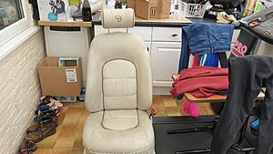

I helped Aston get the seat out of the Peugeot.

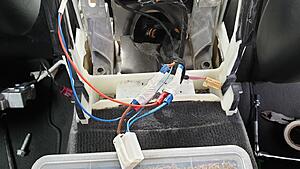

Aston narrowed the fault down to this burnt out connector. Putting a multimeter across the actual heating elements, they measured around 6 ohms, so they seemed OK - and most importantly not broken!
A bit of web research, and Aston found that this is a common problem on Peugeot models of this era. People seem to usually renew the wiring loom.
So it was straight back to work, because Aston had a better idea. We soldered new connectors (cut them from the new Ebay heated seat elements, that we now didn't need).
Did the same to the cables coming from the heating pad in the seat.
Then put the seat back in the car and tested. To our delight its lovely and toasty now! Works perfectly!
Only took a couple of hours...a perfect Friday afternoon job!

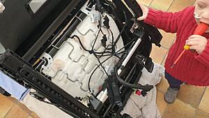

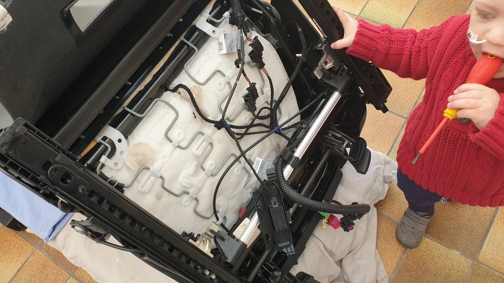

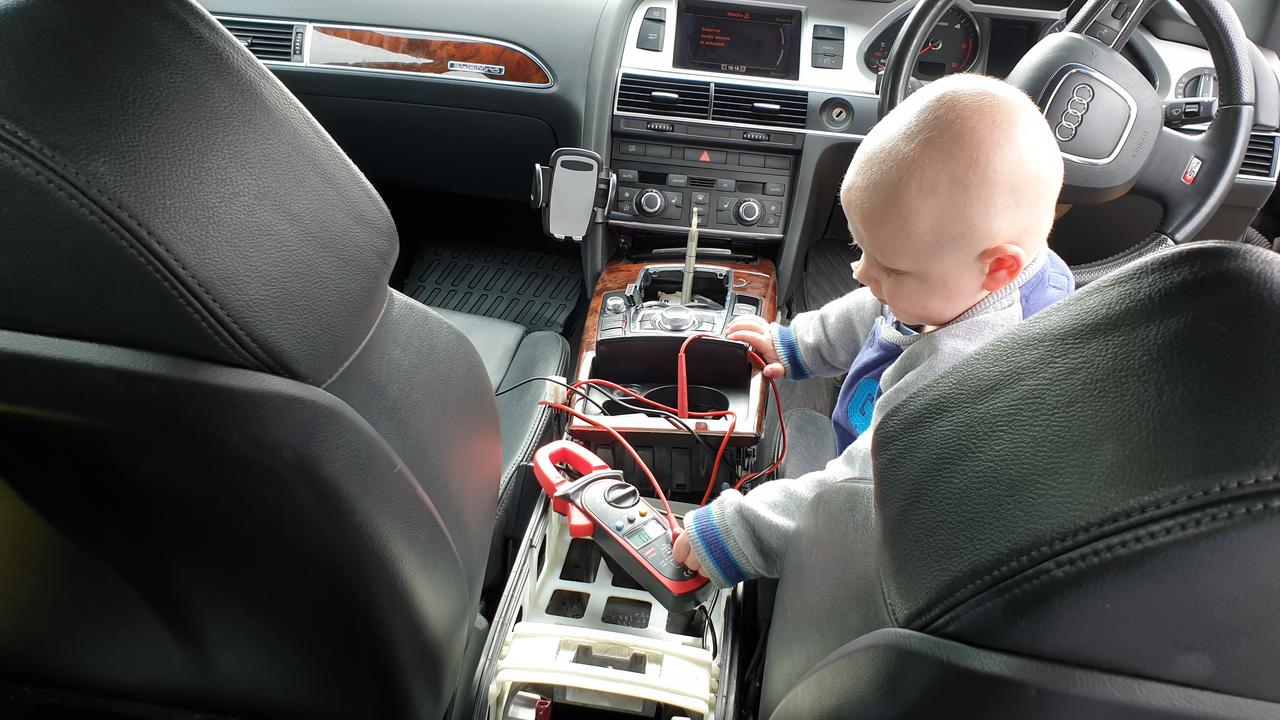

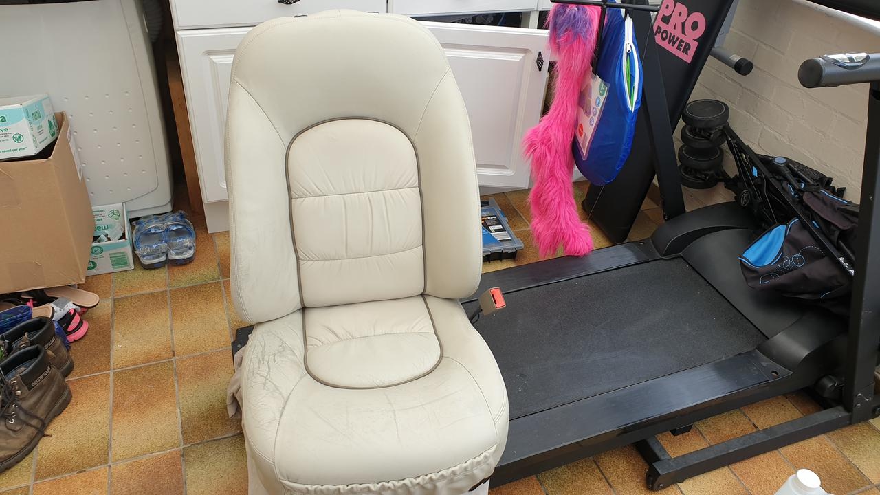

Later on we decided to look at the Audi drivers seat, so try and fix it. Got the seat released (again 4 bolts), and took a look. There is a convenient set of sockets in the floor.
Aston decided best thing was to measure the resistance across the heating element after unplugging the seat. The element measured around 7 ohms, which was great, but made it odd the seat was not working...
So we plugged the seat back in, and measured the voltage to the elements.
It was at only 3mV but every 2 minutes it would jump to 13V and stay there for 10 seconds, before dropping back to 3mV again.
Very odd, I was stumped. But Aston said it must be a control issue, and did a bit of research on Audi's. Turns out the Audi has a Thermistor in the seat. The seat can be set at a variety of heating settings between 0-6. The car then compares the setting with the feedback from the Thermistor, and turns the seat on/off to maintain the correct temperature.
It appears my seat thinks its reached temperature when it hasn't. Assuming the Thermistor was up the spout, Aston dived in and pulled the seat apart, so we could investigate.
We found the Thermistor at the back of the seat base cushion.

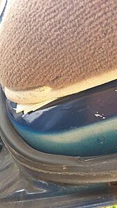

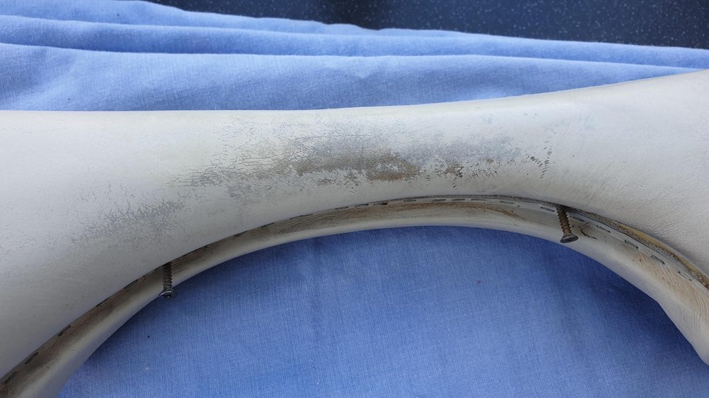

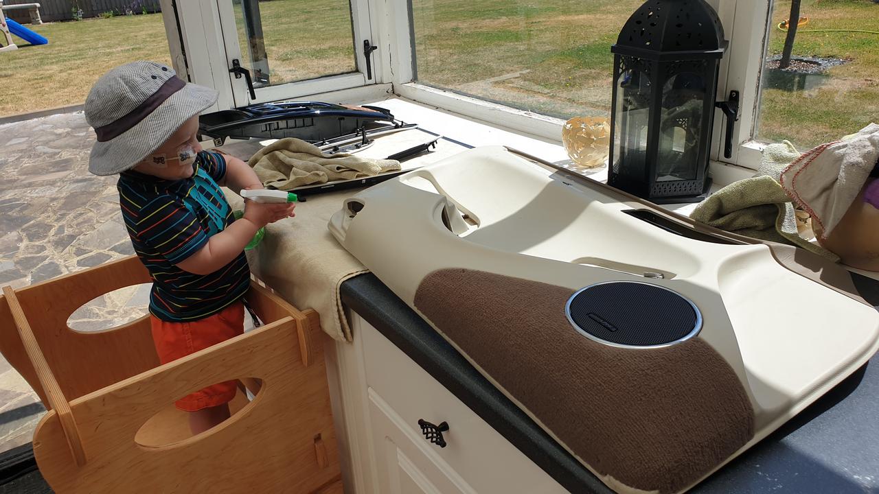

This patch on the drivers door armrest was really annoying Aston, as it spoilt the appearance of the car.
There is also a load of sticky foam and tape that worried him. So peeled the duct tape off and this is what was left.

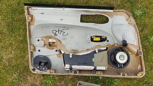

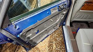

Astons intuition told him that someone had probably broken the clips that hold the door card on, then used tape instead...
We removed the door card, and Aston was right; half the clips were either broken or missing.
Everything was removed from the door card, to best clean all the components.
Then inside we cleaned it using leather cleaners from Autglym, Dr Leather, and Meguiars...
All the little bits got a clean.
It took ages with a combination if Meguiars super degreaser, some leather cleaners to get what we did.

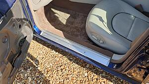

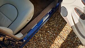

So later than day, 8th May 2020, we returned to the Daimler. After removing the drivers side door card the weekend before, it was easy for Aston to remove the other three (with my help of course).

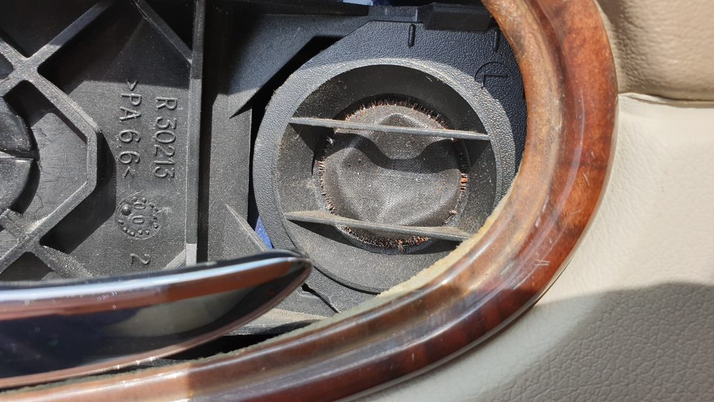

Found this tweeter was looking damaged and in need of replacement.

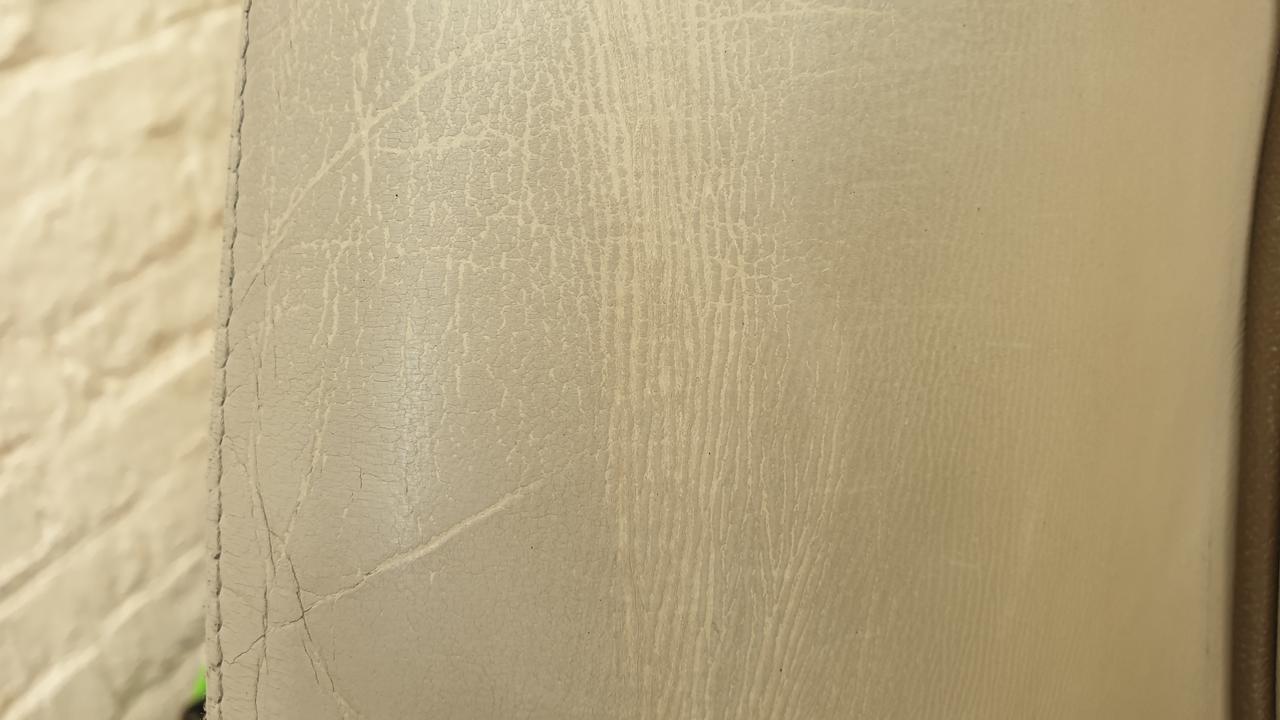

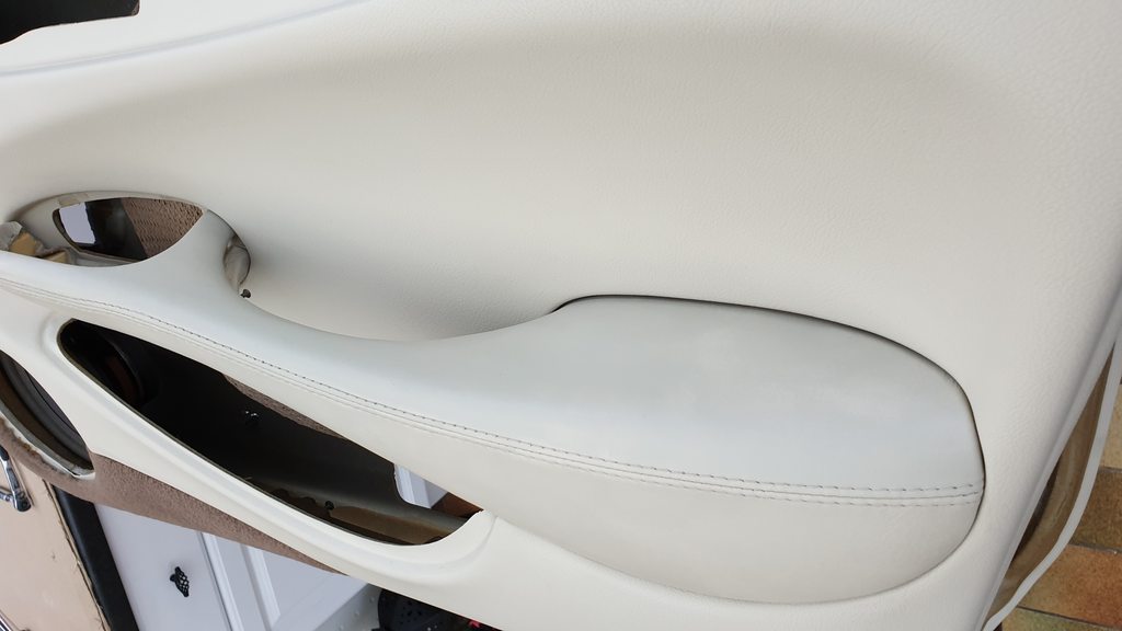

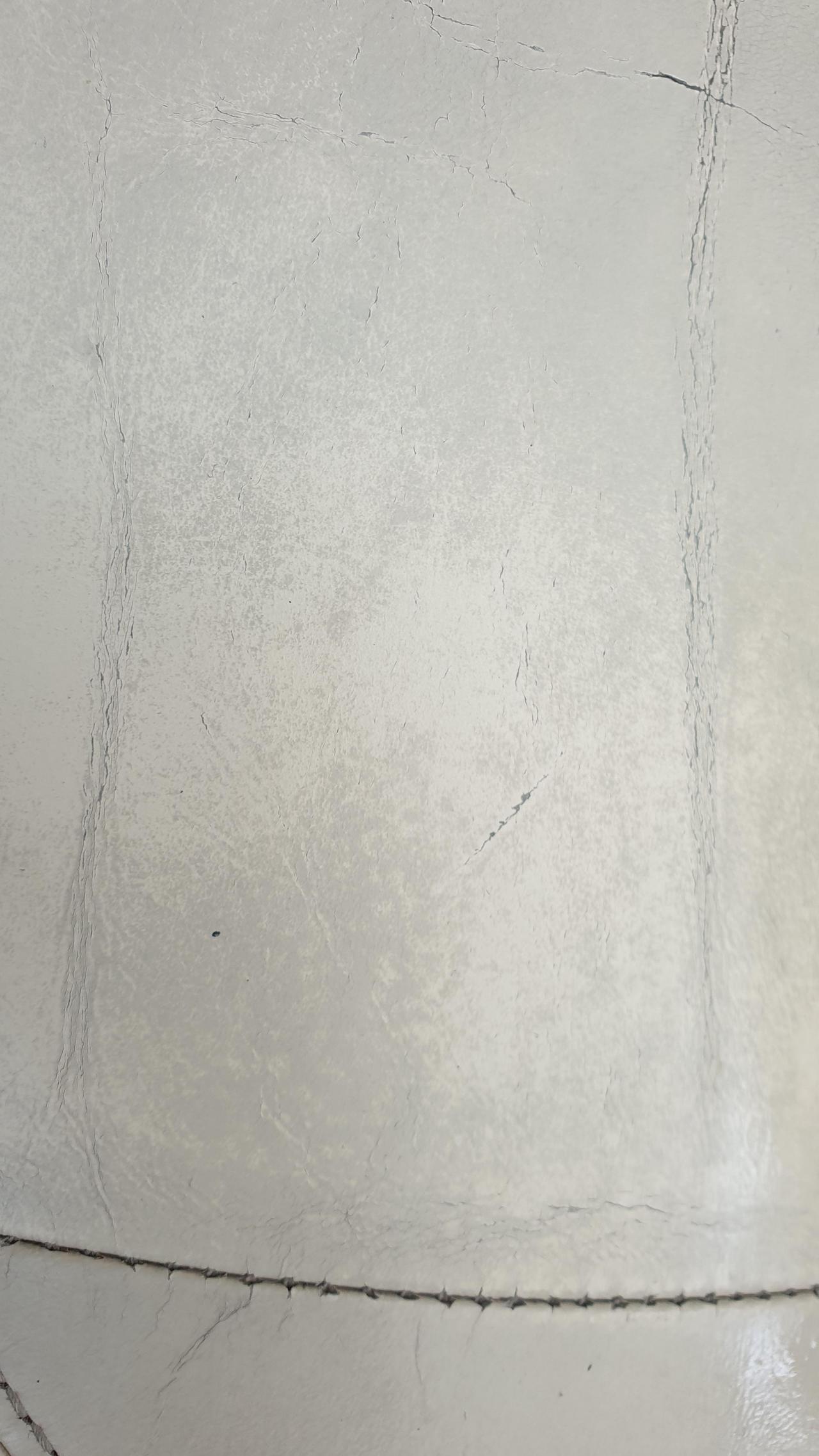

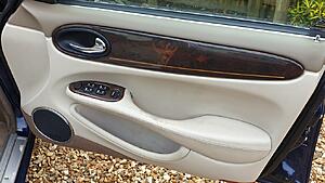

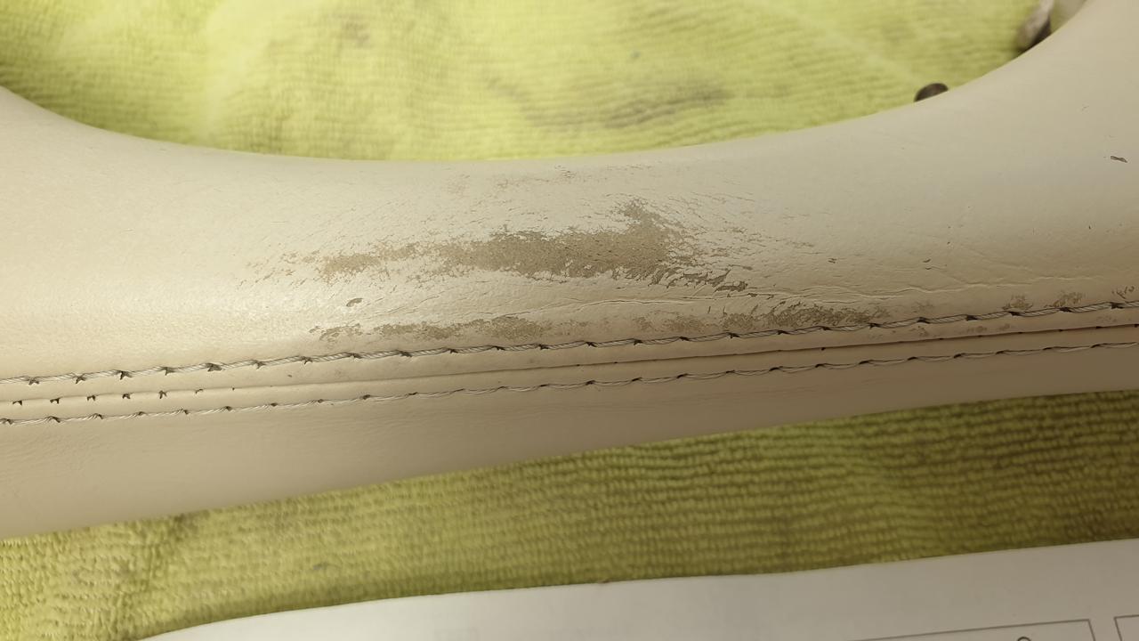

Then with a lot of pressure from Aston, I helped him to look at that awful drivers armrest:
Thoroughly cleaned it down, then used my gliptone kit to re colour. This was it loose fitted to the door card to ensure colour match.
Much better, but needs another few coats.
So this is the finished article (before/after shots):
It was only supposed to be a quick cleanup, and a survey of how bad it was under those door cards. So I was really pleased we made such a massive improvement.
80% better than it was, and both Aston and me were relieved to see there was no major damage underneath.

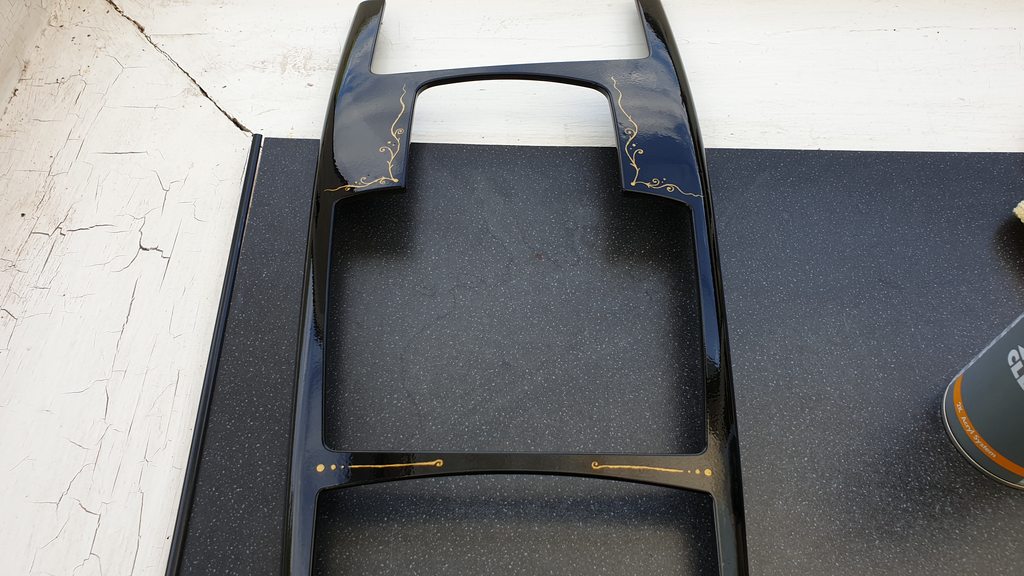

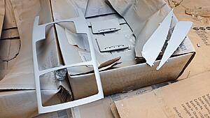

Dreaming of Walnut

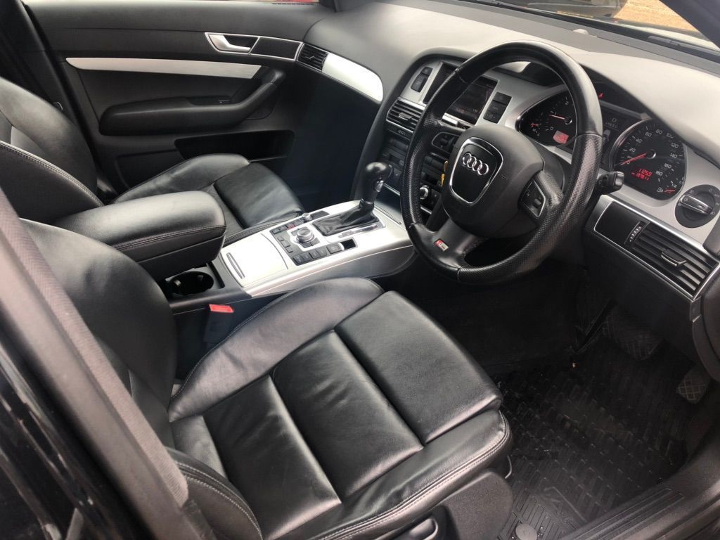

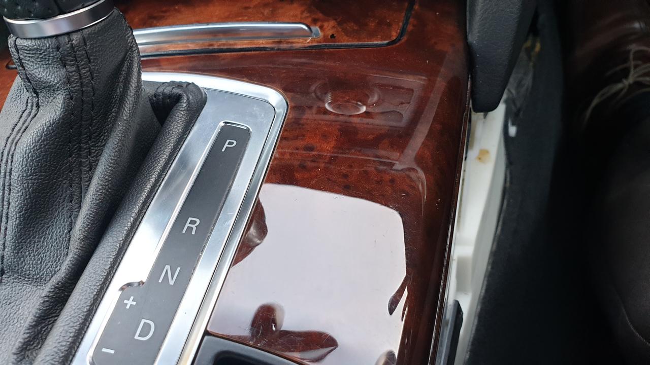

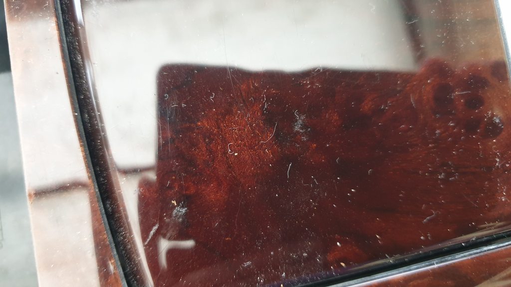

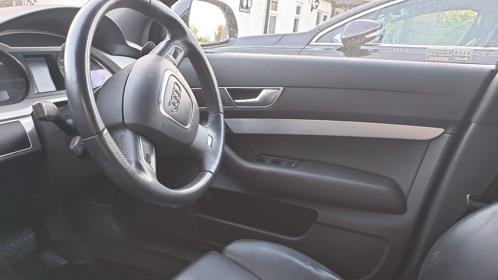

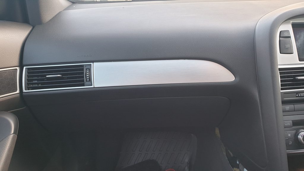

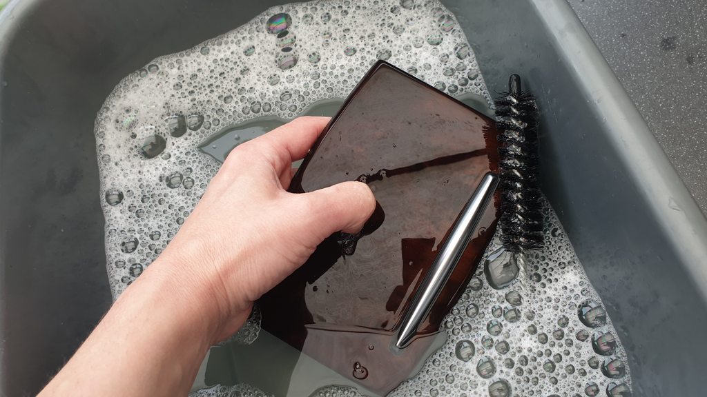

This is the standard "brushed aluminium" trim in my Audi. Standard figment on the Le Mans edition, and I hate it...!
I have always loved walnut in my cars, and seeing as it would cost over £100 to buy all the used walnut pieces to change mine over to walnut, I had the bright idea to Hydrodip them (water transfer printing). Aston had to sit this one out as there are dangerous chemicals involved.
So this is the trim all primed an painted.
So that part went well, but when I tried hydro dipping I was less than successful...
So hydrodipping is not easy at all.... plan B it is then... I'd considered piano black, and I had some black paint, but I thought all that black would be a bit plain. So I tried a gold detail. This is it after lacquer.
But I didn't like that either, too corny... so plan C?

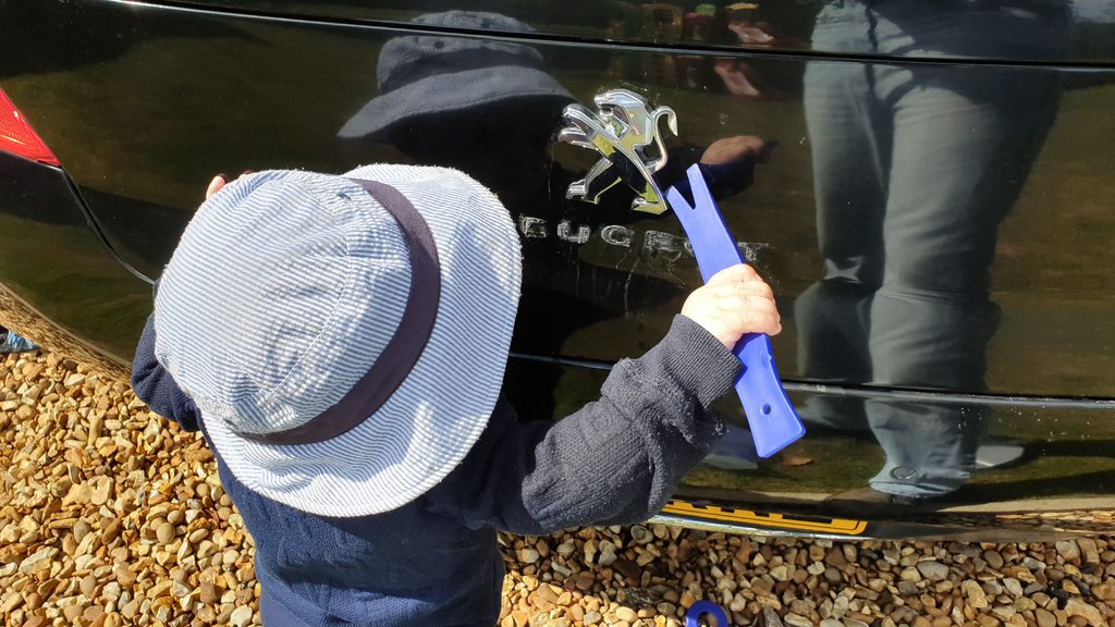

Back to Aston, and he was unhappy with the figment of the rear badges of Mummy's Peugeot.
They were not straight, and appeared to be stuck on with black Mastic, and the car has clearly had some paint. Guessing a bodged repair. Who knows what hidden history this car had!
So Aston carefully removed the badges.
So then after thorough cleaning to remove all that mastic glue, I helped Aston to machine polished the panel to bring it up a bit brighter. The paint job is not the best and it was still a little dull, but better.
Only had time to fit the main badge, the Peugeot lettering ended up never going back on... we no longer have the car but the letters are still in my "bits and bobs drawer".

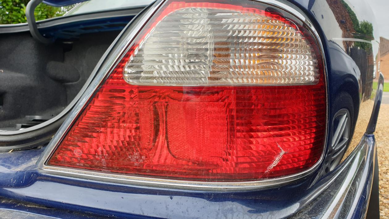

- New rear drivers side light, mine has crack in plastic lens.

A nice walnut upgrade for the Audi
On the 22nd May 2020, the used walnut trim set arrived for the Audi. I snapped it for £60 posted, it was just missing the passenger side rear trim, which I have acquired for £15 elsewhere.
The state of it explained the low price...!
Luckily the broken corner here would be covered by the plastic trim when it is fitted.
So removed all the trim, and cleaned thoroughly.
Aston polished it all up with Meguiars ultimate compound.
So the it was goodbye shiny aluminium trim:
...and hello new Walnut luxury!
Strictly speaking, the Audi was not a Quattro so the dash trim was wrong, but I did not care. The Quattro logo actually looks really nice.
I put the interior back together completely.

On the 23rd May, I assisted Aston to clean up the drivers seat.

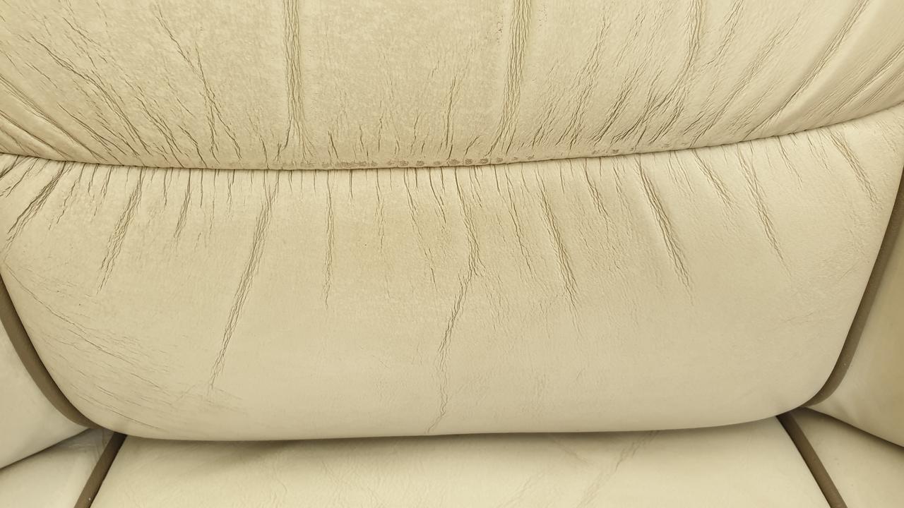

We decided to wet sand the base cushion, but the finish really was really shocking. We knew it would be very difficult to paint the rouched parts. I was suspecting new leather might be needed long term.
The next day we attacked the rest of the seat with cleaners again. Mequiars super degreaser seemed the best thing.
I just cannot understand what has happened to this car in it's life, these are the dirtiest, most ingrained with grime I have ever seen in my life.
This was a scary time, as we were not sure if the original leather dye was coming off or not - and in some places it did... But Aston is fearless when it comes to these things, and assured me he knew what he was doing. Thankfully I trusted him, and it's all worked out.
So now the seat was clean, wet-sanded down and ready for paint. Here are some before and afters.

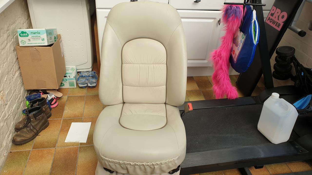

We let them dry out thoroughly, then on the 25th May we painted them. I applied the leather paint with a sponge, dabbing on light coats one at a time, letting them dry then applying another etc.
This was the result.
It's not perfect, as there are creases, it really needed leather filler to smooth out. But it's an improvement that will do for now... although it does not live up to Aston's high standards..!
The colour is not a perfect match either but its closer than what looks to be a previous attempt by someone else.
The car has other priorities at the moment, but Aston thinks a partial retrim of the front seats is required one day.
So here is the seat installed:
Much better!
In preparation for the next step, Aston looked at the treadplates. The drivers side treadplate base was damaged by the monkeys who did the body/paintwork last year.
So it was removed and the sill was cleaned ready for a replacement.
The rear drivers side one cleaned up nicely, took ages to clean all the residue from the old tape off. Used Autoglym Tar remover. Then cleaned with Meguiars Super degreaser and polished up.
Much better!

Daimler door cards
30th May 2020: Aston was eager to start early morning. Straight on to cleaning the remaining door cards.
Some goodies arrived in the week. That's the door card fixings, and two new treadplate finishers from Jaguar. Then a new grommet and treadplate base from Black Cherry Jaguar (a Jaguar used parts dealer).
Had to dye this front passenger armrest.
...a shot during (Aston was too busy for a finished shot before it went into the car.
Could not get this over spray off... so left it for the time being. it's the rear passenger side door card right at the bottom. Luckily it is not really noticable most of the time.

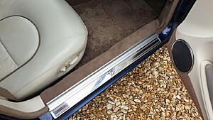

Used double sided sticky foam to fit the tread plate covers.
All fitted and looking much better:
Passenger side door card looks good, and armrest repair looks nice.

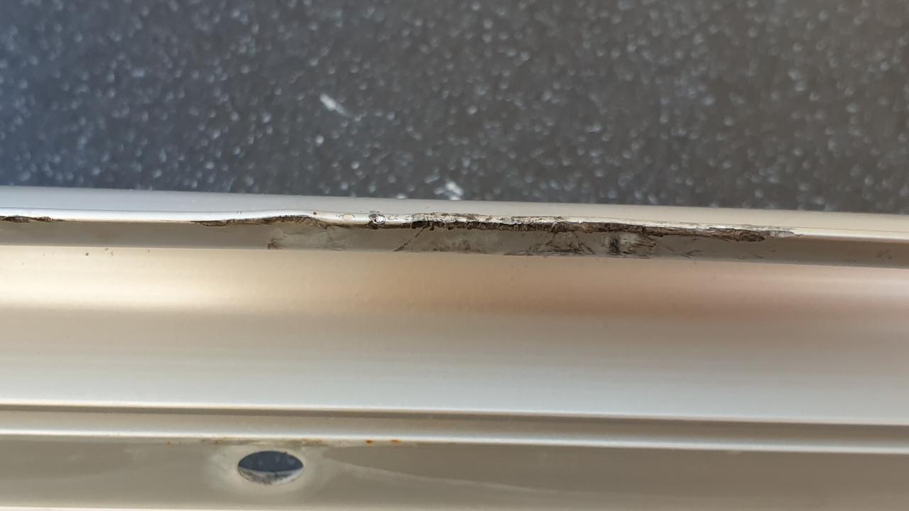

The only downside was that the replacement used treadplate I received from Black Cherry Jaguar was actually worse than the one I had removed, I was not going to use that!
I am being a bit of a fuss pot here, but I don't think this is good enough. I asked for a treadplate in decent condition, and I did not expect to receive one that has been damaged by someone trying to pry it off before realising there are screws to remove... I suppose the chap at Black Cherry Jaguar has a different opinion. That's me spending £32 for just a grommet then....

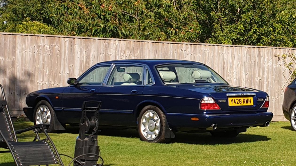

One weekend in June we moved the Daimler off the drive and on to the grass for some photos.
The car really is looking smart now, but there is still lots to do...

I managed to buy a used driver side mirror off another Daimler Super V8. These have to be powerfold, and Electrochomatic, which is rare on UK spec X308 models.
But unfortunately, as with pretty much every one we see, the mirror glass was a stick on piece over a cracked original.... so we still needed the glass!
The glass is £200 new from Jaguar. I even saw some clown trying to sell a used and clouded/corroded one for £200 on Ebay (what a prat...). But then we sourced one for £86 BRAND NEW, on Ebay.

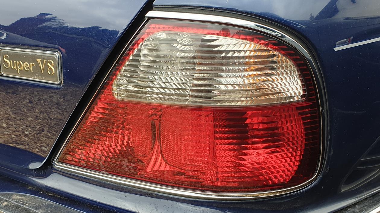

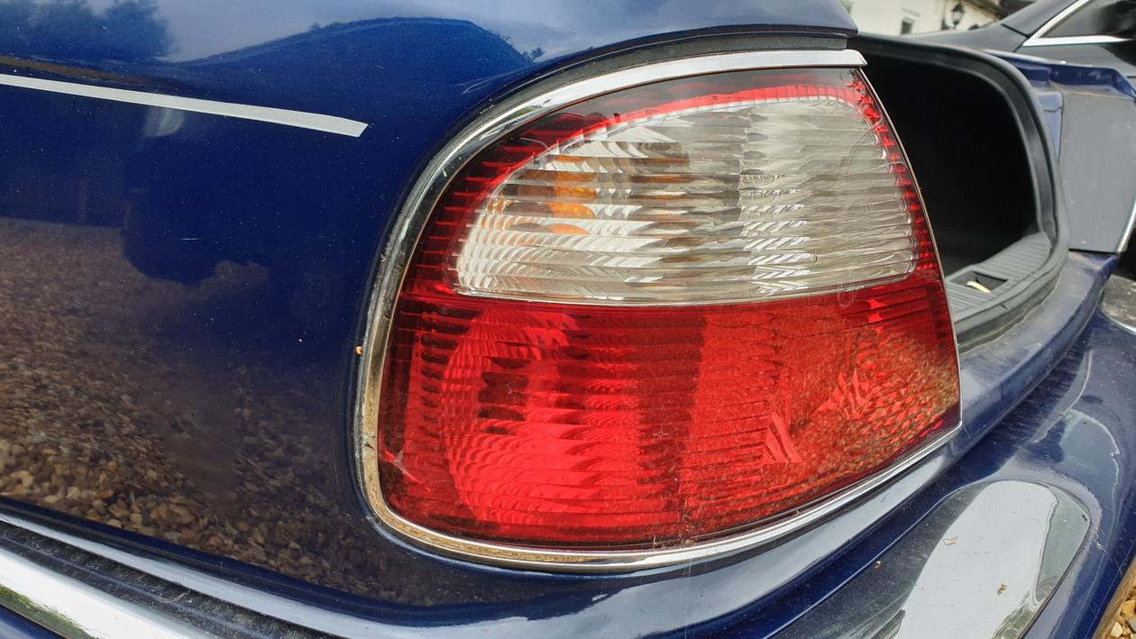

Then we attended to the rear lights on the Daimler. Both were damaged. The right one has a nasty, and badly repaired crack.
...and the left side on has damage to the chrome thanks to the idiots at the bodysuit, and a crack too.
Managed to source an "as new" pair from Ebay for a bargain £60.

The following day, Aston and me tackled the Daimler drivers side sill, that we were not able to do a few weeks back as the sill plate was damaged.
Some may remember mine had been damaged by the bodyshop, by them trying to lever it off. I then ordered a replacement from Black Cherry Jaguar spares, and it turned up ever worse - and absolutely filthy too!
So then I bought a whole set of four from Simply Performance Jaguar spares (I got a set of four, for the same price as just one from Black Cherry!), and thankfully this time I had a result. All four were in nice condition (not immaculate, but these are 20 year old cars!), just a few scuffs, but most importantly no physical damage. They were also nice and clean.
Aston picked the best one, then fitted it on.
Then Aston very carefully fitted the stainless steel plate cover - and completed the satisfying task of removing the protective film!

Adaptive fast charger
Then I started work on a charge cable I could route to the bracket when it arrives.
Pulled apart my fast charging adapter.
Soldered in some new power wires.
Then poked them through the case, and put back together.
All taped up and ready to go in...
So back in the Peugeot, I hacked into the cigar lighter socket power, and ran a charge cable out.
Just need the bracket now!

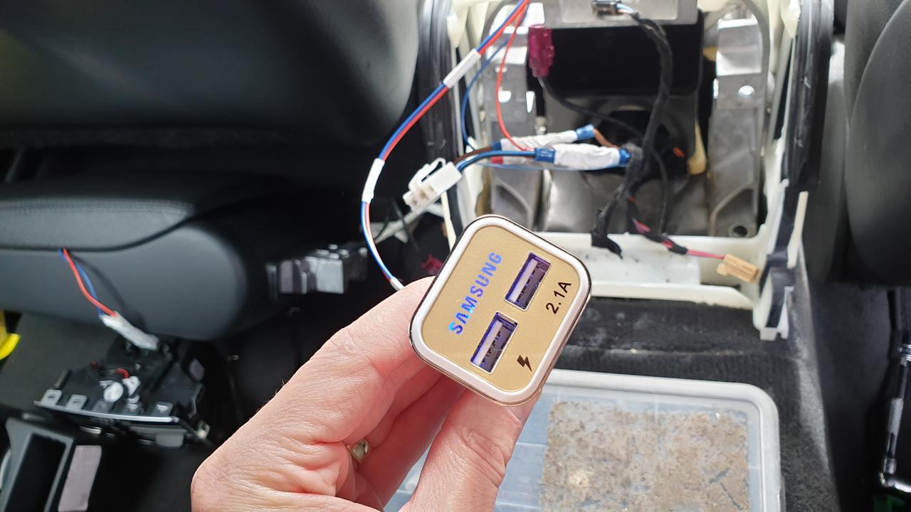

Audi fast charge!
Following the success of the fast charger installation on my wife's car the previous weekend, Aston was kind enough to treat me to the same thing in the Audi. So 18th July we pulled the Audi centre console apart.
We made up another lead out of a second Samsung fast charger. Then hacked onto the power circuit in the Audi to install it.
Ran the USB cable up to the front of the centre console.
Then put everything back together, and this provided a convenient charge cable below the bracket to fast-charge my phone... Excellent!
Thank you Aston!
