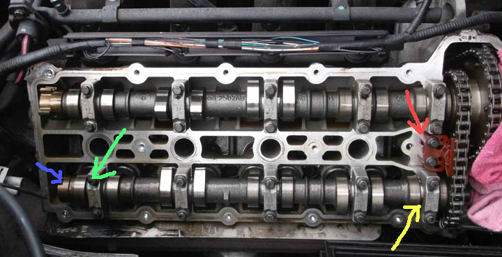

I was taking pics pretty well all along but didn't, understandably, take many when things started not going well. There isn't a whole lot to see in the pics I took but I've attached two.
At one point I did have all the caps removed and the camshaft was just sitting there and I nearly freaked when I saw a roughly 1/8" gap under the aft end, so I wasn't into photo shooting at that moment.
In the first shot there's the closeup of the problem area. You can see the black lines I painted on the cap nuts. Some of the lines are hard to see in the pic as they started to get worn off and were reapplied later. The lines were horizontal before I moved any bolts, and I went in flat by flat increments. I used Sharpie paint pens I got from an art store, not the regular Sharpies. I used the lines to get back to the torque settings, as I don't trust my torque wrench at that low a reading. A concern I have is that by the 5th time I installed the caps a few of the lines on the bolts had moved a degree or two as the threads are probably stretching. cringe
In the second shot: The red arrow is the red, original design secondary tensioner to be replaced.
The blue arrow is the aft end of the camshaft and this end rose up say an 1/8", which is more than likely what is jamming the cam shaft in the area designated by a yellow arrow, which is where the tolerances between the camshaft and the head are very small and thus it tends to jam there. The green arrow points to one of the ten camshaft cap bolts that need to be removed in a way that allows the camshaft to rise straight up in an even, uniform manner. That's the missing part.
You can see in the second pic that the cam lobes near the cam gears are pointing down. That was an attempt to put maximum pressure to the problem area. I even risked things a bit, put a little extra pressure on that area with those lobes when removing the cap bolts than I would have liked, and I'm very uncomfortable putting stresses on aluminum. It's stiff and breaks easily.
In the second pic you can barely see the zip ties. I used two because I have had them fail and that's the last thing I'd want as I was lifting the camshaft. The zip ties are way down there, and that's because I was leaving them in a position so that I could still rotate the engine a few degrees after I'd loosened the caps a bit and hopefully cause the cam lobes near the gear end to force the camshaft out.
The whole thing gives me the heebie-jeebies. I couldn't be more uncomfortable with coaxing stuck fragile parts. I have no qualms installing windshields, dismantling steering columns or doing any repair to the iBook I'm using to write this, but there is a common sense you acquire, much from screwing up, and mine told me to back off.
When I retightened the caps to try a different position I'd turn the engine over a few times with a socket on the crankshaft to make sure that the camshaft was indeed seated normally. The engine was easy to turn and the engine is a low mileage (56k) good running unit.
Attached Thumbnails Camshaft won't budge-rh-side-closeup.jpg   Camshaft won't budge-rh-side.jpg

FWIW, when I did mine, I lined up the lobes so there was as little upward pressure as possible on the cam shaft.
I think you may be putting it in a bind by having the lobes put upward pressure on the shaft.
Mine came up with a simple tug.
The crack you heard when you loosened the cam bearing bolts was the lock tight giving way, and you can smell it too when it turns loose. None of the instructions that I saw mentioned this or included any instructions to re-apply the lock tight so I did not do it.

What I did was to loosen all the caps such that there was about a 2mm gap on each all the way across, then used a pry tool to lift up the cam at both ends, thus lifting it without significantly changing the angle which I think is the cause of the binding. Then I'd back the caps off a little more and repeat. I actually figured out this trick on a straight 6 Toyota engine before and it worked on my Jag too.

The initial attempt I made was after I'd rotated the engine so the cams were like you say, exerting as little pressure as possible. That seemed like the most gentle way to ease it up.
Then I tried it with pressure in the middle and also with pressure on the gear end, and I knew things were going bad to be thinking of unequal pressure tactics like that, but that's how the XK8 guy got his to come out.
It seemed like my cap bolts had nothing on them. On head bolts that I've used Loctite on, they could be removed very smoothly, like butter. I would have thought that anti-seize, like you use on spark plugs going into aluminum heads would be the best thing for the cap bolts, but used sparingly as it's abrasive.

As said by SeanB a careful tap on the rear of the cam would have loosened it.

pdulpler I did try using a wood drumstick as a lever but for a fulcrum all that was available was the thin edge of the head. I pried ever so gently but couldn't exert any force to speak of... it felt like the risk of damage was too great. And I did try what you said - make a tiny gap under the caps and then try to remove it.
avos, I'm not sure that tapping the end of the cam would have helped. It needed to go up, not sideways. I see what you mean though, that it would jar it free, and I did tap gently with a tiny hammer and some wood as a pad.
What can I say but that it was jammed in there harder than I was comfortable pushing it any further than I did. No matter what way I tried it felt like the rear end wanted to go up and the gear end wanted to stay down. It was jammed in there so hard that it felt like almost for sure if I pried it out that something would have been damaged.
I guess that's why I didn't take it apart today - I don't see any other way I could try it that would work any differently and it feels like there's a very real chance of stripping a thread, breaking the camshaft or the head.
It seems like using the original factory "non zip tie" method would be for sure the safe way to do the job, at least in my case. If nothing else, it would be stress free compared to this. Holy smokes, I've done massively harder stuff than this with little stress and yesterday I felt, for several hours, like I was moments away from owning a parts car! I really don't know one thing I would have done differently.

Have done several engines, and it was always the same. Where it comes loose at the end you hit it downwards to the engine (not sideways), that loosens it straight away.

I've had a think about your tensioner issue - how does this sound?
When you turned the motor you put enough oil pressure in the secondary tensioners to cause a bind. Can you slacken the tensioners away from the head and let the oil seal go - with the tensioner/chain loose and cam lobes off the valves the cam should just lift out.

You need not worry about retightening the cap bolts damaging anything if you only snug them down during rotation.
There is *one* position where no lobes apply pressure to the valves. That should be your starting position. You will need to reposition on each bank.
The part you are replacing is a cam chain *tensioner* whose mission in life is to keep the chain tight. So, you need to slacken their bolts to get some wiggle room. There is also tension from the oil film on the journals. You can also use the retention pins from the new tensioners to keep the plungers on the existing tensioner retracted.
Slacken the caps a bit, the front one a little bit more than the others. Pull up on the front using the gear while doing this. Up meaning perpendicular to the plane of the cylinder head. A little tap with a hammer while pulling helps to break the oil film.

I see what you are saying about the tensioners and it makes sense. I'm too concerned about the electrical issues with the car and will think about the tensioners when that's cleared up.
