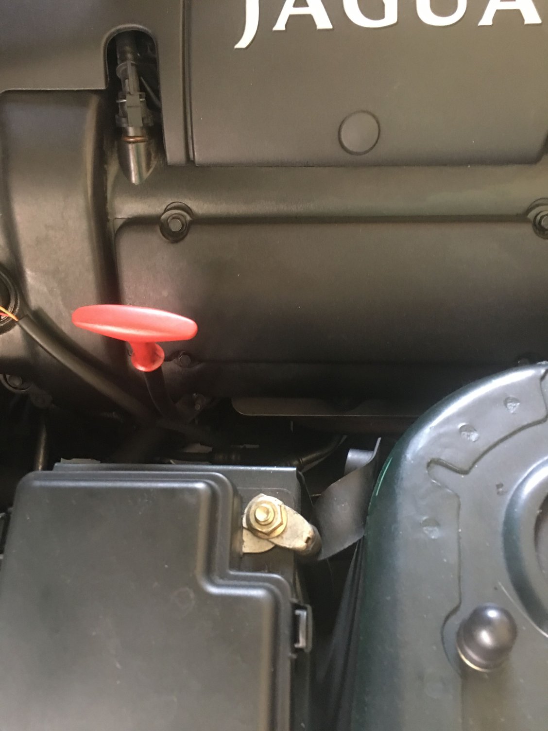

I have a dead battery and I'm locked out of trunk.
Problem is car came with green valet key, no black key; Does anyone know how to open trunk in this situation?
Are there jump points under bonnet that I can use to power-up and open trunk with key fob or switch on dash? Thank you!

Originally Posted by andrew lowe
If you open the bonnet, on the drivers side ( RHD ) there is a rubber cap on the false bulkhead, pull this off the stud and you can put a positive jump lead to it, the negative jump lead to the chassis and this will let you open the boot. DO NOT try to jump start the car this way.

Thank you will try when I’m home

Worked with jumper cables. Thank you!
