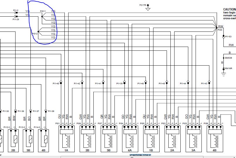

Ignition primary winding common signal for the driver's side bank of coils could be compromised. If I recall, all four on each side come to a single point in the harness, different for each side - see blue circles in pictures from electrical diagram.
One of those two connections could have failed - I don't know which is passenger or driver's side - but they each have two connections that can fail - one shown in the right in the 2nd pic below and the other over to the left at the engine control module in the same pic.
A failure of either of these connections OR a failure in the engine control module (less likely) will cause your exact symptoms.
Can't promise that it's NOT a timing slip in a cam sprocket... but this should be checked first! jhartz could be close - not dirty coils, but a dirty coil connection?
