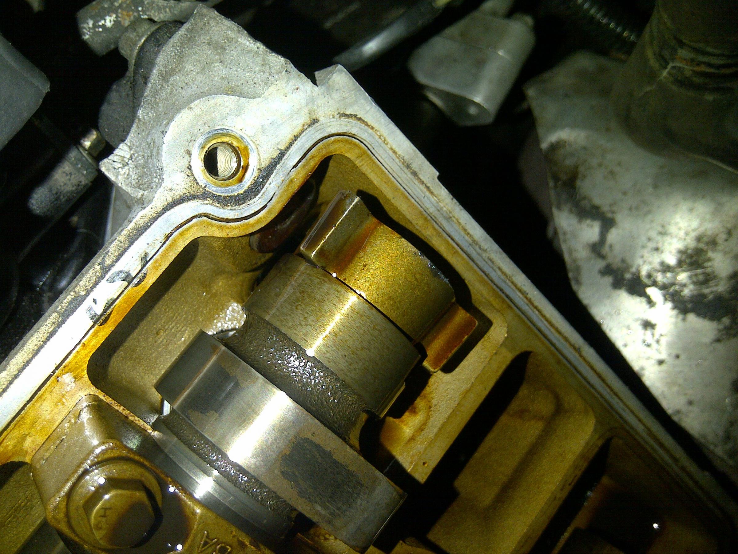

Hey guys,
I need your help: my '98 x308 3,2ccm is currently in the work shop and got a replacement engine from 2001.
The mechanic tried to crank it, but it won't start. The error codes say something like "cam shaft/crank shaft position sensor signal is not plausible".
However, we found the problem, but aren't sure how to solve it. The 1998' cam shaft has one pin for the position sensor and the 2001' has four already, which makes sense, but confuses the ECU.
Is it possible to change ONLY the rear piece from both camshafts (see picture below). And if so, how do we find the exact position of the pin?
Plan B is just sawing off the unwanted 3 pins on the 2001' cam shaft, but I'm quite sure that this is not possible due to the position of the last pin.

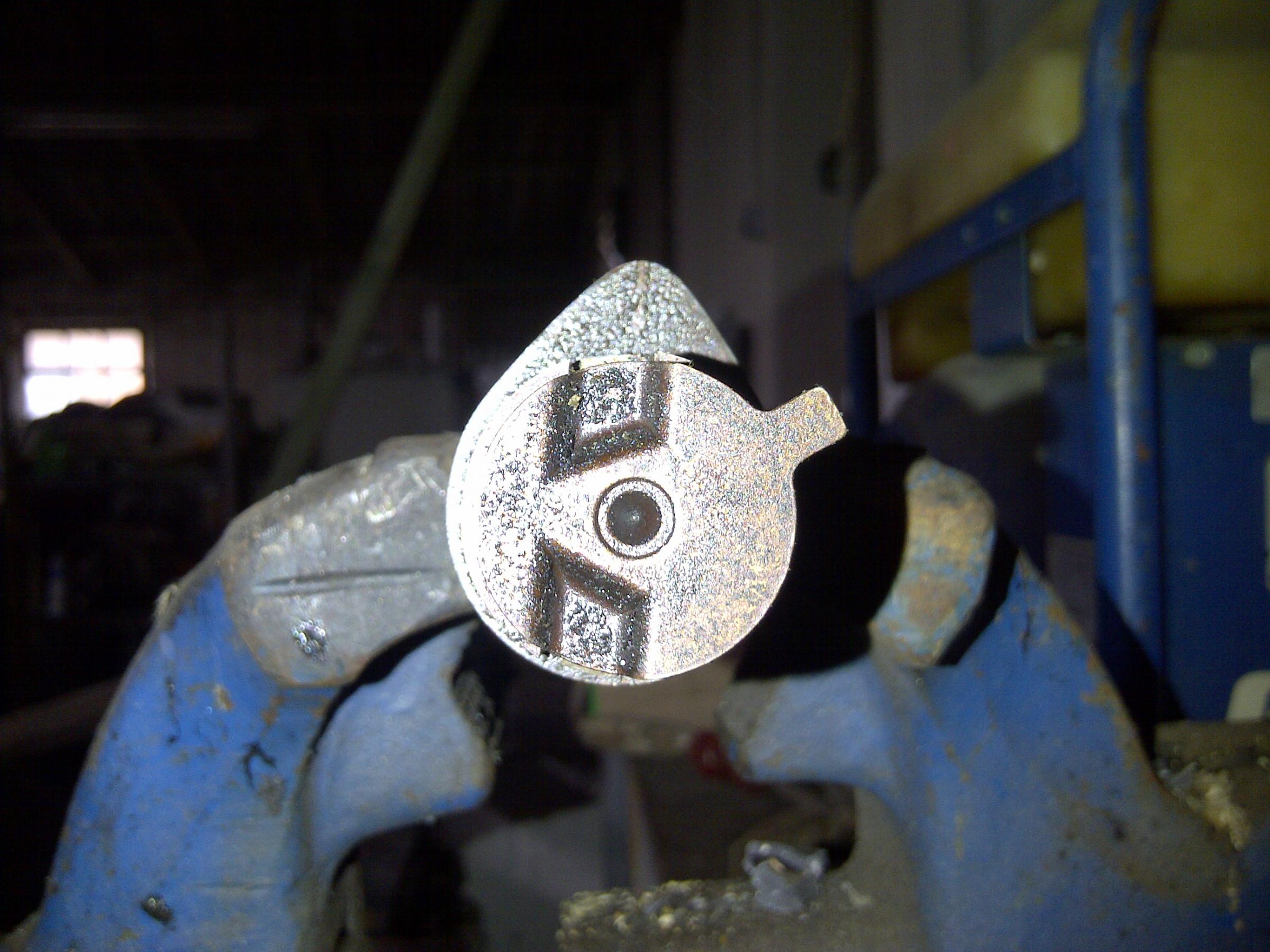

the new cam shaft, see picture below

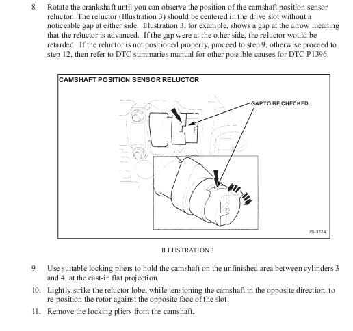

There's a procedure where the reluctor can be swapped and no need to re-shim the valves, using the original cam, I'd be more inclined to carry this out than a laborious re-shimming job. But make sure it's bang on 100% where it should be. JTIS has the process.
All 3.2 have no vvt.
Old Jun 18, 2013 | 07:44 AM
DavidMG's Avatar
Joined: Apr 2013
Posts: 15
From: MG, Germany
That sounds good! I already checked the JTIS, but wasn't able to find anything. You have a source for the procedure?
The only thing I found was this picture below, here from this forum.
Attached Thumbnails Change rear part of the cam shaft-41035d1367119806-replacing-aj26-aj27-head-swap-cam-swap-x52iok-jpg.jpg

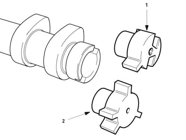

Found that:
Attached Thumbnails Change rear part of the cam shaft-14185d1321129661-how-properly-reposition-camshaft-position-sensor-reluctor-untitled-jpg.jpg
Old Jun 18, 2013 | 08:54 AM
Sean B's Avatar
Joined: Oct 2008
Posts: 4,880
Likes: 1,431
From: Sunny Southport UK
yes that's it David, hope that is of use.

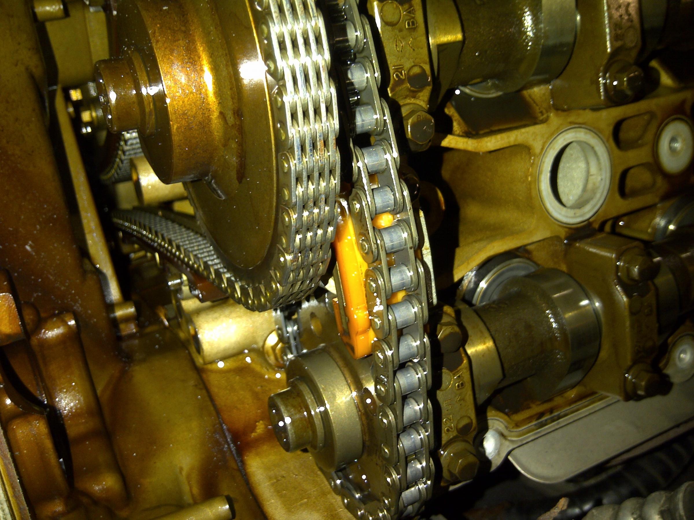

Thanks, that's very helpful! Yes, he's a very careful mechanic
Attached Thumbnails Change rear part of the cam shaft-img-20130614-00307.jpg
