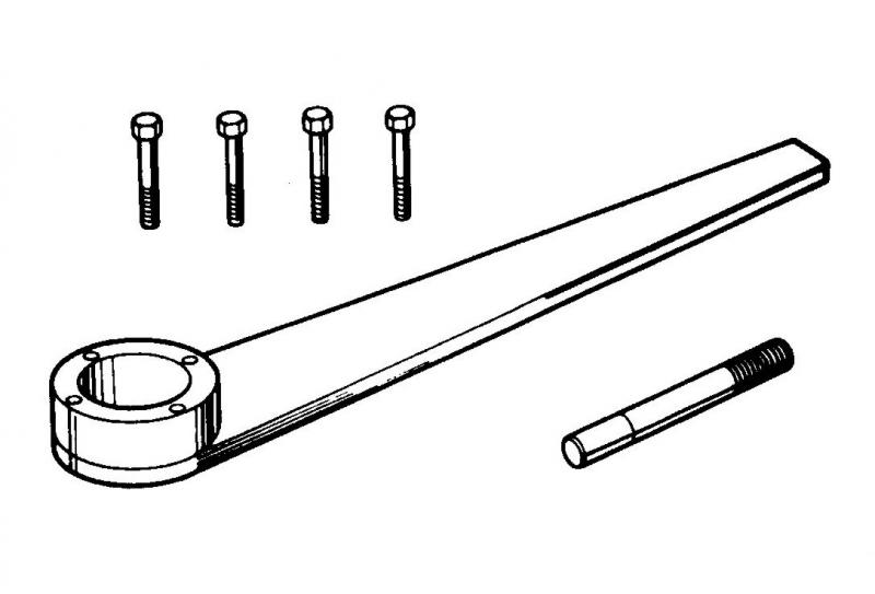

Will you be doing all the timing or just the uppers? The whole job is a bit more involved as the timing cover needs removing and the crank pulley bolt, which can hold up the best of us if you ain't got the correct tools. A pulley puller and pulley locking bar are the correct tools for this job, see images.
First, pulley locking wrench, second is pulley puller, with these it's easy, without it's nightmare...you can buy them from here,
SPX Catalog - Jaguar
or if you're a member of the JEC you can rent them from the club and give Annie Jenkins a call...
