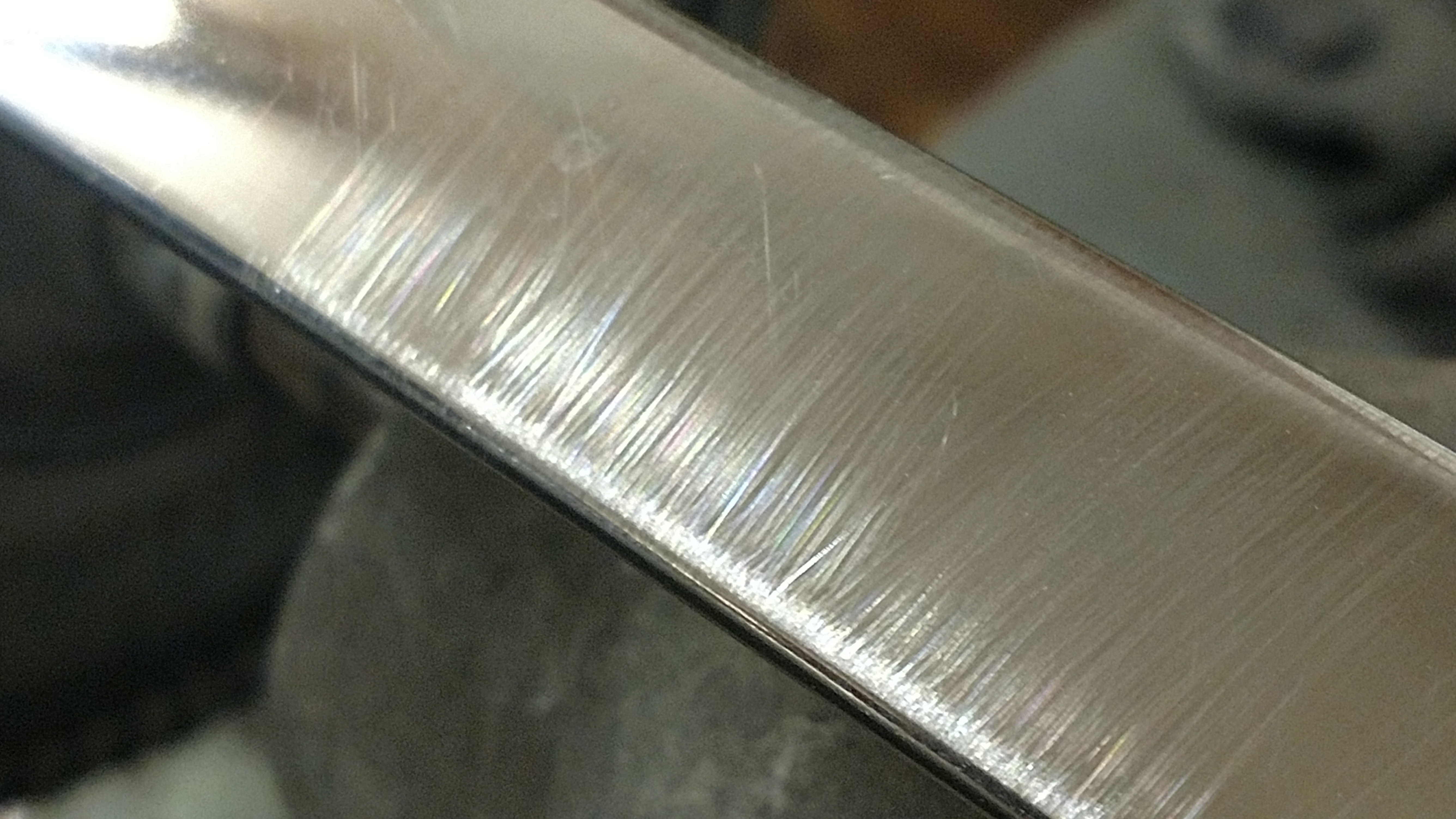

Apparently your not reading in the right places.
Drip rail and window trim on these cars is stainless. NOT chrome.
They need to be machine polished.
Pic here I scuffed the trim with 220 grit paper then buffed them out first with the coarse compound on a hard wheel followed by the brightening compound on the soft wheel.
Attached Thumbnails Chrome Trim.-img_20170628_211629811.jpg   Chrome Trim.-img_20170628_212005343.jpg

How long did that take?

Just went out and did it between posting.
And that include finding the trim in my parts car

Those results are amazing.

You could try this route, but spinning with a hand drill may not be enough rpm but worth a shot.
Stainless Steel Polishing Kit 14 pc Set
Old Jun 28, 2017 | 09:53 PM
convincor's Avatar
Joined: Aug 2015
Posts: 451
Likes: 113
From: windsor, ct
Even just look in McMaster Carr.
Polishing wheels and different compounds are there with explanation of the best uses.
