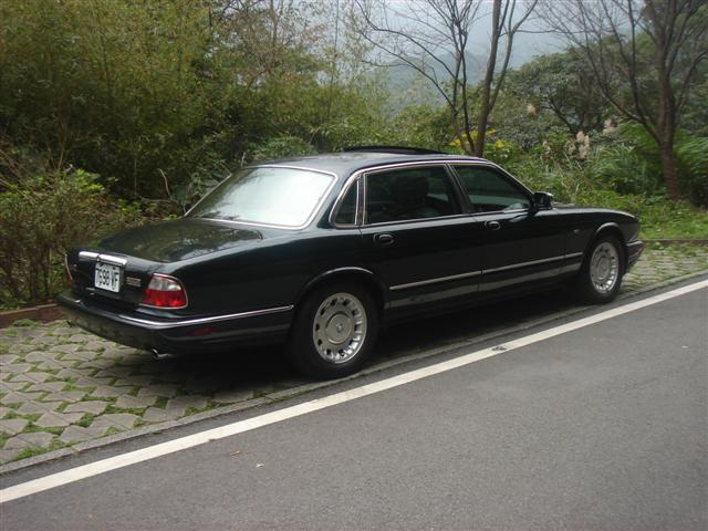

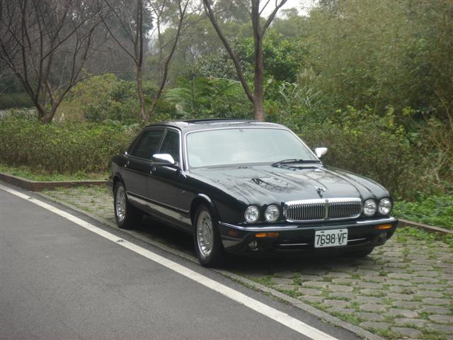

Seen several, now focusing on a 1998 Vanden Plas in Spruce Green, with an Ivory interior.
Car was imported from the US in 1999, seems to have had only one owner, done some 60.000 km (~37.000 miles).

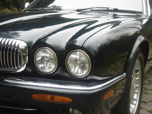

Got the usual small nicks here and there, and seems to have had some right rear damage, which was re-sprayed.
It also lost the swage line in some stage, probably during repainting (??).
Still got all original tags on all body parts though.
Those relative small issues don't make me running away as long as the base is ok, and the relative low milage makes this one interesting.
