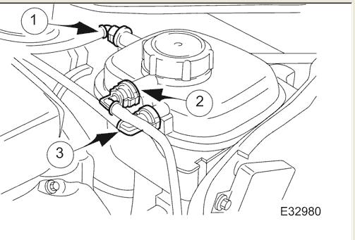

Originally Posted by jimlombardi
Hi
Here are diagrams from the Jaguar Electronic Parts Catalog and the JTIS21 Repair Shop manual:
Attachment 167907
Attachment 167908
These 3 hoses are rigid plastic and have quick fit connectors on them.
(#4 on top diagram and is #2 on bottom diagram) from expansion tank to recovery tank (part# MNC4468AD) Retail price $29.50
(#6 on top diagram and is #1 on bottom diagram) from expansion tank to Thermostrat Housing (part# MNC4582BC) Retail price $16.55
(#7 on top diagram and is #3 on bottom diagram from expansion tank to radiator (part# MNC4583CB) Retail price $22.35
Top diagram was copied from JEPC and bottom one is from JTIS21.
Try calling Nalley Jaguar - they give the forum members a 15% discount and (free ground shipping on orders over $25).
Jim Lombardi
