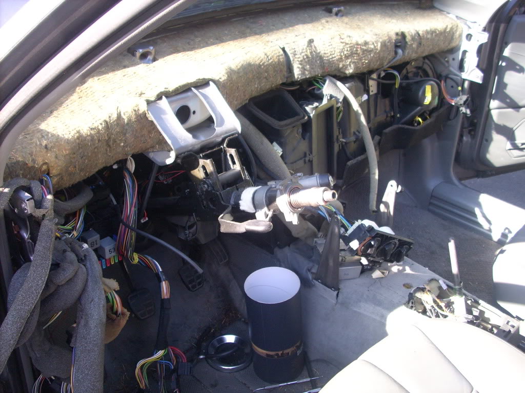

Frankly, air cooled cars have a lot to offer- witness the 3 day nightmare to replace the heater core in my Passat...
http://i336.photobucket.com/albums/n...7/DSCI0161.jpg
The Red Badge of Courage!
http://i336.photobucket.com/albums/n338/avt007/DSCI0161.jpg
Wow that looks ugly! Any rattles after you put it back together? Or the dreaded left over screw?

That picture was taken part way through the job- the heater/AC assembly is still in the car! As for BMw, my wifes 4.4 litre X5 has more power than the jag, but the sound is not as nice. Our 330CIC had a nice engine, with a 5 speed manual. The Jag just has a nicer, more comfortable, luxurious feeling than either BMW.
