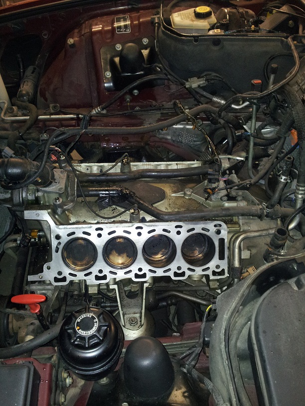

Ok so I’ve booked the car in at the local Jag specialist, they want a full week on the car,a day to take apart and examine the damage, a couple of days awaiting parts after decision to repair or replace engine has been made and acouple of days putting it back together.
It goes in on the 11th march could be sooner if they ring due to being shortof work.
I do like playing around with engines such as cleaning the throttle body and MAF sensors and replacing the discs and pads like the other weekend. These are just little maintenance jobs I wouldn’t have the organisation to take apart half the engine, then there’s knowing what to look for in terms of corroded pistons/linings, cracked chains and metal tensioners, all of which I’ll belooking at replacing when the engines undone if need be.
Just hoping if the engine is repairable the work/skimming etc doesn’t decrease engine power/BHP and it runs as sweet as it always did.
I will update on the 11th with the results of what needs doing, fingures crossed its just typical HGF work.

With head skimming there's a theoretical bump up in compression ratio, meaning more power, but it's in the tenth's of 1 HP, depends on how much material needs removing to get flat, cheaper to replace the head usually. They might have one they can just swap.
It didn't read like you'd driven it until it was roasting hot in there, it might be just gaskets, if it gets hot enough for warping the head, then valve seats usually drop leading to top end noises.
So get a price on head skimming if they say it needs it, and how they've confirmed it.
If they say bore/liner damage, take pictures and post here.
Get shots of the original timing equipment too.

When I repaired my Bentley it felt noticeably more powerful than before the failure-prior to the failure you could feel hesitation on sustained full throttle as one of the cylinders was losing combustion pressure to the cooling system.
If you get the car back & it feels worse than it did before the overhaul, then it hasn't been put back together correctly & you have cause for complaint with the garage-PROVIDED they didn't inform you beforehand that there were any problems with the Nikasil bores...
If they take the heads off, confirm the blown head gaskets & also confirm that the Nikasil block is alright with no bore corrosion, then there should be NO REASON for the engine power to be less when it's repaired.
If they give the car back to you all repaired & it's running worse than before the repair, or is down on power, then it's THEIR fault unless they SPECIFICALLY inform you of any other problem they discovered during the stripdown, overhaul & repair...

Thanks Rojie, I'm definitely going to keep the car, I’ve had her for 6 long years, coming from a man that got bored of a car within 12 months, these include TT Supras and C5 Corvette's, the Jag continues to put a smile on my face.
I found out today that my Jag should have the steel lined engine as I discovered this (see below) when I was searching though my engine with a torch. So definitely worth repairing fingers crossed I have the metal tensioners and my chain is in good condition to save on extra expenditure.
I will keep my post updated with any progress, but its going to be a long 3weeks till I get my car back

Quick update....
The work is underway nicely, the heads have been sent off to be skimmed due to slight warping, one gasket had failed on the right bank (you can see the clean piston from the pic) but the other banks gaskets wasn’t far behind it so both will be replaced.
The linings are steel so that turned out to be good news in the end and theres no corrosion on the pistons or linings.
The Jag man has suggested replacing the bolts that holds the head onto the engine, he said 5 have broke/not worth putting back in and would recommend changing the rest while doing it, unfortunately these bolts are £7.44 each and there’s 20. An expense I didn’t see coming.
He’s also recommended changing the plastic tensioners out for metal ones and while the chain and guides look ok on the surfaces he recommended replacing these also while he's at it.
He’s yet to check the water pump and pipes, he'll be doing this afternoon along with working out the final price for me.
He's very thorough in his work and always gives you the worse case scenario straight which is not a bad thing I guess.

The car is a 98 with 154k.
Ive just been on a 40 mile motorway trip and as its only 4 degrees C out there today the car never got up to its normal "half way" temperature due to the cool air hitting the engine.
Soon as I pulled off the motor way the "Low engine coolant" light came on, as I had slowed down the temp went up to half way but never overheated. I pulled over and check the levels of the coolant and they seemed fine the same level as when I did my refill a couple of days before. I turned the car off went into the shop to buy some water for my journey home just incase. Checked the level again and nearly all the water had gone???????
So I filled it up turn the car on and it started to bubble over at me, I put the cap back on and did another 40miles to get home again.
When home I check again and it had used a little but the light never came back on after topup, checked again 10 mins later after the car had been stood and its taken over half a tank again.
Any ideas whats going off? Faulty senor? Broken Pump? Head gasket?

get apressure check done and an exhaust gas sniffer test.
These systems work very well when operating normally....no second guessing!
As the head gaskets have clearly blown on the O/P's car, it's possible that when they were failing they pressurised the cooling system-blowing the coolant out until the level drops below the coolant temp sensor, which may be the reason the O/P said the temp gauge didn't rise as there was no coolant touching it.
When my Bentley blew it's head gaskets last year a similar thing happened. The combustion gasses escaping past the breached head gasket into the cooling system caused the coolant to be blown out of the expansion tank past the rad cap & down the overflow pipe, causing the coolant level to fall.
When I took the heads off, I also had a shiny piston crown on the cylinder where the head gasket had been breached-with the other 7 piston crowns looking normal with carbon deposits on them.
Your mechanic is giving good advice-with the engine dismantled it's an easier job to replace the tensioners & any other parts required-this should be a 'once in a lifetime' top-end overhaul.
I would definately use new head bolts-I once re-used head bolts on a BMW straight-six engine when refitting the head. Shortly after the repair, the engine started to give the symptoms of a blown head gasket again-but one of the head bolts had sheared flush with the block, so I had to take the head off again to remove the thread in the block.
My advice-use new head bolts!!!
Other than that, your rebuild seems to be progressing nicely without having to replace the complete engine. The top-end rebuild should give the engine a new lease of life, and together with all the work you've had done on the body of the car & the paintwork you should have one heck of a good car when it's all rebuilt.
After all the £1000's you've put into the ar on the bodywork, as well as the cost of the head gasket repairs so far, it just isn't worth the risk to re-use the old head bolts, especially as 5 have already failed. If one of your old bolts fails & shears flush with the block, then you'll have to take the complete head off again to extract the remains from the block.
Head bolts are a critical part of the engine & will ruin your day if old ones fail, so it's well worth fitting a complete new set-even if they aren't cheap...

Now he’s come back to me with a couple of prices.
First price is the minimum things will cost, this includes thefollowing:
Labour X 20 hours (in real terms he said this is more like 30)
Skimming of both heads
New engine head bolts X 20
Top tensioners X 2
Head gaskets
Total £1554
The second price includes replacement of some of the none essential items but in the long run It might make sense doing them now, this includes:
Labour X 20 hours
New engine bolts X 20
Top Tensioners X 2
Head gaskets
Bottom tensioners X ?
New Chain and guides
New Oil and filter
New Gasket for water pump
New Coolant hoses under supercharger X 2
Total: £1900 (tops)
I have chosen to go for the second option, not sure if this is the right plan for now as it’s a stupid amount of money to spend on a car that on the market today is probably only worth £3000 bearing in mind I have a £500 exhaustfitted last month. But I think it’ll bring piece of mind in the long run, the only major fault that could happen with the car next on this kind of scale after having £1900 spent is gearbox failure (touches wood).
Your opinions are always welcome….
