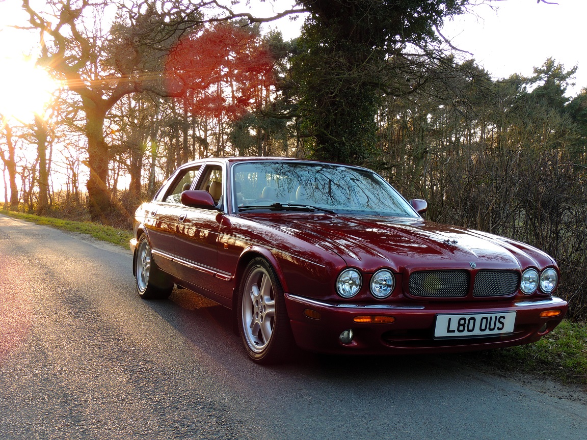

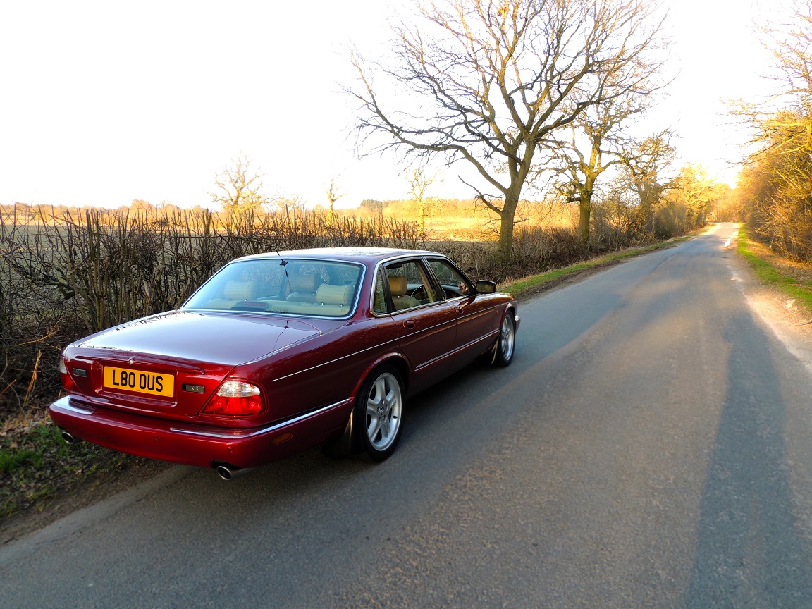

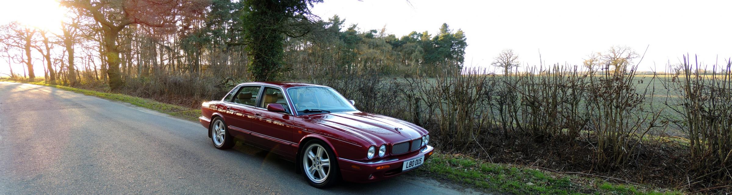

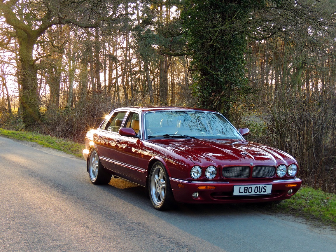

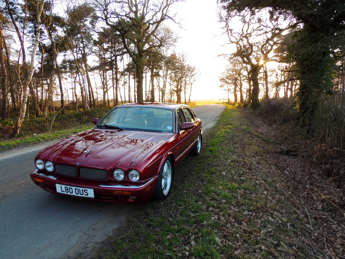

Final post in this thread, I promised some photos of the finished car back on the road and here we are (for any-one thats interested), with a nice english spring sunset to boot.
Please to say all is well with the car running sweet as always. the temp gauge still hardly moves from 1/4 way but I'll investigate this soon.
Enjoy.....

Stunning photos of a superb looking car....you can be justly proud ;o))
Thanks for sharing.
