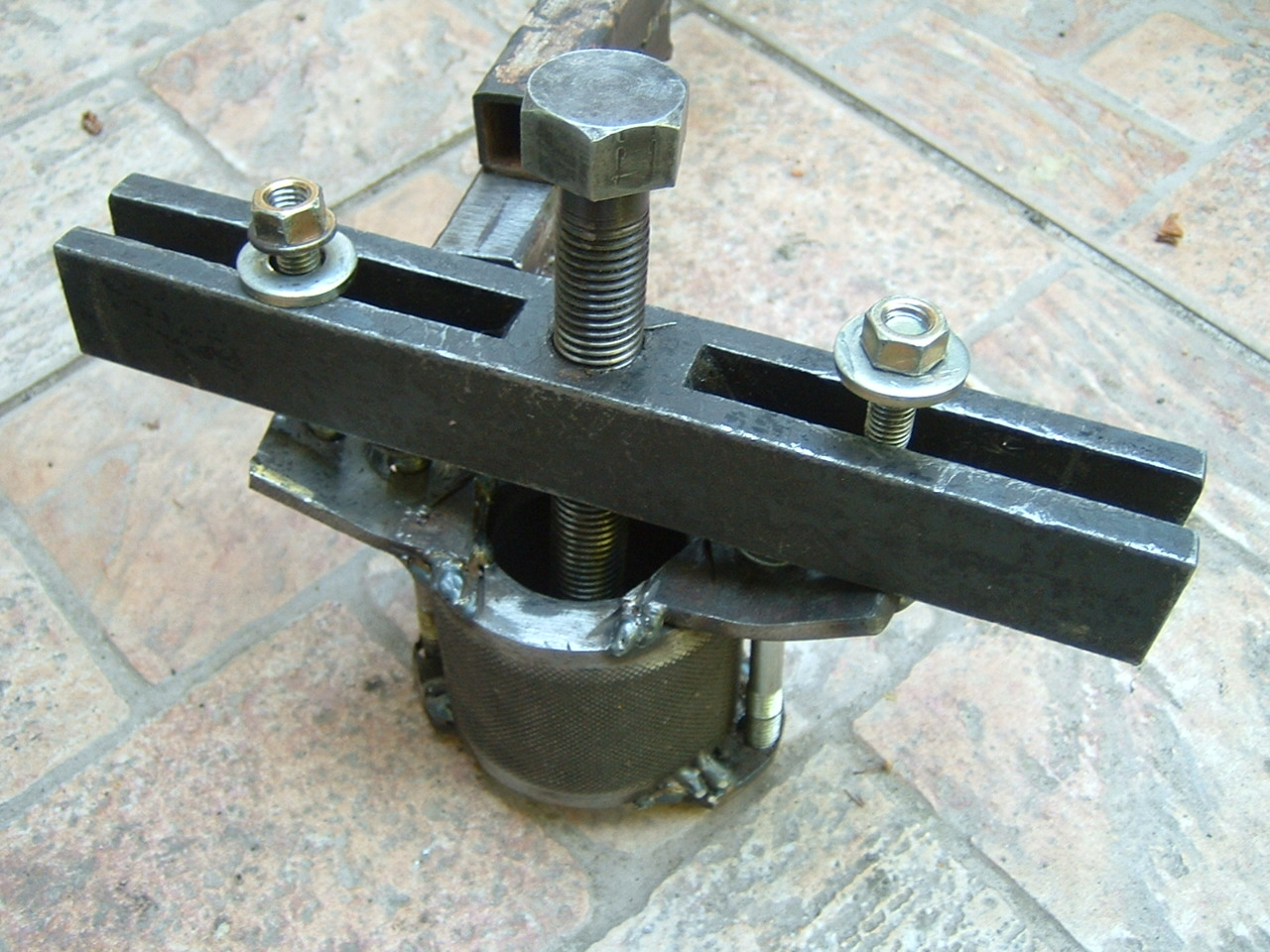

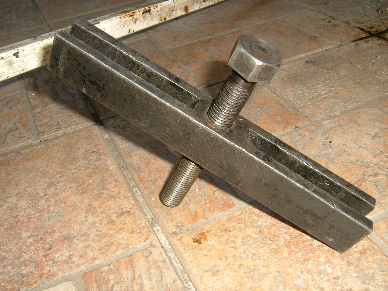

I made a locking-removal tool, as you see on the pics. I had a spare pulley, so it helped me to get the right sizes. It is ugly but functional. The two inner screws lock the tool on the pulley, and the outer longer ones for pulling off the pulley after the crankshaft screw was removed. The pulling off tools are not on the pictures.
Attached Thumbnails Crank pulley locking tool-dscf0019.jpg   Crank pulley locking tool-dscf0020.jpg

How does the pulling off tool fit onto this setup on the 2 outer bolts?

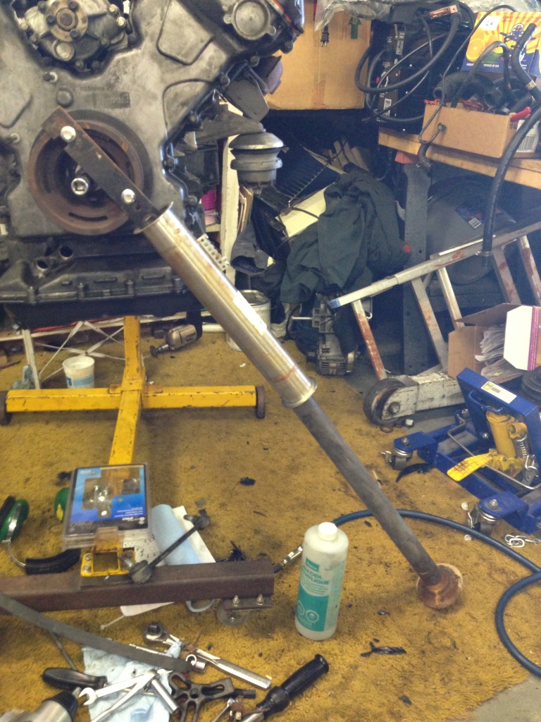

In the picture below, you can see two curved slots. I used a metal bar, bolts through those slots, and the nuts were placed in the gap between the pulleys. Cheap, dead simple, and very effective. A standard puller was purchased from a local parts store. Be careful, the bolts you need are metric. I do not know if the XJ8 pulley has the same slots, though.
[IMG][/IMG]

I hope this helps:
1. first pic is about the pull off tool
2. the back of the pulley, the distance between the two threaded hole is 74-75 mm.
3. you see that I have a modded crankshaft pulley screw that connects to the pull off tool's centre big screw.
4. how the pull off tool screwed to my crankshaft stopper tool. A closer look and you will see that it was bended by the pulling off force.
5. all of them in the pulley.
Don't forget, it is an XJR pulley, but I think the inner pulley diameters are the same with the xj8.
Attached Thumbnails Crank pulley locking tool-dscf0019.jpg   Crank pulley locking tool-dscf0020.jpg   Crank pulley locking tool-dscf0021.jpg   Crank pulley locking tool-dscf0022.jpg   Crank pulley locking tool-dscf0023.jpg

Steve
youre a genius buddy.. You need a patent for that for sure!!
I estimate the distance would be 7.3 cm from center to center ...one end of the measure looks to long in the picture so I adjust to 7.3, unless it is an optical thing.
I will fabricate this up soon...
Patent licensce number 000001...!!
Best regards
Peter

A couple points about the steel bar idea- as you can see the engine was out of the car. An impact gun removed the bolt easily and an everyday puller removed the pulley, BUT, I had the room to tighten the bolt and swing a big hammer to pop the pulley loose. If you're doing this in the car, that could be an issue.
As for the bar, the bolts have to be just the right length or adjusted with washers so that the bolt does not protrude through the nuts into the aft pulley.

Thanks, You made my day! Anyway, i think it is not so big thing.
It is better if you have playing area (7,3-7,5 cm), because then easier to screw the tool to the pulley, if the engine is in the car. Not easy to find the threaded hole with the screws, but that helps, that the xj8 has only the inner big pulley, so you have more place in front of the pulley.
Good luck for the work!
