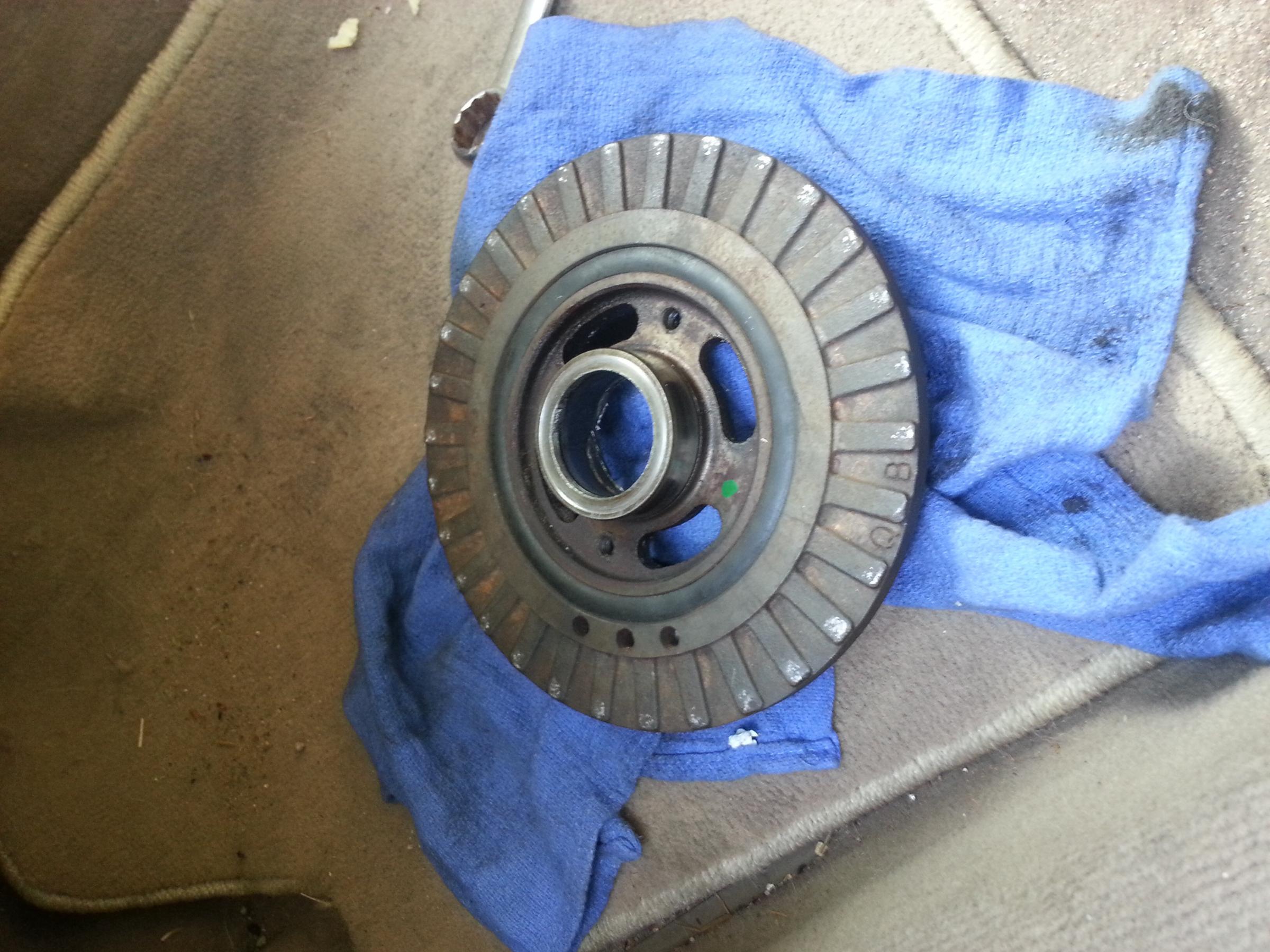

Is theis crankshaft pulley missing a part?
This is from a 2000 jaguar Vanden plas

It sure looks like it to me, but i am used to what the supercharged unit looks like .
Why do you ask?

Did it fall off? the marks around the outer edge of the face give that impression it moved.
You're probably missing a 'cone' or tapered collet that fits inside the pulley centre hole.

The serpentine belt came off. Now the crankshaft pulley will not stay tight. The screw spins but pulley doesn't.

I agree with Sean.... You are missing the split cone bush which tightens the pulley up
