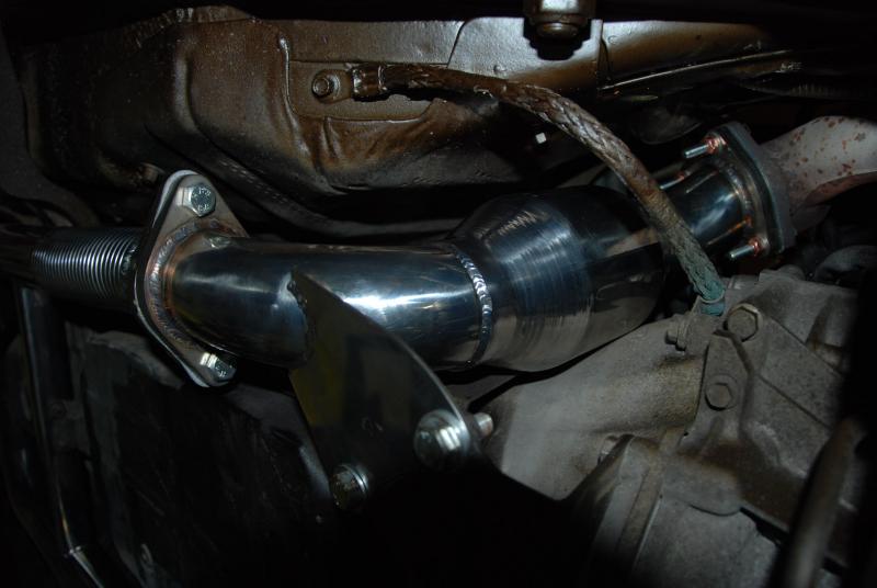

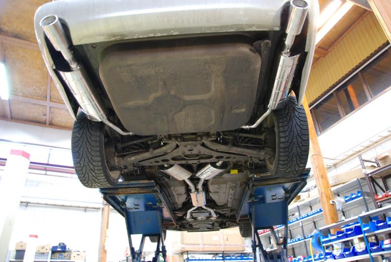

Here my exhaust system from the manifolds.
Attached Thumbnails Custom Exhaust System-dsc_0565.jpg   Custom Exhaust System-dsc_0573.jpg
