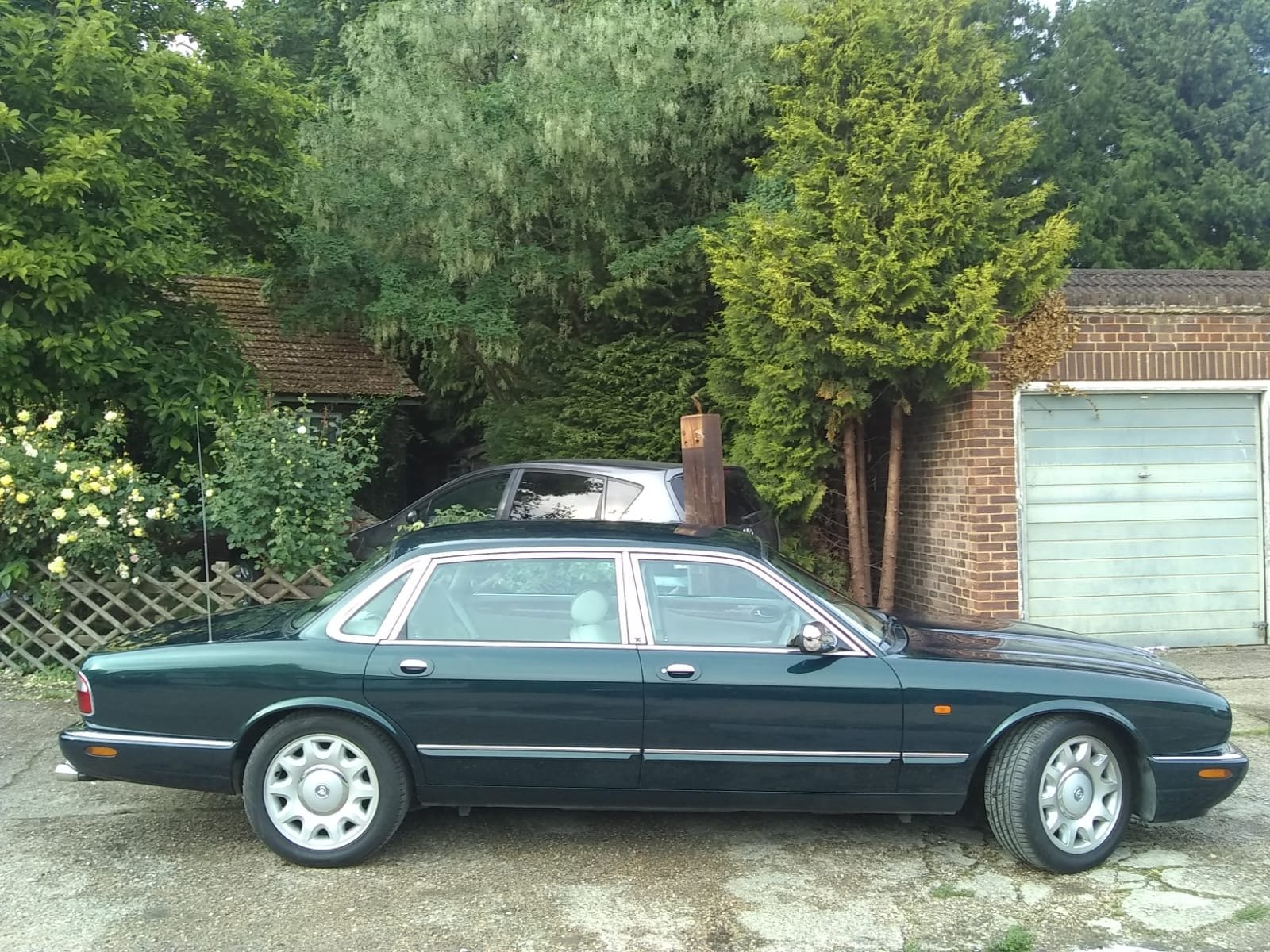

Green Goddess, Daimler Super V8, 2000, 4L X308

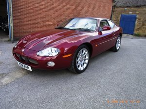

Carnival Red XKR, 2002, 4L X308 Coupe soon to go to my brother.
